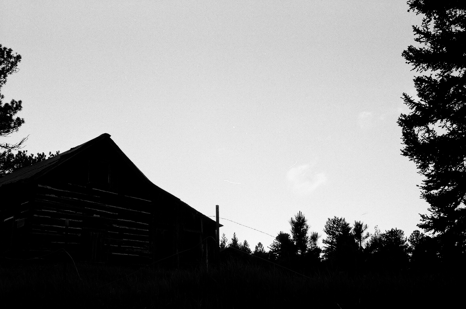

I just got a roll of 35mm HP5 processed from a local shop. When I reviewed the scanned images I noticed strange dark lines on them. They are not scratches. The film is not expired and has not been heated up so I thought I would post on here to see if anyone knows what happened. Not all of the exposures had the lines however. Here are some of the photos:

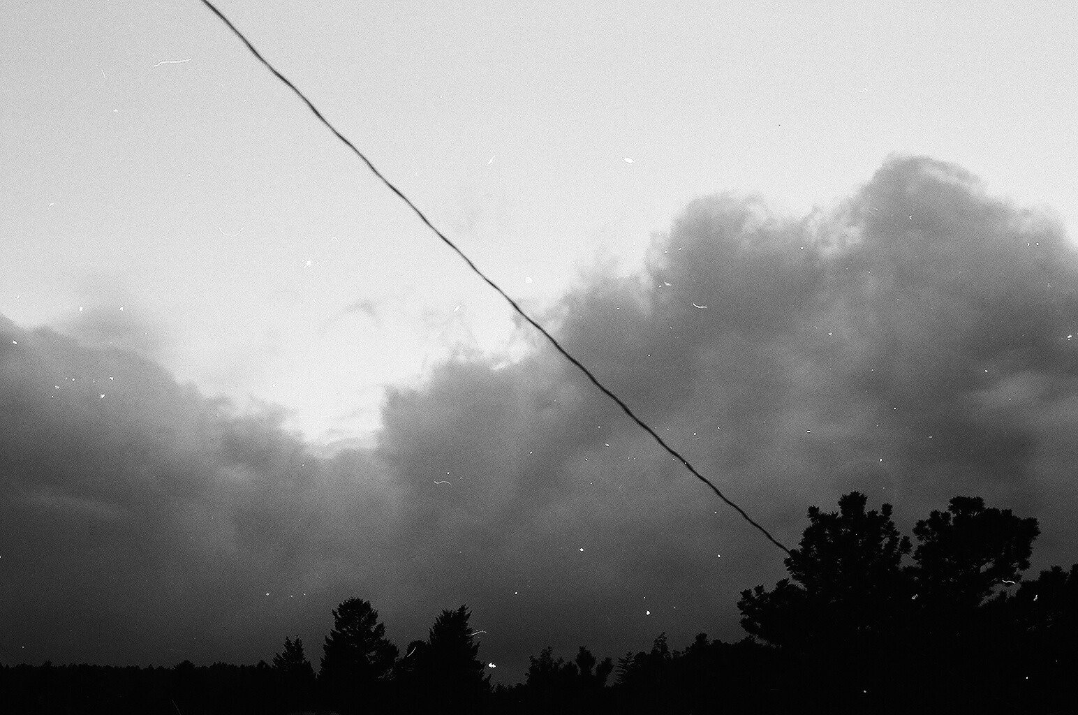

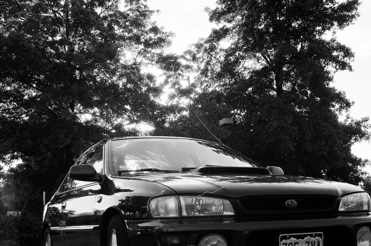

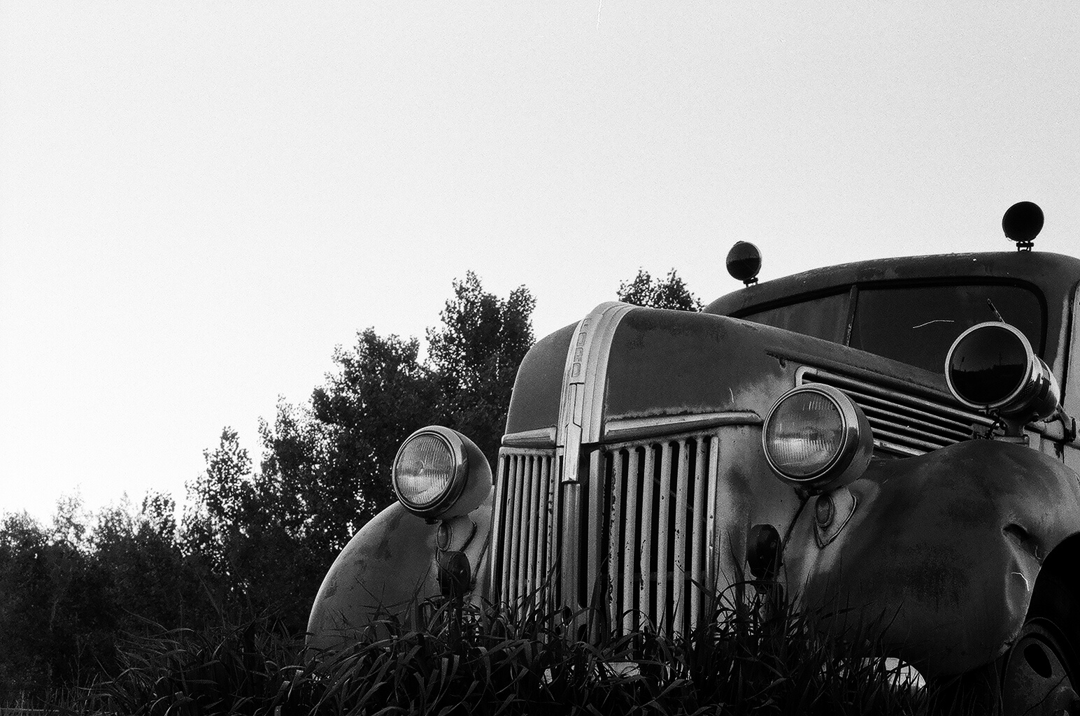

#1 - is the black line diagonally across the whole thing what you're talking about, or a powerline? Nothing else wrong there but what looks like dust, same with #3 #4, and #6. Could also be emulsion scratches, look at them closely in good light to see.

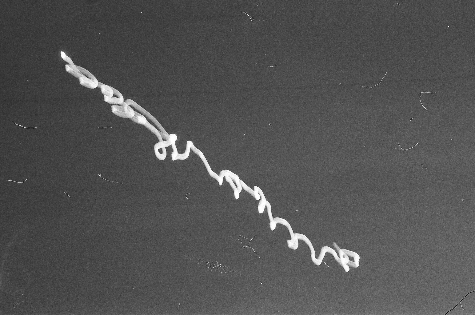

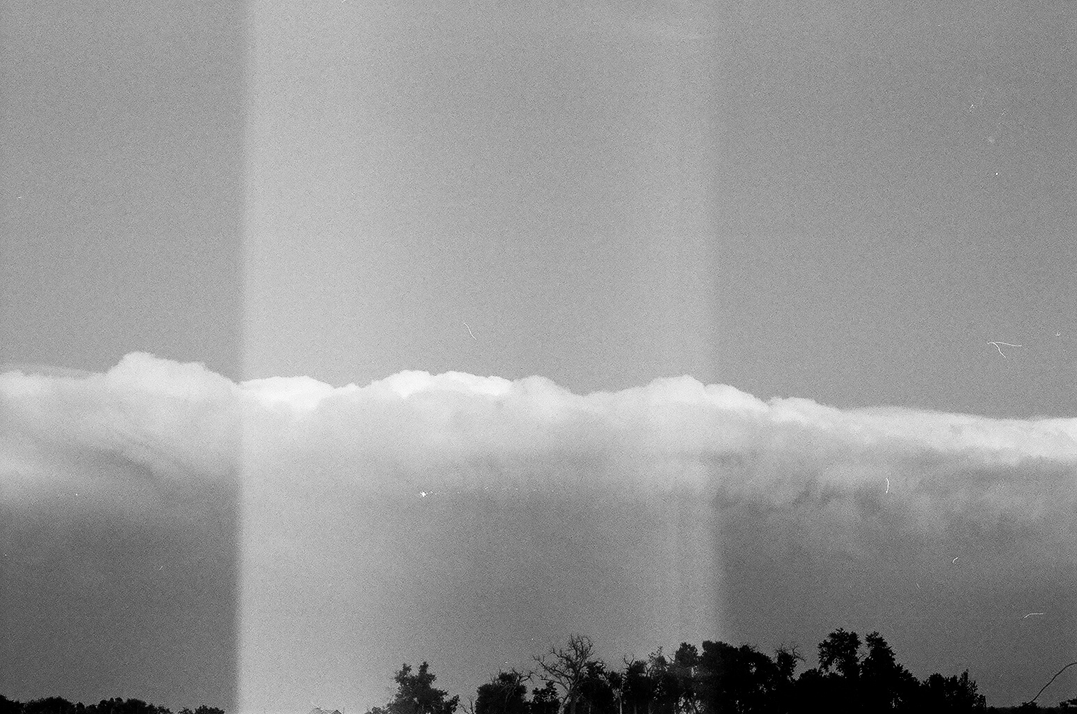

#2 looks like a long eposure of a point light source, and moved around a lot. There are also darkish lines horizontally across, is that the problem? I see a similar thing on #5. I've had that happen on my v750 with the betterscanning wetmount holder, if the holder is not aligned properly the light gets confused and you can scan weird dark/bright lines into it. Or they could also be dev issues, not agitated properly and/or insufficient developer.

The dark lines all the way across the image are power lines. I did pay for them to get scanned (and developed, since school has been out I have had no were to develop my B&W photos). The lines seem to be on the negative. I would be pissed if this happened because they developed it wrong. Thanks for the help!

My phone is small and real difficult to view thumbnails with but the one from bottom thumbnail with the top to bottom lighter column could be a shutter problem.
Please review cause if you have other frames with similar symptoms it is look at camera time.

The light column is actually just a light leak. I replaced the seals but didn't in a spot so every so often I will get an image like so. Thanks for the concern though, it's appreciated.
Please confirm the column extends into the sprocket holes.
The lines are on the film. And if you look at image 2 and 5 they both have the same line in the bottom right.
All your images have that dark line on them, you just don't see it in the ones with a dark lower right corner. It is a hair or fibre in your camera in front of the shutter, or just behind it in front of the film plane. Should be easy to remove. The random white lines are debris - the scans were obviously done by a beatnik who knows nothing about dust blowers.

The black line at bottom right is indeed a hair in the gate.
