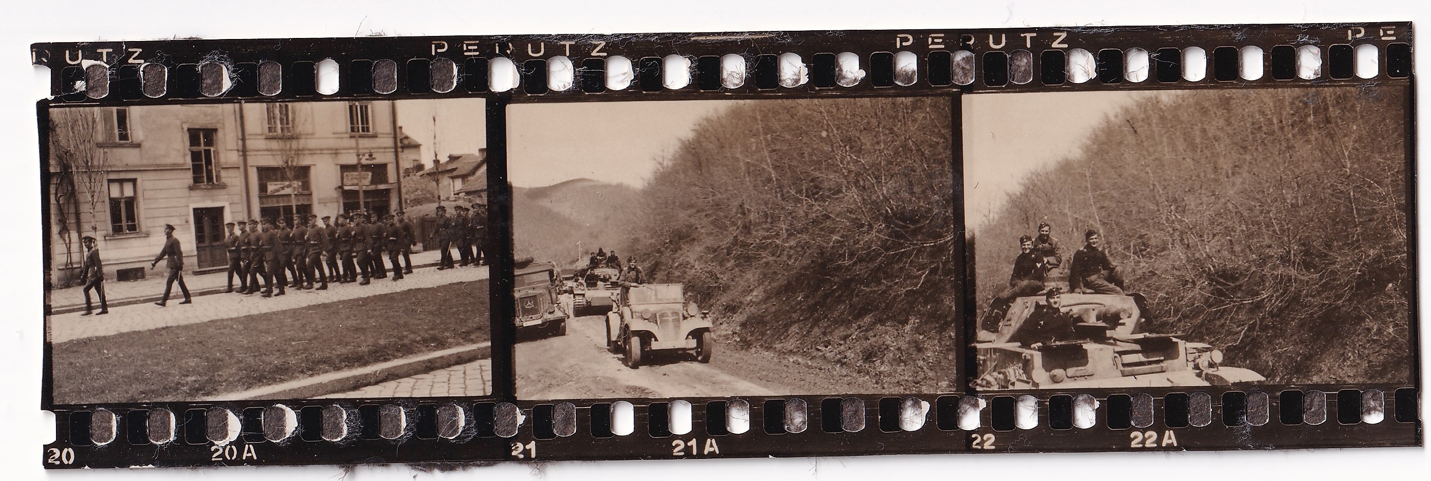

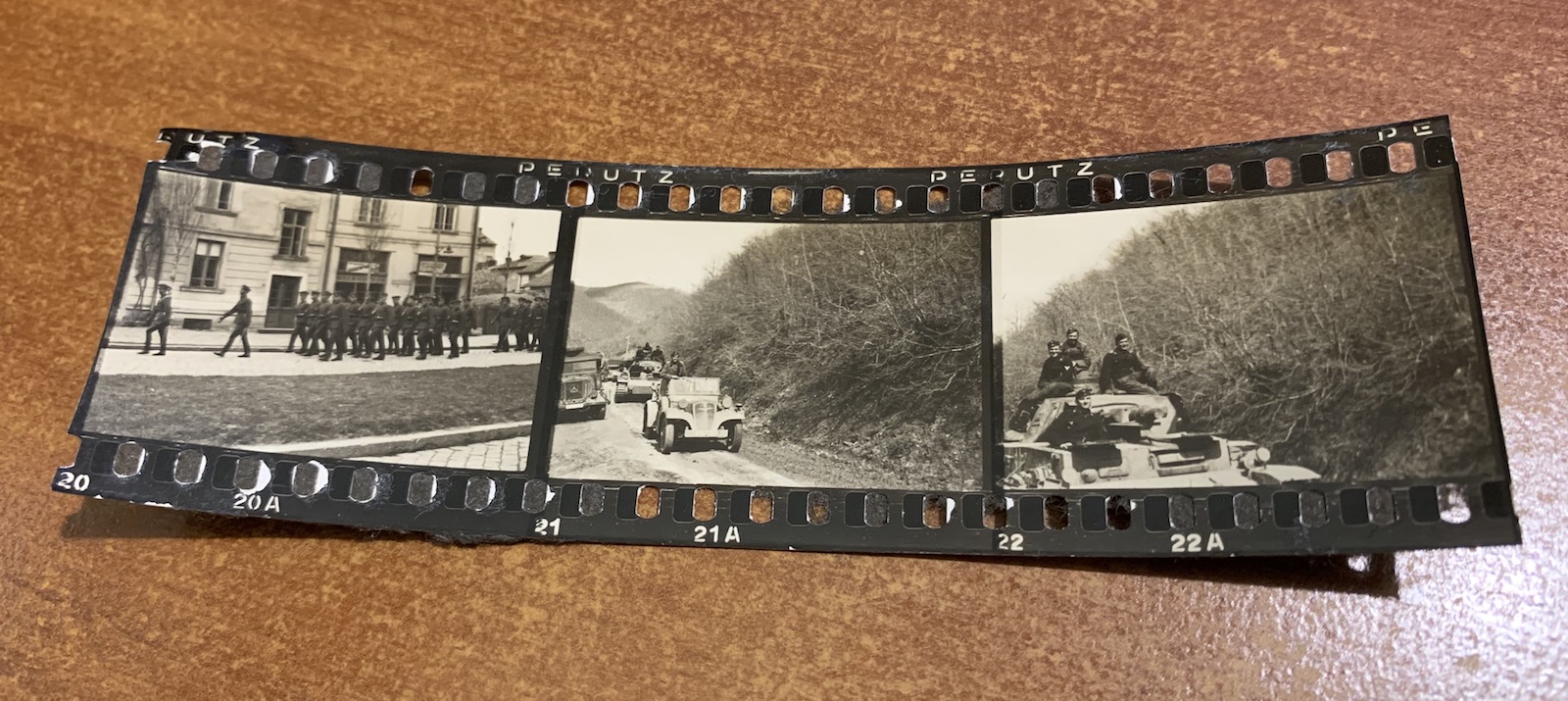

Hello to all,
I'd like some advice since I'm far away for being an expert in these kinds of stuff. Recently, I have found in some old album, lots of 35mm film-like strips, but positive and non transparent. They are like small photos, in 35mm look like paper.
Here it is:
Does anybody have any idea what exactly this is, and if and how I can make something out of it? Scan it that is.
Thanks in advance.
If they are 35mm high, they appear to be contact strips made by contact printing negatives onto photo paper. These were often made to evaluate how an enlargement might look, for a publication photo editor's use, for cataloging, or other uses. They could be scanned for further use, although most flatbed scanners do a poor job of this. They could also be copied with a camera for making negatives or digital files for further use. I can't account for the sprocket holes on your sample.
Thanks a lot for your answer. Plustek OpticFilm 8200i also doesn't seem to do for the job. It doesn't "see" it at all. I'll search - i want to find out exactly what i need. Thanks again.
Here photo paper was available as 35mm double-perforated long rolls until the 70's. (Listed, but I never came it across.)
I think you can do that with a flat bed scanner but not a dedicated film scanner. Or you can just fake the outer part of the pictures.
Well I think I misunderstood you. I don't think you will get much better images than you already did by taking the picture of it.
Unfortunately, because they're positives, you're not going to get much detail, or blow it up very much. Positives will have to be scanned on a flatbed scanner, and the resolution will probably have to be down around 200 or 300 PPI. At high resolutions the image will start to break apart. They sure are cool. Never saw anything like this.
What was the purpose for it?

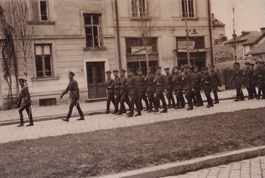

THe photos seemingly show german troops during WWII, the location though is not clear, the architecture might be helpful.
The purpose was to make in a cheap manner small positive. Best in a way like copying cine films: in contact. Or optically. For the latter one could use something like the Meopta repro-cassette, but now used on the baseboard, turned upwards.
Such small positive prints were re-introduced with Polaroid's miniature instant-camera/film quite some years ago
However the soldiers in the last photos are no Germans.
The US Army had a contact printing machine which was used (WWII) in a portable field lab for contacting 9" wide aerial film. The developed film (negs, on 9" rolls, uncut, were shot in cameras suspended below the wing) They were contacted in a continuous roll fed (paper) printer. The film and paper came together under rollers, were held in contact while both traveled over a slit of light, exposure controlled by the brightness and speed of travel. As the paper came out it was developed in roll to roll developing tanks (kind of like manual motion picture tanks), you constantly roll the paper back and forth to develop. Not for fine art application, for sure. But the final prints were cut up and assembled to make "maps". The images were shot with overlap, like a pan strip. then pieced together, like an early GoogleMap thing.
The example in the OP's post might have been a 35mm version. Very fast way to contact many many images quickly. Long explanation, but I thought someone might find it interesting).
I typically scan prints on my Epson v800 at 1200 PPI, and get quite usable results. If that's a contact print, there should be a fair amount of detail available.

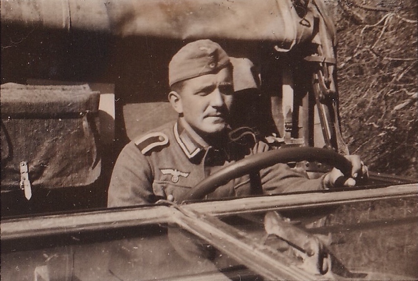

@grat unfortunately it seems that there isn't. This is another sample from the same album using my Canon Lide 400 at 600 dpi. That's the best it can be i'm afraid.

I notice that the punched "sprocket holes" do not line up with the images of the holes in the film. Perhaps the word for Puppet at the top is a clue?
Bob
To me, it looks like the frames in the strip are not aligned. So, we have mis-aligned frames, after processing punched holes and the work puppet at the top.
Something somebody put together for some obscure reason?
Bob
This only indicates that no (automated) copying took place as in cine printing, where two strips run togther over same sprocket wheel or drum.
There is no word "Puppet", but PERUTZ a major german film manufacturer.
I stand corrected. I googled several times and the word translated to Puppet. So I guessed. I think Puppet is a better name. :<)
