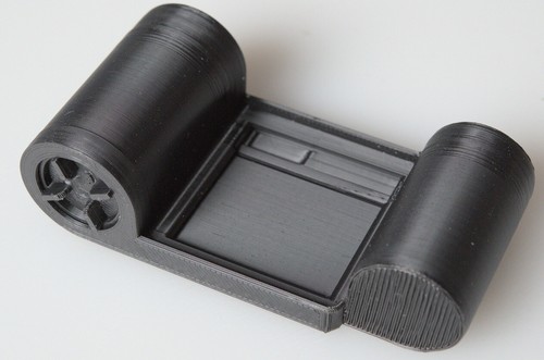

You could always just load your own 126 cartridge with your choice of 135 film .

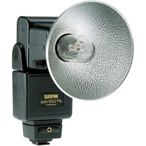

I've recently bought a Sunpak 120J TTL bare bulb flash to use with my 135 , 120 and large format cameras .
It's a TTL/ Auto / manual flash with an assortment of shoe adapter modules to work with various brand cameras .
Because it's a bare bulb , with a large reflector, the resulting images are a out the same as with flash bulbs , and an improvement over magic cubes ( though I have those too !)
They give a nicer lighting than regular flash guns .
I got mine off eBay UK for £120 , I already have several modules that I use with the two ring flashes .

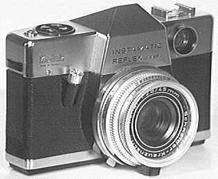

There is also the Instamatic Reflex - of the same era:
https://kodak.3106.net/index.php?p=207&cam=1213
