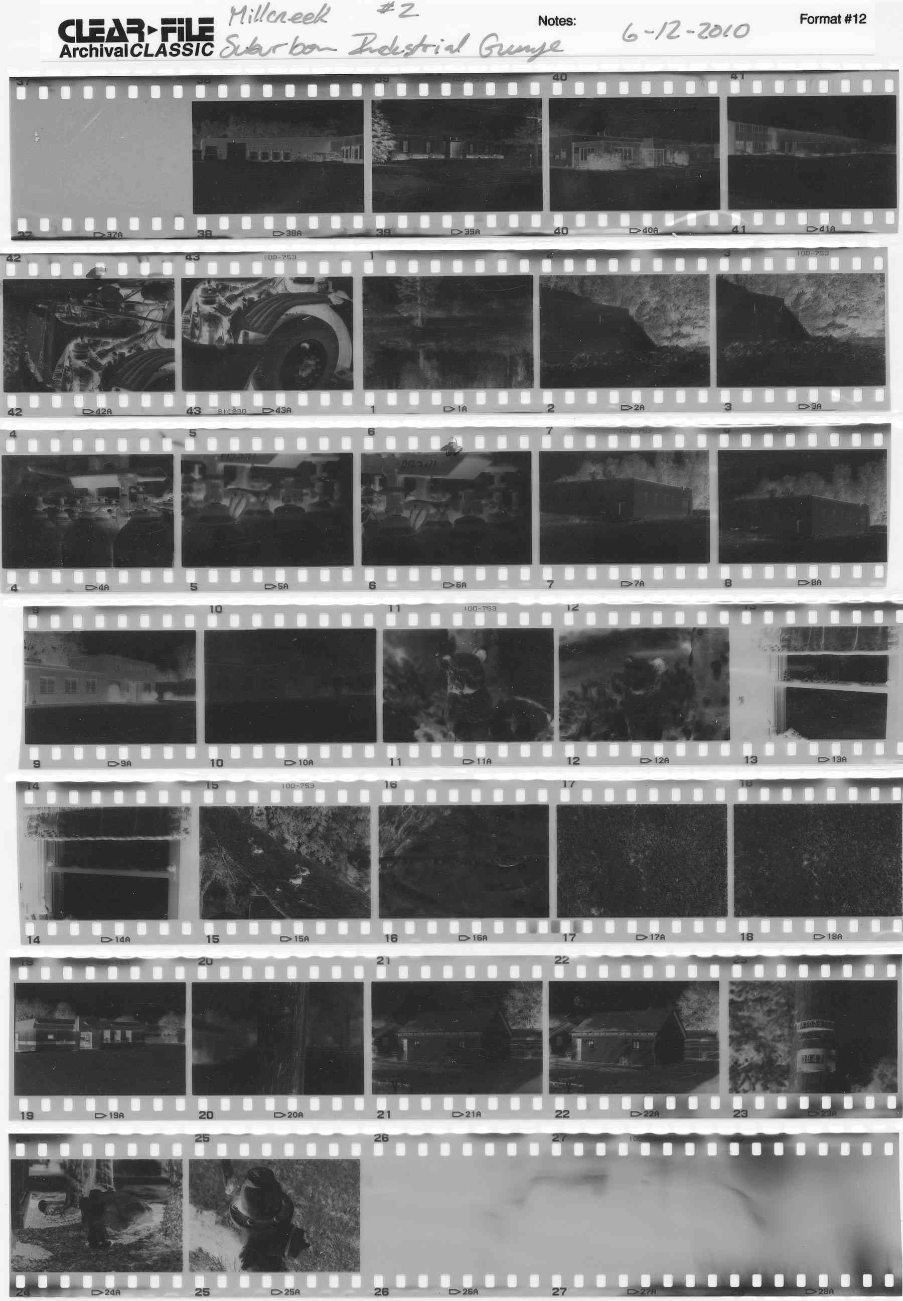

I would sure like to know what exactly is going on here. Is the fogging continuous and does it start at the very edge, does fog bloom around the sprocket holes (of course there is no film in the actual holes), run the entire length of the roll, along both the top and bottom edges, or just one?
Attached image: A scan of one roll of negs in question.
I have other rolls from the very same reel of bulk film, from the very same loader, shot, one after another in the very same camera. One roll does it, the other does not.

Mine look about the same. I haven't been able to match it with the cassettes since most of mine do it actually. It can't be the bulk loader because I don't use a bulk loader.

Thanks for posting the scan, Randy S. That's a significant amount of fogging at the end of your roll. What loader are you using?

Watson. But I do not think it is the loader because the next roll of film I loaded did not have that problem.
I am not 100% sure but I can do a test.
The next roll I load will be in a brand new, unused cart.
Edit: I'll check to be sure the top loading door of the Watson isn't coming open a crack. I can use a piece of tape around the edges if I suspect it.
This is exactly what mine does too, and I have been trying to figure out if it is the reloadable cassettes (Freestyle brand, not DX coded) that are bad or the something not OK in the loader (Watson).
The gaps in the fogging on the edges makes me suspect that it is not the loader - I would expect a much larger stretch to get fogged it that were the case. I don't have any significant pauses when loading the film, so I cannot explain the gaps.
In my case the fogging only happens in the edges of the last (innermost in the cassette) 5-6 frames. Even among these, the innermost one is worst. But I cannot understand how the core of the cassette could be affected by a light leak.

I'm pretty anal about winding film at a consistent speed. (It's an occupational hazard of being a projectionist. :wink: )
Whether I am winding film through the bulk loader or rewinding film in the camera, I always use the same pace; about 1 crank per second. Therefore, I am inclined to believe that the way I wind hasn't got anything to do with it. I might be wrong about that so, on the next few times I load film, I will double check my film loading and winding practice to be sure.
Further, it looks like the pattern of marks on the edges of the film is consistent. They look like they are a similar shape and they all appear to be similarly spaced. It looks like it would be possible to wind the film in a circle and have all the marks come out on the same place along the diameter.
It only takes 1/1000 of a second to fog the film. If one little bit of light leaked in for just one millisecond, those marks could occur at any time. That's what's making them so hard to figure out in my mind.

What I was wondering about is the smoke-like density on the tail end of the roll. It may have been mentioned, but how was this film processed? Bromide drag or something similar?
There is also one section on the margin where the pattern of the overlaying sprocket holes has imprinted on the space between frames 16/17. Are we sure that there is not a light leak in the CAMERA?

Developed in a plastic tank with XTOL (straight) agitated by inversion, not by turning the spindle.
The same camera has produced clean negatives before and after this one was shot.
I have another camera and have had the same problem with it. Again, some rolls are clean and some are fogged.
The leather cases are always on the cameras when they are being used. The only time the cases are off is when they are being loaded or unloaded.
Just a thought... If I can match the sprocket hole imprints to another spot on the film I might be able to determine what position the film was in when it got hit with light.

Pattern of overlaying sprocket holes? That suggests to me that it happened when the film was out of the camera, perhaps when loading the reels.

I did a little bit of analysis on the patterns of flash marks on the edges of the film.
Look at the sprocket hole imprints @ Fr-17. (Actually 1/2 way between.)
It appears they match up with the flash marks @ Fr-22A.
Take a ruler and measure the distance. It comes out to 20.7 cm. Divide by pi. The diameter of the roll at the time of the flash that fogged the film would have been 6.58 cm. (2.59 in.)
Now, if the film was inside the cartridge at the time it could not have been rolled into a circle (spiral) 2-1/2 inches in diameter. Right?
That could be the diameter of a developing reel.
It could also be the diameter of a roll of bulk film if it was half way used up.
(Yes, I understand this measurement is not exact, especially if the film was spiraled on a developing reel because the diameter of each lap around the reel is different. It's still a good estimation.)
I feel pretty confident that it didn't happen inside the Watson loader.
I'm not 100% sure. If I was, wouldn't be asking about this problem. Would I? :wink:
The next time I load film I will double check and triple check my procedure to see what's happening there.

I suspect that at least in my case the fogging happens after I load the film onto the developing reel. I am using a Paterson 2 reel tank. Here are my reasons:
(a) The marks are periodic. So the film is more likely to have been in a rolled state when the fogging happens.
(b) The marks only occur in the innermost (i.e., last frames to have been shot) few frames. But the centers of the reloadable canisters are among its most light-tight parts (the central post has a flange at both ends, making it more likely for the outermost parts to fog, if at all). I originalyl suspected the film-leader retriver - but that would affect _all_ frames, not just the innermost few.
(c) It happens with both camera bodies I have, but not on every roll. So the light leak is neither in the cameras, nor in the loader.
It is possible that I have been leaving the Paterson tanks sitting in bright light (an overhead bulb) for too long without keeping the lid on, and the light trap isn't perfect, especially with light coming directly from above?
