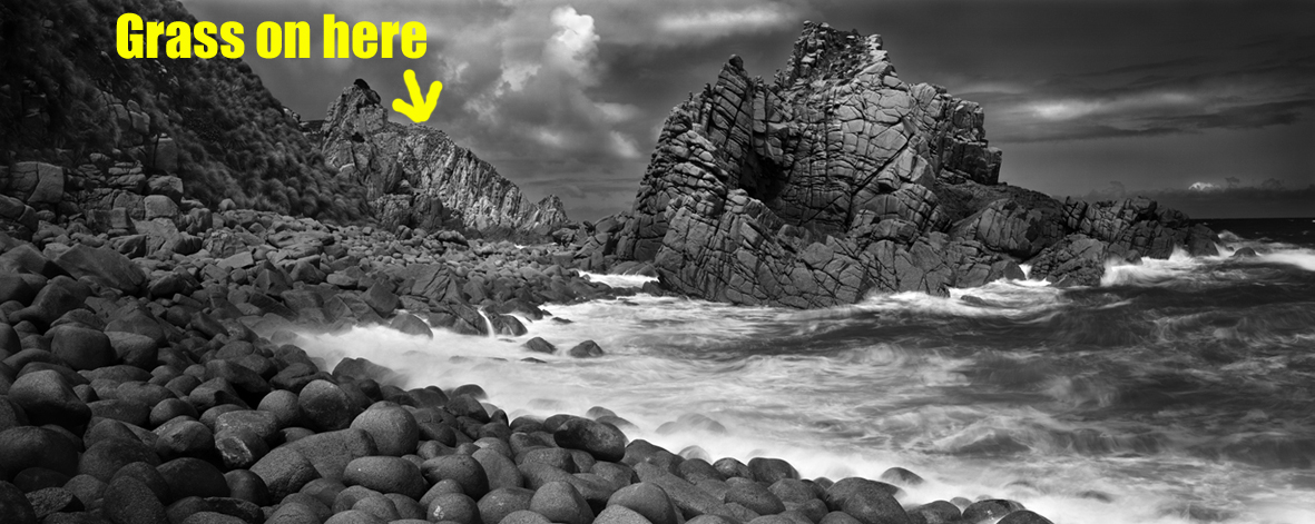

I've got the 355mm G Claron on my 7x17 and can't run out of image. Not the the Korona has huge movements. However, once I get around to finishing my DIY 7x17, I'll try it on that. It has a couple more inches of rise.
I can say, though, that the images that it makes are breathtakingly sharp. I am constantly amazed at the detail. On the attached image, I can pick up blades of grass on the rear group of rocks. Amazing.
No quarrel at all on the sharpness if you're not enlarging, but I'm not sure about the blades of grass. I have some 35mm E6 shots of seals a good distance away taken with a Questar 700 (I know, not LF) in which I can see their whiskers. Same situation as your grass, except that I know what I'm seeing is groups of whiskers. The Q700 can't separate the individual whiskers. I get the same effect with distant trees with all the formats I shoot. If the twigs are far enough apart they can be seen in the negs, if they're too close together they can't be separated. They look sharp, though.
I'll try to scan the section that I'm referring to. I took another shot with it of the old piers of a pier (run with it). I can make out the lost fishing line on some of the piers at considerable distance.
