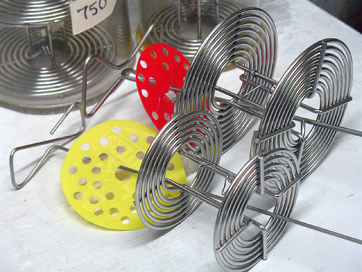

If your room is dark enough to load the reels, it's dark enough to develop using clear acrylic tanks that you can make yourself...
Reinhold
To add to my post #9 about using clear dip & dunk tanks in the darkroom; good re-mixing of the chemistry during agitation is important to prevent stratification in a fluid column.
To prevent it, I punch holes in a plastic can lid and put it at the bottom of the reels.
With each lift the fluid column is totally re-mixed, completely eliminating the possibility of "bromide drag" (a source of uneven development).
Reinhold
