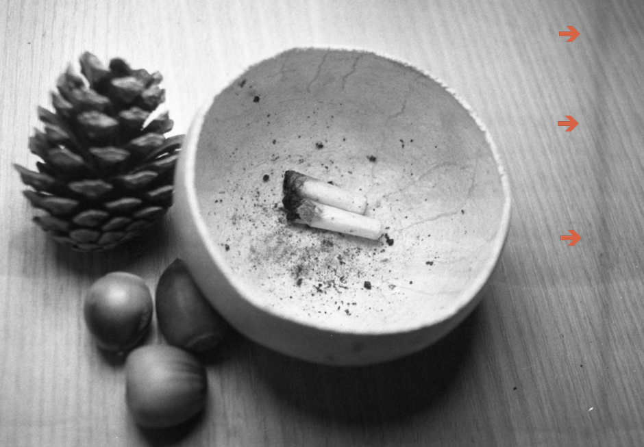

Hello! Ive searched online and read the sticky post regarding development, but I still can identify and get rid of 3 major issues with my developing process in B&W,
I feel that I have color developing under control so Im not really sure why Im messing up B&W.
Process:
30 sec constant agitation (1st), then 10 every minute for 10 seconds
24 C`

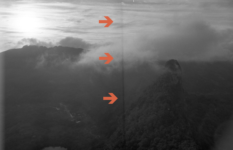

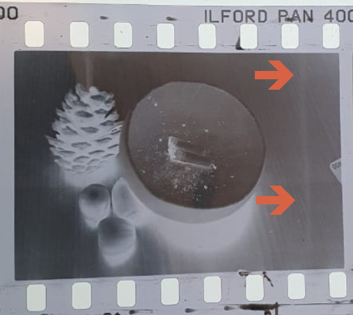

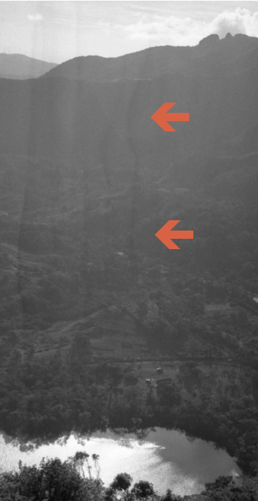

1st problem:
Random straight lines
across negative. I use the same camera to shoot color and I dont have this issue. I dont think its a lightleak.

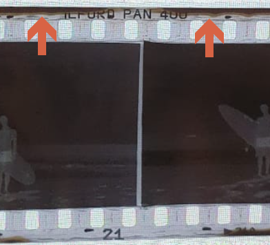

- Dirty sprocket holes. Ive notices that after reusing the solution its getting increasingly dirty (after the 5th time)

Those crosswise stripes aren't light leaks -- they're lower density (light on the negative, dark on the print), suggesting they're a development issue. Bromide drag can do that. You could also see it from a horizontally traveling focal plane shutter that has a speed control issue (they'd be present in the color negs, too, but likely less visible).. The wobbly stains are probably flow marks from drying -- rewashing the negatives in distilled water and using only the correct amount of wetting agent before hanging will resolve that. The "dirty" edges are incompletely fixed, probably because your fixer volume is dropping off after reusing the solution several times.
Are these problems all apparent on the same film and if so on how many of the negatives?. Sounds like a bit of an imposition but it may save time in the long run if you were to give us more details about your whole process. The alternative is that each of us and we are legion will fire a sentence of a possible cause which you then eliminate by a quick reply. This can often muddy the waters and actually slow down the objective which is finding a cause and a solution
All I can say as of now is that your agitation regime suggests to me that bromide drag can be eliminated, unless others can state that 30 secs at the start and then the Ilford 10 secs for every minute can somehow result in bromide drag
Thanks
pentaxuser
1. Only one or two lines per neg, and always in the same place: looks like an unevenly running horizontal shutter to me. Confirmation would be if this isn't visible or much less when you use a slow shutter speed (or different camera). Would be falsified if the camera doesn't have a horizontal fp (Leica type) shutter.
2. Probably need to work out something with your final wash. For me, only demin water AND wetting agent works. Could maybe also result from no agitation during fixing?
3. Light leak and/or effect of the reel blocking fixer from the film. It's just the sprocket area...
Do you use the same system/tanks for doing color? Is it a Jobo type roller setup? If yes, then I'd agree with bromide drag.

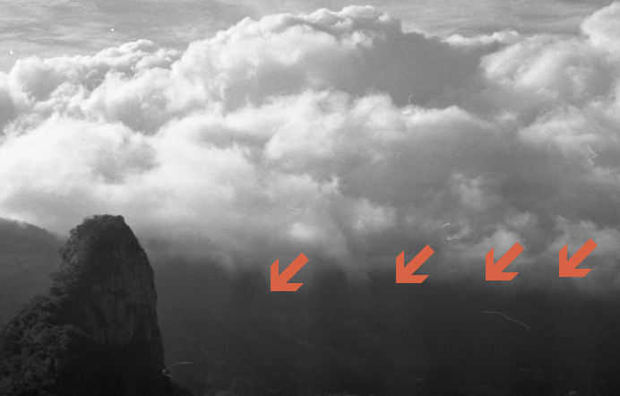

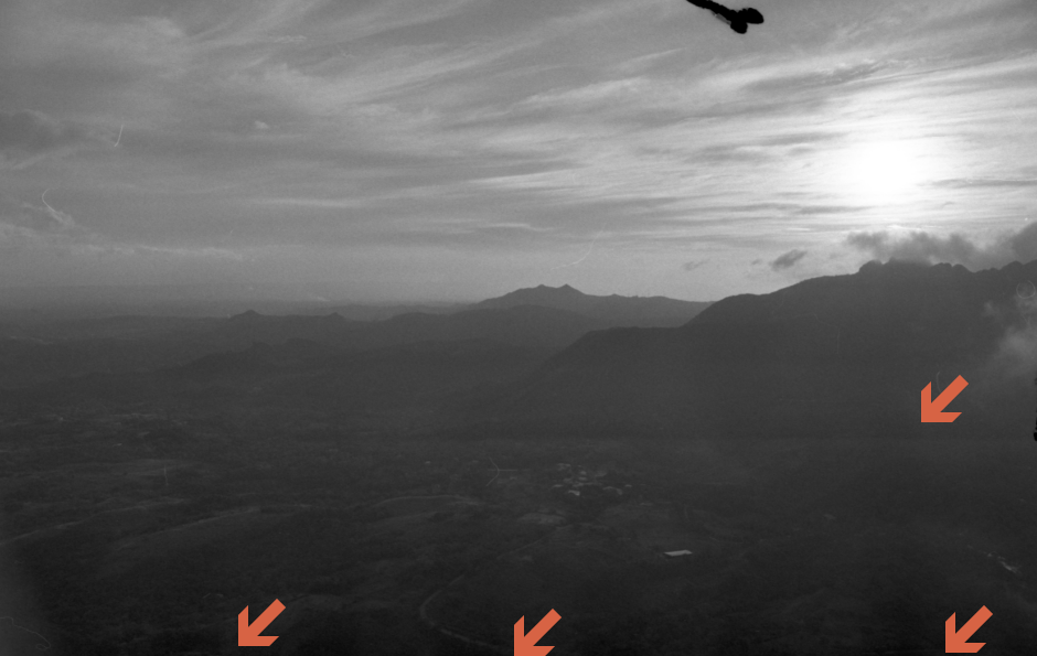

1st problem:
View attachment 263172 View attachment 263171
View attachment 263174 View attachment 263173

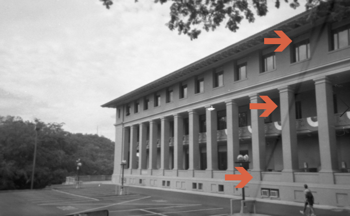

2rd problem
Vertical wobbly water
(?) stains
View attachment 263175 View attachment 263176

The 3rd problem depends on the film sticking to the reel tank grooves and can be prevented during fixing. this way: after having fixed your film with the tank lid closed, for half the required time, minimum 2 minutes, open the lid and remove the cog, then turn upside down the reel in the fixer for the other half, agitating sporadically.
#1 looks more shutter related than a development artifact to me. But it's hard to tell.
#2 is most likely indeed water runoff, lack of use or improper use of a wetting agent or something along those lines.
#3 is usually caused by the emulsion of the film remaining in contact with the reels during processing. I wouldn't worry about it too much. It looks too sharply defined to be due to insufficient fixer volume.
Another issue is the dark marks between the sprocket holes, which suggests excessive pressure on the film during transportation. I'd have a close look at this camera and see if it needs some cleaning or even repair.
Thank you very much! Indeed I use the same equipment as for color negatives (same camera, tank, water, etc), so it should rule out equiment issues. As for the chemicals Im using Ilpford monobath Df96 and following the instructions to the letter, I even different temperatures (+2C) without visible differences on the rolls.
1. In one of the pictures I was trying to shoot with a lower shutter speed (I rarely use this setting) due to low light,
but the picture of the cig butts the shutter was at normal speed and no color roll that I have develop shows this. Im more inclined to think its a developing issue.

Regarding the straight vertical lines, it does seem to be a shutter problem....
Actually the film with the lines its from a small camera that I use sometimes for hikes, Ill give it a clean to see if I achive any difference (theres not much tech service where I live).
its an old Halina Vision, if you guys have any suggestions Ill be happy to try them, otherwise Ill report back to share results as soon as I develop another roll from this camera.
Thank you!
I think the Halina has some sort of central shutter. That can't cause lines. Are you sure of the camera? I would have guessed internal reflections if the stripes were brighter, but they're dark; not sure if it's likely that light was reflected everywhere except these thin lines.

0. Dirty or dark stains on sprocket holes. This should be fixed increasing agitation to 5 seconds every half minute according to @Donald and @Andrew

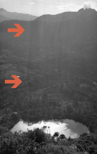

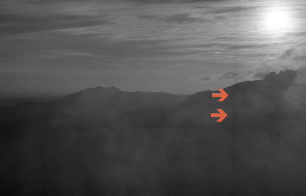

2. Vertical lines,
No idea whats happening here.
Canon AE1 Halina

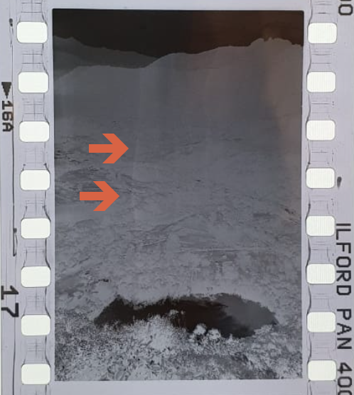

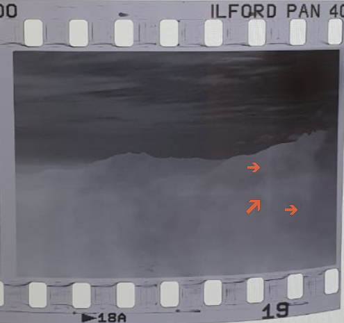

3. Horizontal lines and Sprocket halo (not sure if this has another name, its like light shinning upwards). Post doesnt let me
Canon AE1

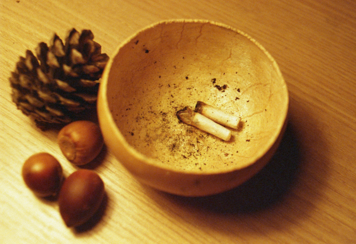

As I mentioned above, none of this issues are present with film used AFTER these B&W negatives:
Canon AE1

When it comes to the issue you describe as issue # 0 i would not bother too much as long as it doesn't intrude into the image area. It is probably caused bij the emulsion coming into contact with the reels and quite a few people using Paterson tanks and reels will run into this every now and then.
The watery stains you describe as issue #1 could also be caused by using the rotaion stick. Try to do inversion development next time and check what happens, especially when using the wetting agent with distilled water doesn't solve the problem.
When it comes to issue #2 i have no clue, but could it be a problem related to your camera, for instance a slight lght leak somewhere in the backdoor seals?
Issue #4 is a clear sign of bromide drag. Switching to inversion development will probably solve this as well.
This would be unlikely since it happened in 2 separate rolls from two separate cameras (Halina and CanonAE1). Both rolls were developed simultaneously on the same batch, so issue is probably on development. Plus lines are darker that the picture, light leak would be clearer than the picture right?

Yes, good thinking. I agree they can't be light leaks. It's odd because it's hard to think of a development fault that would cause this kind of issue.
