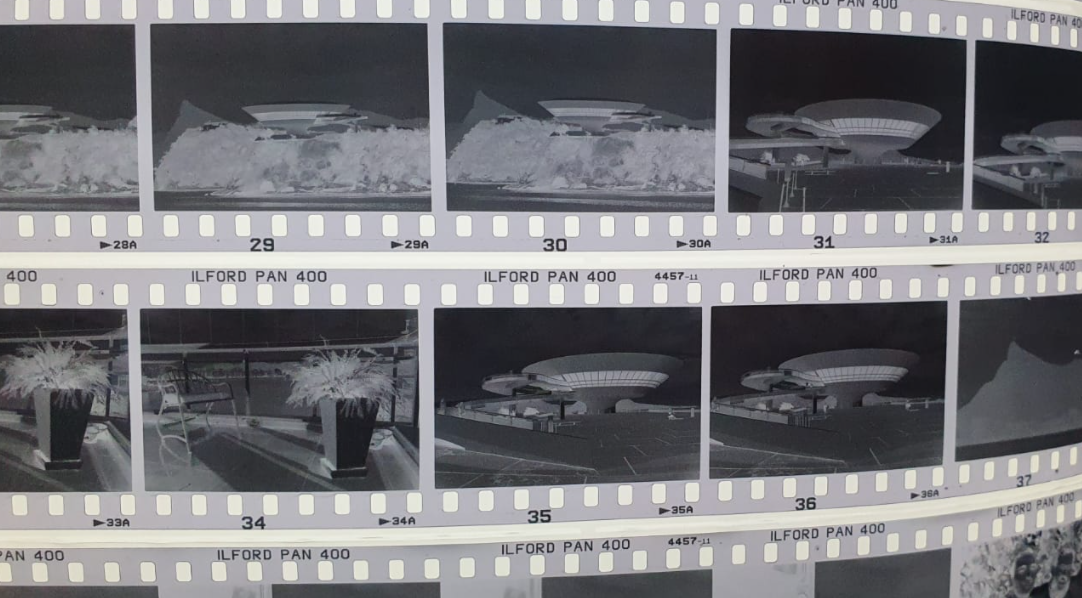

Hello again!
I developed and scanned over the weekend and wanted to share the results! I hope this serves as a guide if anybody has similar issues with Df96.
Issues are completly gone after:
1. Extending the time of the whole process (DF96) from 4 minutes to 8 minutes!
2. Switched agitation method to inversion (instead of the rotation stick)
3. Increased agitations to once (2 inversions like 5 seconds) every 30 seconds - previous was once every minute, so around 10 seconds of agitation or 4 inversions.
4. Included an extra step/wash with wetting agent diluted with distilled water,
- I tried 1:200 solution in a test roll, and it was terrible foam everywere and soappy stains almost gave up on including this step.
I reduced the proportion to 1:400 (0.5ml of photoflo in 200ml of distilled water), and got good results!
- For this step I tried removing the solution excess with finger vs. with microfiber cloth for lenses dipped in the solution, with no big differences both came out good with little to no contamination in the negatives. Ill try squeege and check if I get good results and no scratches.
End result: Clean negatives, no water stains and no weird vertical lines. I feel that they turned out a bit grainy tough... so I might try reduce time dev time a bit to see if I reach the optimum point.
Thank you all again!

Yes the negs look nice and clean, as they should be.

Reducing time in monobath won't change your grain -- you'd need to either agitate more (which speeds up fixing) or develop at lower temperature (which slows down development) to reduce the overall development, but I doubt that will have much effect on the grain -- it'll affect contrast more. Df96 isn't really a super fine grain soup. If you're after better grain, try D-76/ID-11 or Xtol (or a clone of one of those).
There's usually no need to squeegee or wipe if you use a wetting agent, especially with distilled water. Try without, if you get stains, you can simply re-wash.
Do not use a squeegee, not even fingers. Once the film is hung, touch the lowest corner of the film with a paper towel to draw off the excess.
Well done on fixing the issues you had. Much better results now.
Are you doing inversions with the photoflo step? You shouldn't be getting a lot of foam at 1+200
