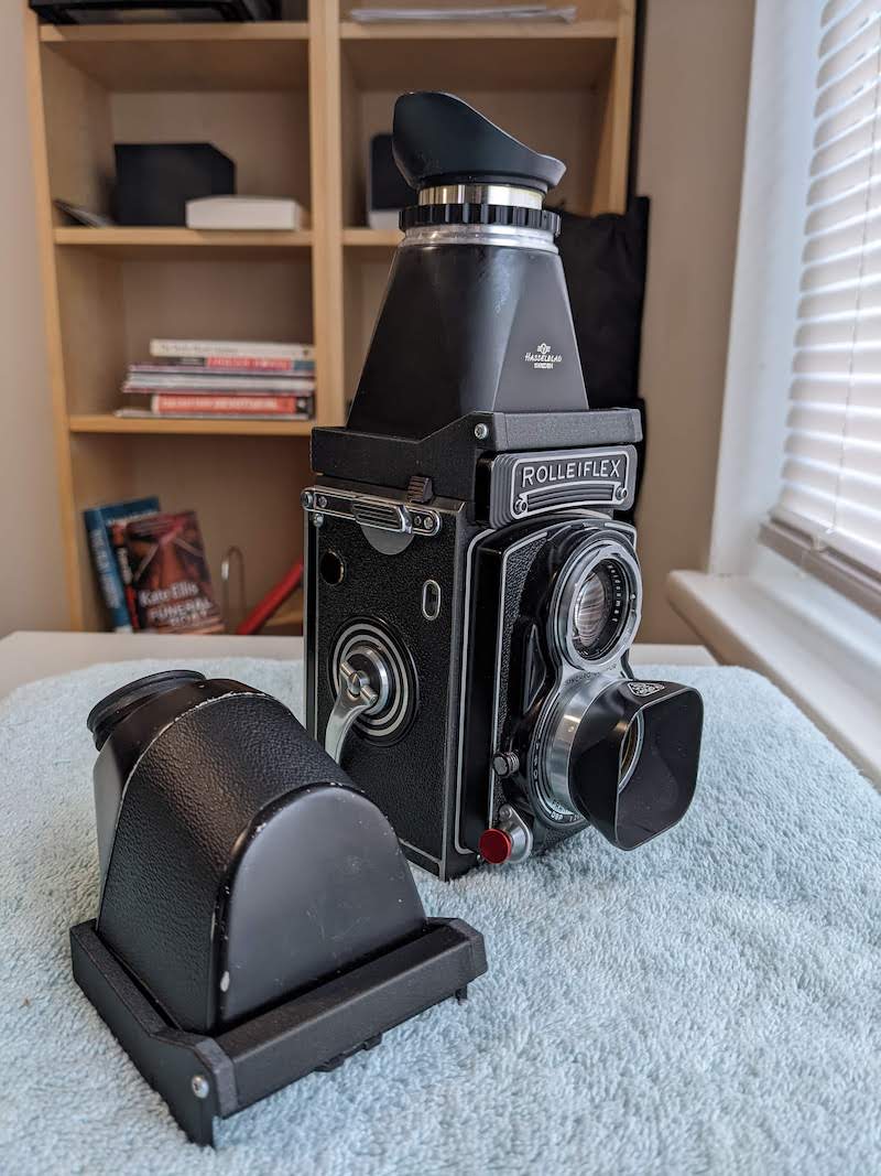

I'm using a Pulse (Prusa style) machine to print typical filament and carbon filled nylon. It is a pretty good machine for home use but cannot handle continuous carbon fiber as would be necessary for more serious structural parts. It has been useful and entertaining to print stuff for photo purposes as well as general household items. Perhaps my proudest achievement is a prism adapter for my Rolleiflex. I use Onshape, a free online CAD tool for design.
