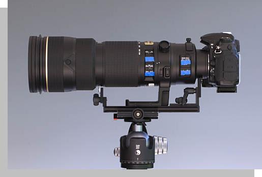

What I would need is an outer bajonet (it is more stabile). But it isn't comparable with my converter.
And it would not help.
Brause I have to build a construction like his here :
Because I will not risc to damage my Pentax body. From that reason "handheld" until I have time for selfconstruction.
