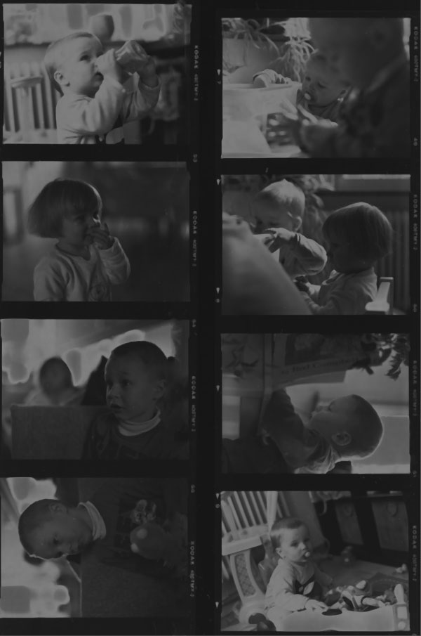

So here is my second contact sheet, I think I did it bit better exposure wise.
first part :
on this part I think that the photo on the left should have had 1 stop more ligth, photo on the rigth look nearly ok, what do you guys think ?
second part :
This is the second sheet I printed, I notice that in some places, where I should see white, I get something like greyish, I think this is my dev that dektol that wasn't good anymore, am I rigth ?
Clearly the first photo here is overexposed, i think the other could have done maybe with 1/2 stop more.
for data : T-Max 400 @400 in D76 for 7,5 minutes
I will try to get a contact sheet printer for 120 as I'd like to have nice looking sheets too.
On a side note, I was more careful handling the paper so there are no stains from spilled fix on them too...
Regards and thanks you all for the help and advices

Your contact sheet may be a little dark, but for a contact sheet it is probably fine, as all you need on a contact sheet is image information. When you start to print the individual negatives you can fine tune exposure and contrast.

As Clive notes above, the main purpose of a contact sheet is simply to let you know which negative(s) may be worth enlarging. Contact sheets are also helpful, however, for making notes about printing data in case you need to come back later for any additional prints from a given negative.
Being religiously consistent in making contact sheets can be an extremely useful practice. If you always have the enlarger set at exactly the same height, always use the same f-stop, always use the same exposure time, always use the same paper, etc., there will be a lot less need for numerous test strips when printing. A general rule for is to have the unexposed areas of the film get just enough enlarger exposure to be almost indiscernably identical to the paper's maximum black. On my monitor, your first sheet looks about right; your individual negatives look somewhat underexposed.
By the way, there is no need for a special contact printing device. Just get a sheet of window glass, preferably around 10 x 12 or 11 x 14 inches, to place on top of your negatives. Any glass shop should be able to grind the edges smooth; you may also want to super-glue a couple of handles near the edges.
