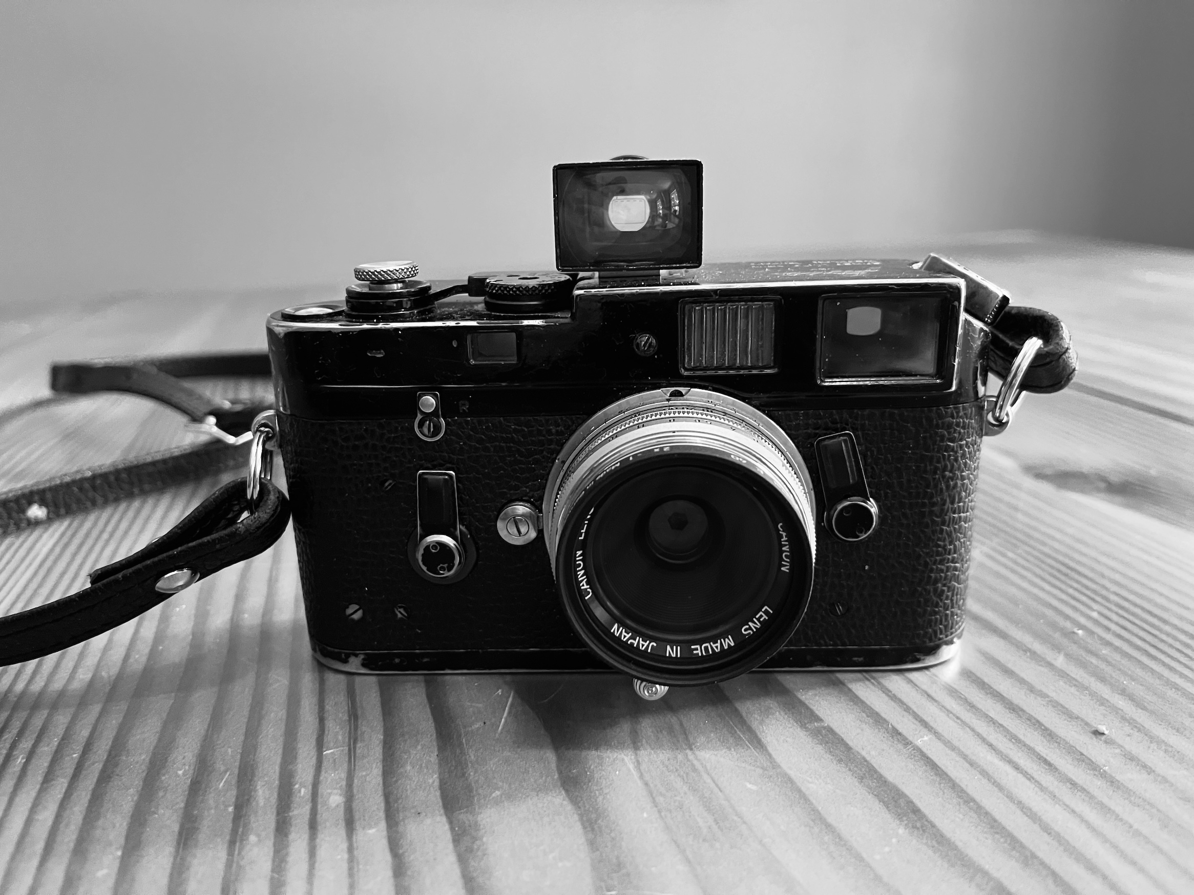

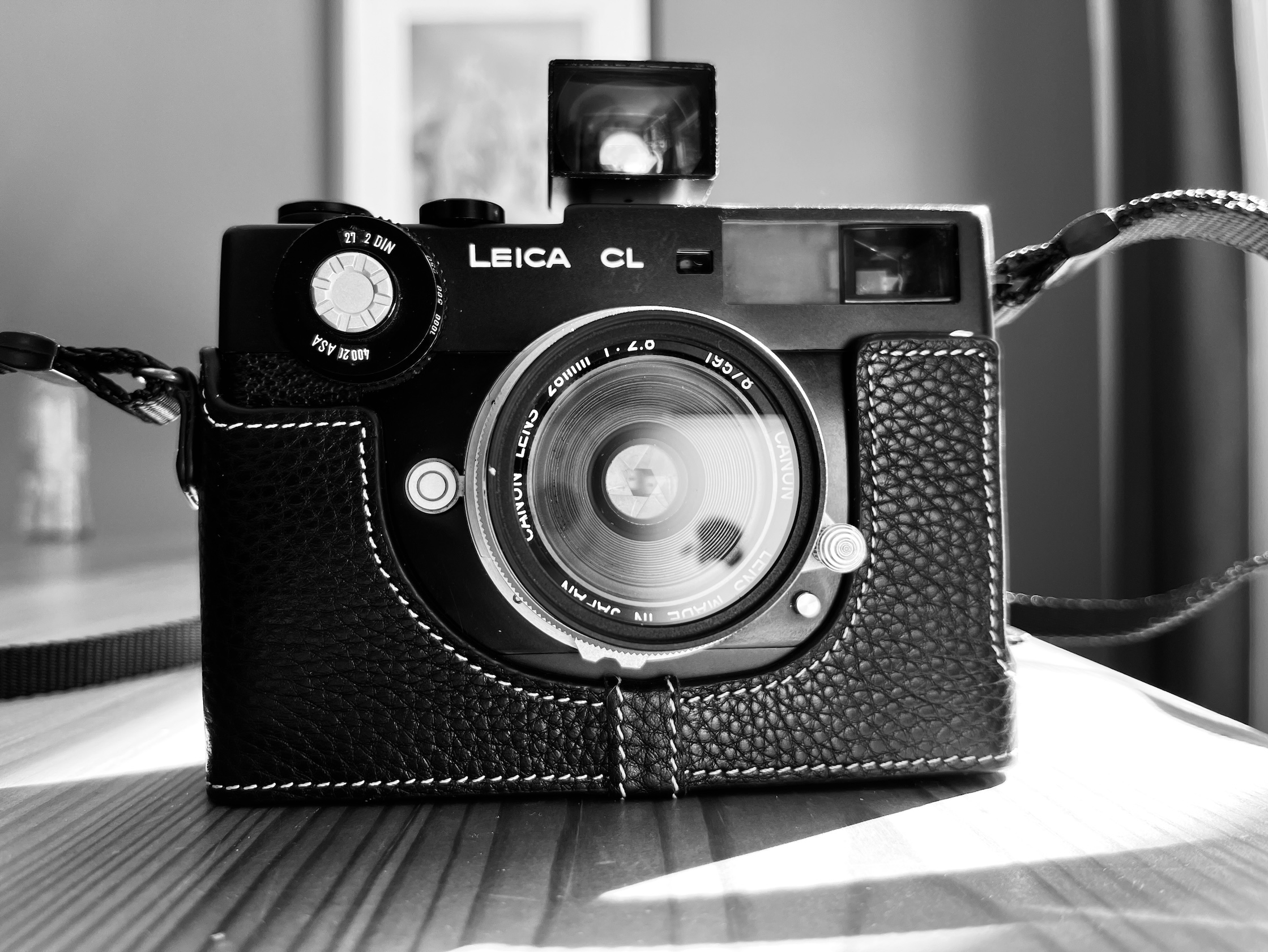

I've used Elmarit 28 (several), the Voigtlander 28mm f3.5, and currently have the Canon 28mm f2.8. I prefer the Canon image character to that of the modern Voigtlander. IMG_7131.jpgIMG_6854.JPGIMG_7675 copy.JPG The Canon is small and handles well. I think it makes a classic match with the Canon body. Years ago i also owned the Canon 25mm which is also worth consideration if the wider view suits your taste.
