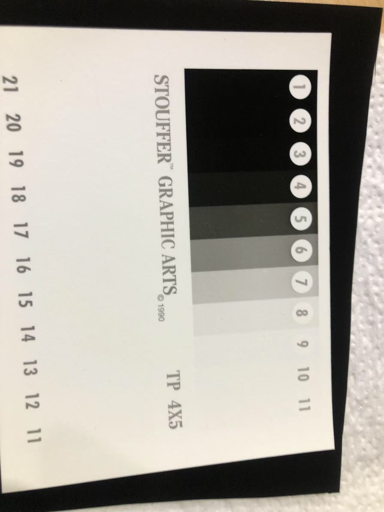

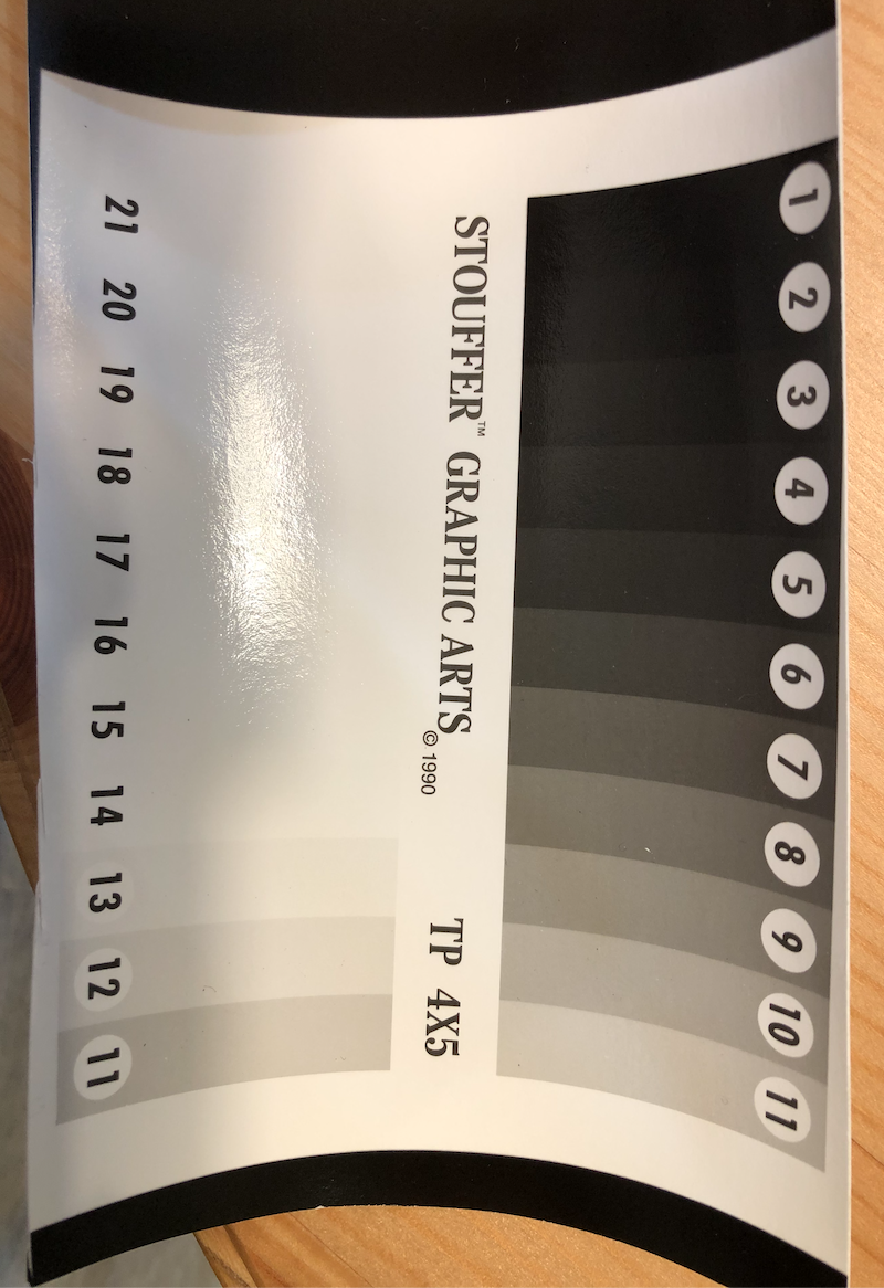

Due to the poor quality of the current halogen bulbs and the difficulty of purchasing Philips bulbs, I’m facing a bulb shortage issue with my De Vere 504 condenser. As a result, I have to look for new solutions. I’ve explored discussions about LED bulbs on various forums, but none of them have conducted contrast tests using a step tablet.
Today, I conducted a test based on the method mentioned in the book Way Beyond Monochrome. You can find the detailed procedure by Googling "measure paper contrast," where a PDF document is available for reference.
For my test, I exposed two test strips:
  • Test Strip 1 was exposed using a 0 filter.
  • Test Strip 2 was exposed using a 5 filter.
I used a 21-step step tablet for the test.
  • With the 00 filter, the results showed that step 12 had a density of 0.13 and step 2 had a density of 1.96. Based on the calculation, this bulb produced a contrast of R150 (VERY SOFT) under the 0 filter.
  • With the 5 filter, the results showed that step 8 had a density of 0.1 and step 3 had a density of 2.0. The calculated contrast was R70 (VERY HARD) under the 5 filter, though it did not reach the extra hard range.

That looks OK to me. What paper did you use?
BTW, there's no reason why you wouldn't be able to reach the entire range of the paper, from the softest to the hardest grade, with a white LED. There's nothing magic about LED light that somehow prevents this.
foma fb paper
I see, so that would be Fomabrom Variant. I'd start by comparing the curve you got for the highest and lowest grades to the curve shown in the datasheet. You may find your results match those curves, while the ISO-R grades mentioned in the datasheet don't. It wouldn't be the first time a discrepancy shows up here. If you still note that your grade 5 curve is less steep than the one shown in the datasheet, try with a blue filter instead of your multigrade #5. It's possible the multigrade filter doesn't quite hit the hardest grade in your case.
All this is assuming you properly develop the paper to completion and the paper is reasonably fresh.

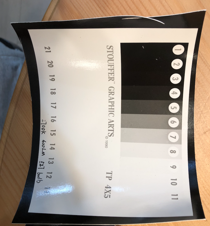

The latest results from the 47 filter test show that a 2700K LED bulb can easily achieve an R40 (0.3) contrast.
So the main difference with your earlier test is the use of a #47 filter instead of a grade 5 multigrade filter?
YES
