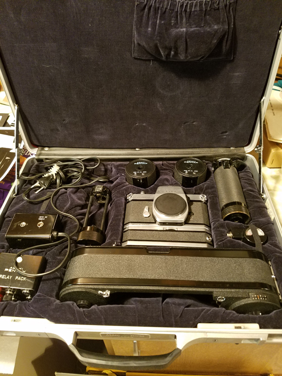

I had a Spotmatic with a 250 frame back that I used in the 70s and 80s. Processing 250 frames was quite a chore and had to get the Nikor large processing tanks and loader . I ended up shooti View attachment 285801 ng about 100 frame loads, about 15' of film because it was easier to load the shorter length into a smaller processing reel and tank. The Spotmatic Set 250 came in a slick briefcase that held the camera with motor drive, 250 back, grip and power supply. There was a lot of accessories available as well. When I moved to the Canon F1N I got the 100 frame back for it and with the motor drive and it is definitely heavy.
What did you shoot with it?
gordrob
Jan 29, 2005
1,010
Western Cana
I used it a lot for wildlife photos, mostly birds. It was on a tripod a lot of the time . Not a good choice for using handheld for any length of time.
