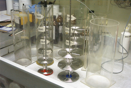

220 Reels
I have quite a few of the larger 4-1/4" diameter 220 reels.
Stay away from the smaller 3-3/8" diameter reels, those thinner spiral wires are notorious for trouble.
For color work I'd definitely stay away from the smaller reels.
I've developed over a thousand 220 B&W films in acrylic tanks with these reels.

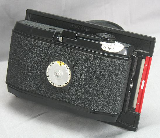

I also have a 6x12 Horseman roll film back (4x5 size) that can take 220 film...
PM me you're interest in a nugget or two, I'm cutting back on my shooting...

I have some of the larger size 220 stainless steel reels and tanks as well. The space between the spirals is the same as a 120 reel. I could never get the 3 inch 220 reels to work. Always got untracked. I wish they made b&w 220 still but that is a dead horse.
Dennis
