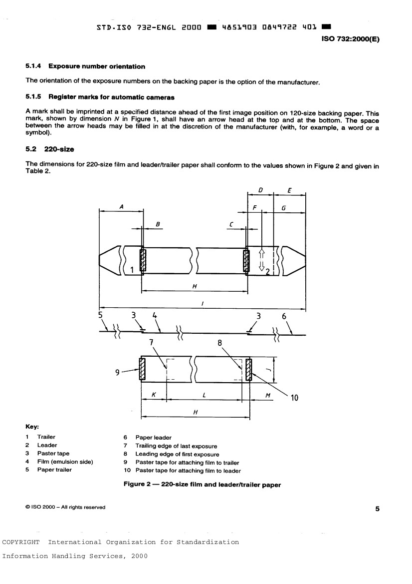

Anyway, I hope I will not end like Assange or Snowden, these are the two pages of the ISO booklet with the 220 dimensions.
In short leader 552mm and trailer 373mm, with of course some tolerance:
the whole 17-pages booklet (2000 edition):

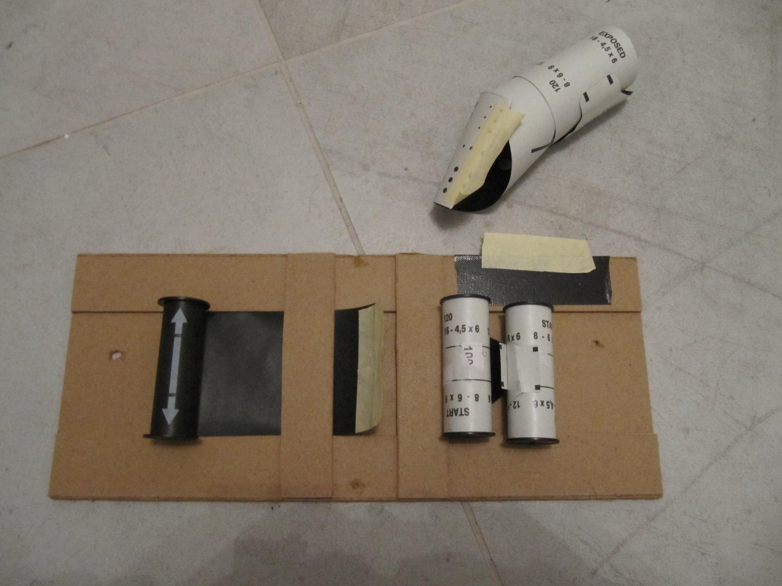

I use this helping guide, made of cheap thick cardboard (taken from frist price pictures frames) in order to stitch with tape two 120 rolls, a leader and trailer cut from 120 paper, together.

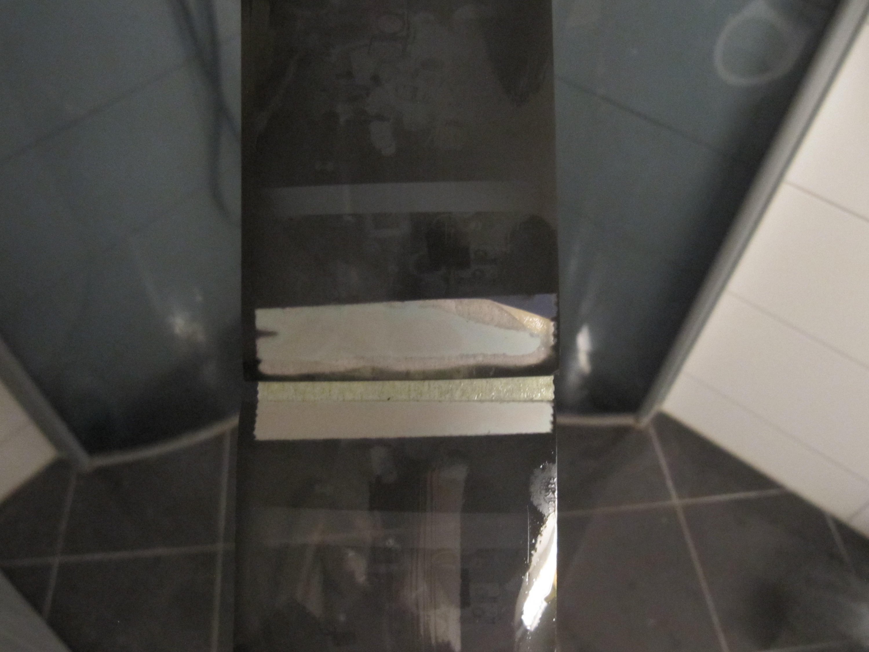

As mentioned the problem is that one frame is lost (the one where the tape is put), so I am playing with my Bronica in order to see if I can have an extra frame at the end of the film (25 instead of 24, one lost, so 24 effective).
Takes me between 5mn and 10 mn to spool a 220 roll like this.
on the picture the leader is inserted, ready with a piece of tape, in order to receive the first roll, then roll it loosely (spool on the left of the trailer), feed the 2nd roll, tape, roll further until the end, feed the trailer (the piece top right) with also a piece of tape ready, then remove the whole from the cardboard guide and roll it on the second spool. Emulsion is up and gets only in contact with the two transversal pieces of cardboard, so to avoid scratches. The tape on the gaffer piece top right is used to stitch the two stripes. At development time, either use a Paterson tank, spirals take 220 film, or remove the tape and feed two metal spirals or whatever:
