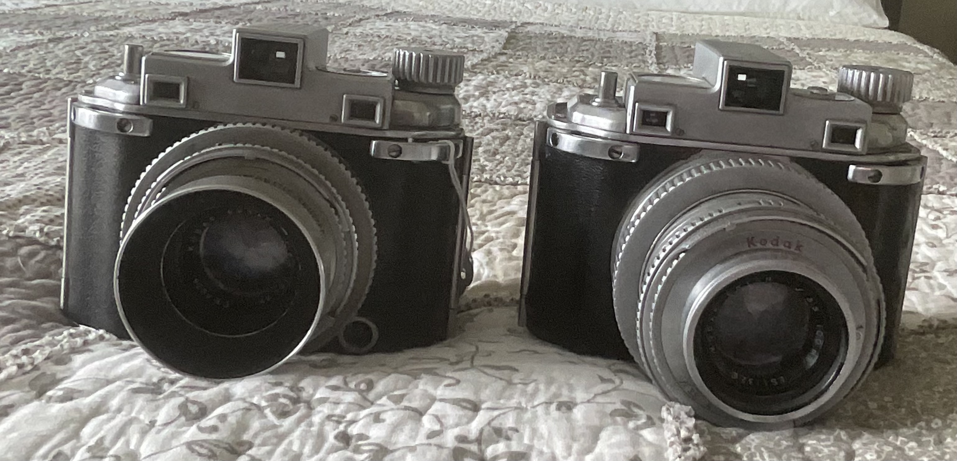

Great topic. Believe it or not I have used 120/220 film. I have two Kodak Medalist cameras. One has been converted to 120. I would also like to try the little adapters for 35mm film they sell on eBay. And I have processed and printed the pictures toh Unfortunately my old arms are not strong enough to hold the camera anymore. However I think my Nikon F4 is at least as heavy. I also have most of the Kodak accessories for these cameras, including ground glass and bulk film backs, filters etc

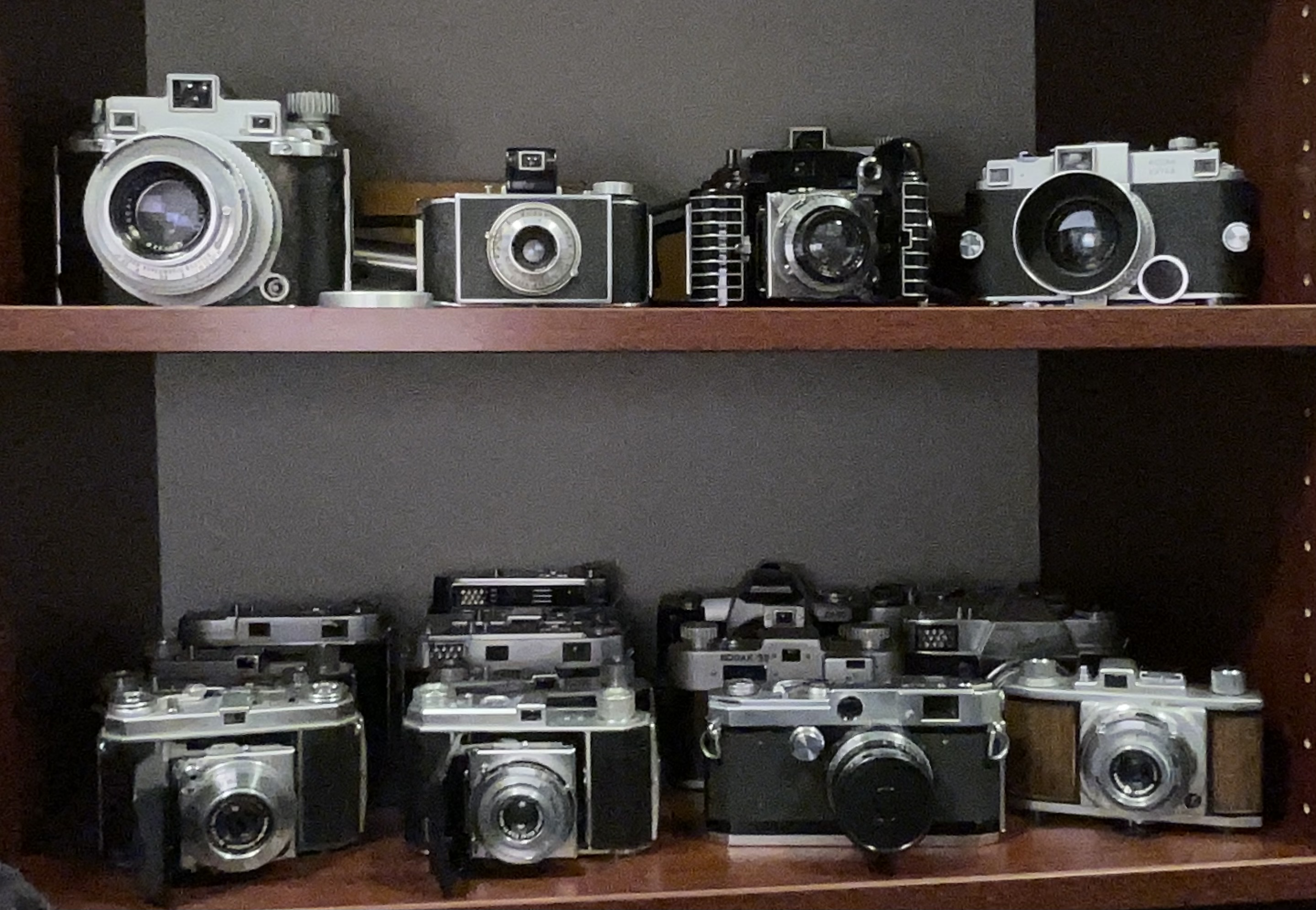

Here are some other shelf mates of the Medalists.
