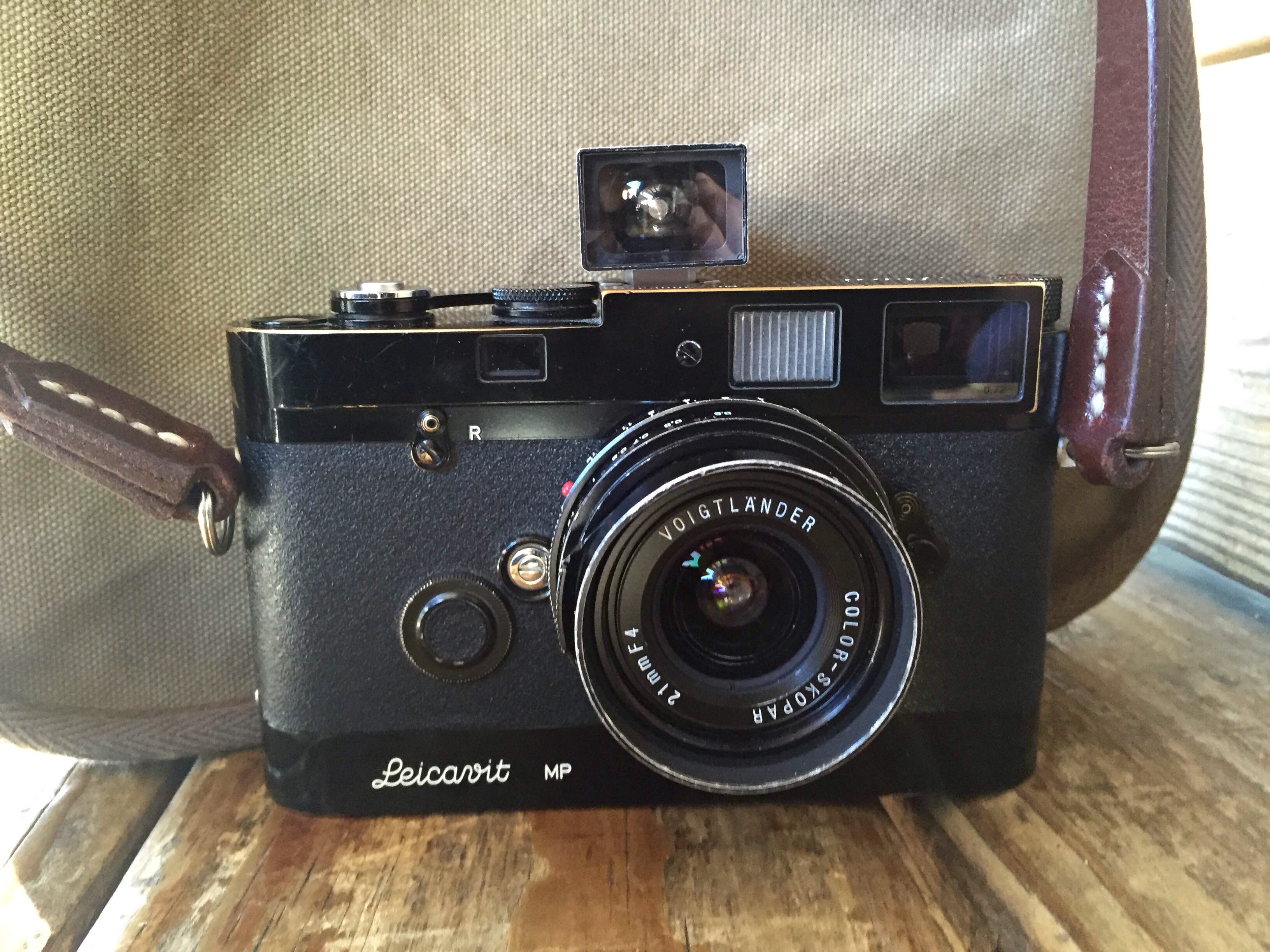

I have the Voigtlander 21/4, and positively love it. Mine is the version which has a LTM/M ring provided with it, so I can use it on both my M4 and IIIa cameras.
On the IIIa, with a Minolta finder (the plastic VC finder gets in the way of the shutter dial) it makes a beautiful combo.
On both cameras, a light and easy to use lens.

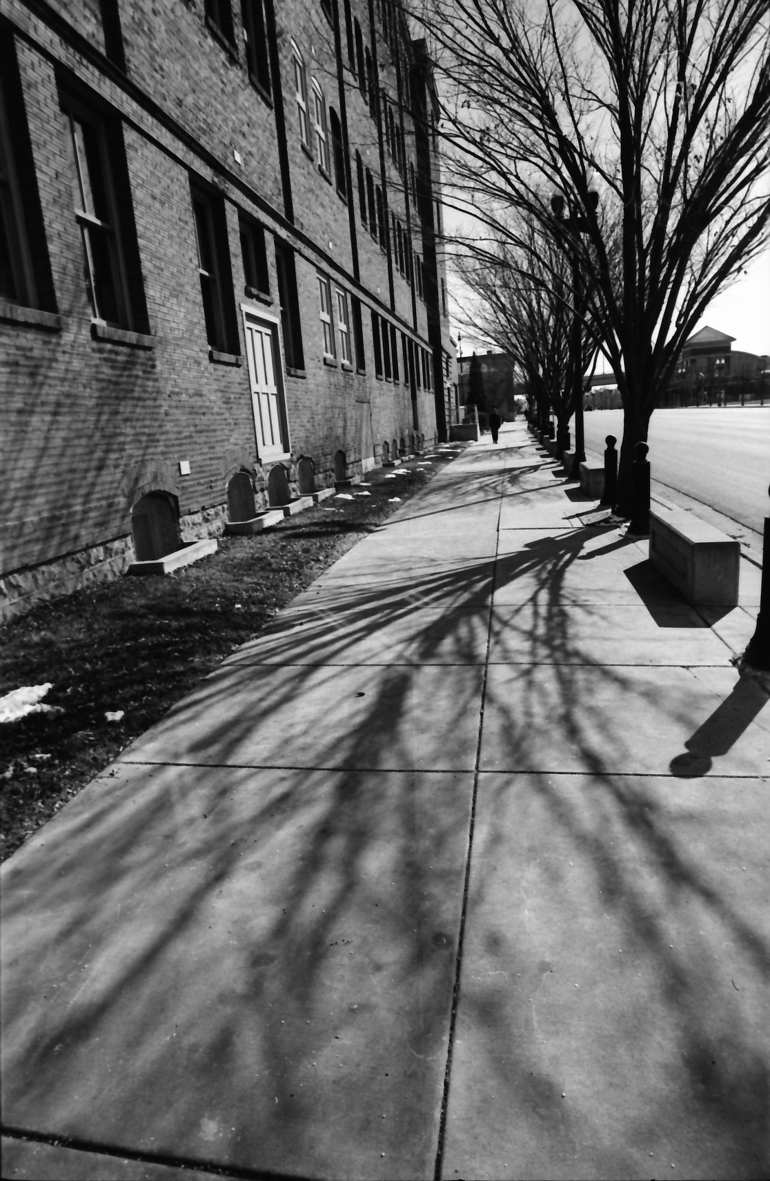

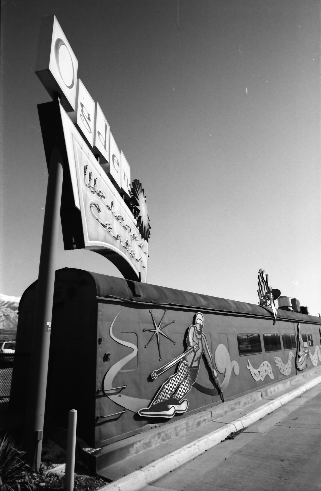

I have the 21mm f4 Voigtlander version in Nikon mount and it is an amazing optic. Very compact
