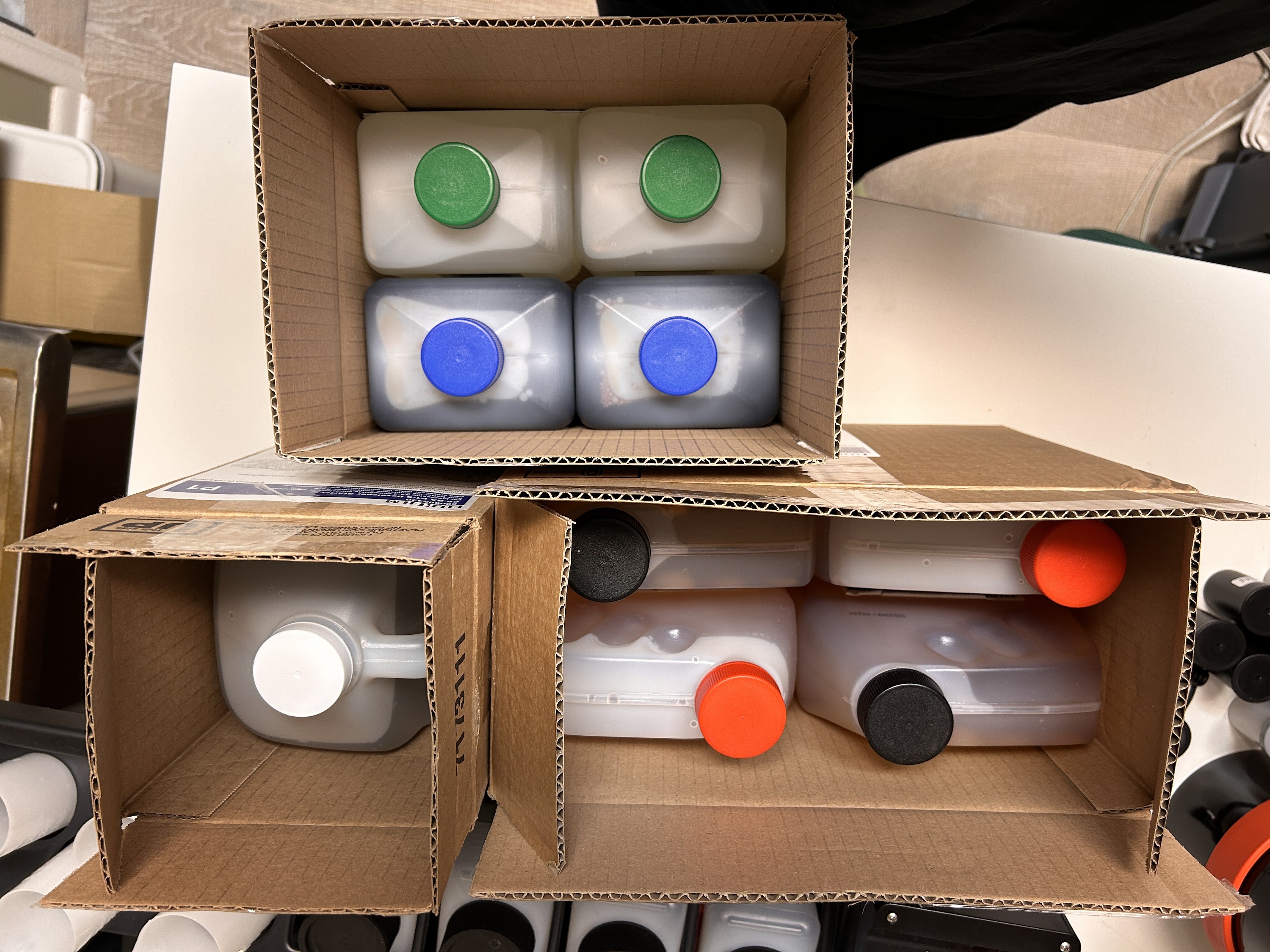

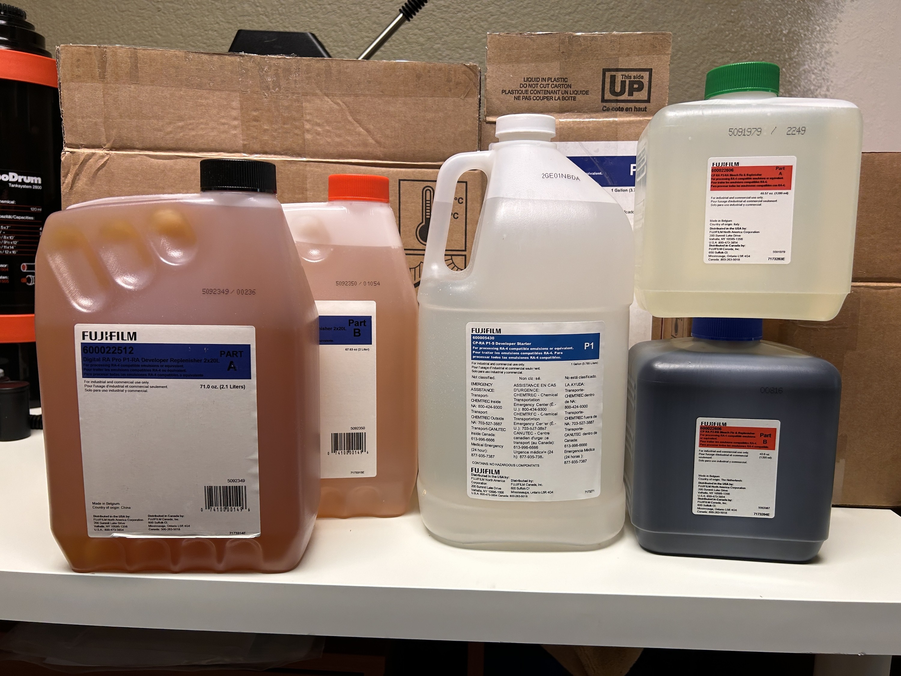

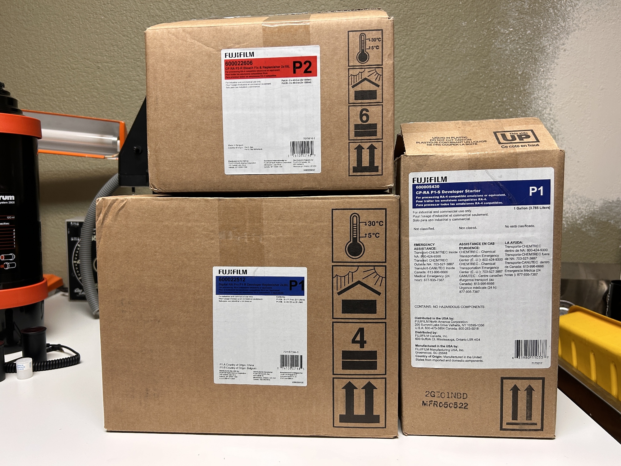

What this looks like in reality when you get the minimum amount Fuji sells to get a complete set of chemistry to do an RA-4 print:

If the labels on the bottles are to be believed, this particular batch was also manufactured in Belgium from chemistry from Italy, Netherlands, China.
I wonder how much difference there is between the stuff we get in North America vs rest of the world.
Ah, right, I see one of the labels on a bottle now. One of your cardboard boxes says it's manufactured in the US. I do know that the Belgian plant that manufactures the RA4 (and C41, E6) chemistry does quite a lot of business for the US in other fields, so it's sensible the US-sold RA4 chemistry is also (partly) sourced from here.
