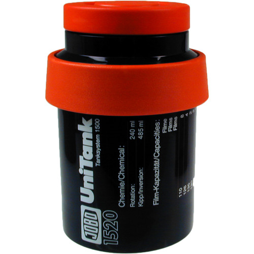

The only time I've ever had trouble loading 120 was when I hadn't done it in a couple years. But I'm not looking to start either...The Jobos look easy to load and I like the little tab that prevents overlap...but I don't like the price all that much.

The winner of the competition to be my next film developing tank will soon be revealed. Will it be Patterson, with its famously leaky tanks, and sticky ball bearings? Will it be Jobo, with their famously overpriced developing accessories? Will it be Nikon, or AP, or GAF, or lowly skanky Yankee? Stay tuned for the next exciting episode of As the Twizzle Stick Turns

and the winner is.....<bapapapabapa drumroll>
Well I'm not sure if its a winner yet or not, but it took my money. I don't normally spend more money to get something that can be had for less money, but the Patterson stigma runs pretty deep I guess. I liked the idea of the clip so I don't have to tape rolls in the dark. I also liked the lack of ball bearings. I've developed film for decades and never needed a ball bearing, so I don't know why I'd want one now.
We'll have to see if I actually like it in practice or if I have to start working on a Jobo stigma...
