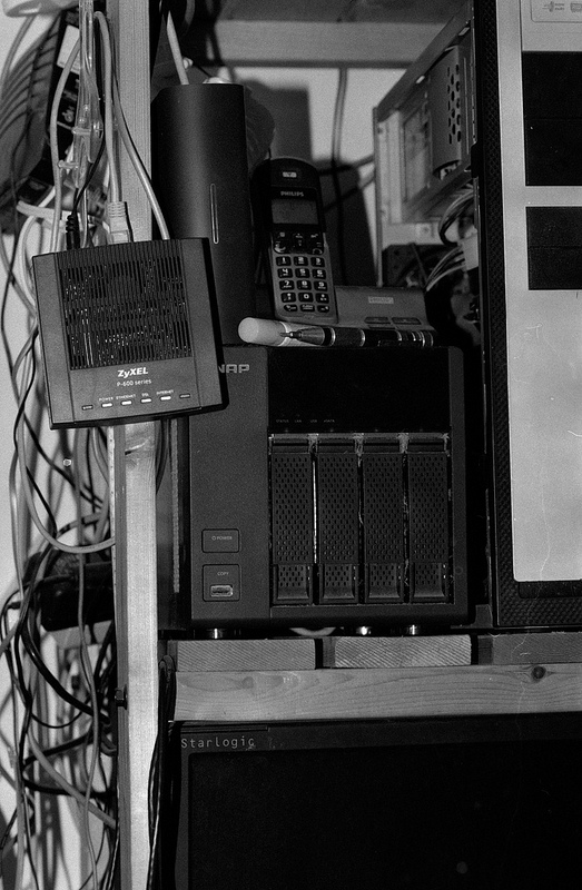

Well, after a few trials I have some results.
What a lovely look at my server rack at 3 am.
full size images (Thornton and Microdol-X) are on flickr http://www.flickr.com/photos/peterbcarter/sets/72157639557582105/ . View all sizes to look at the grain.
The film was ORWO N74+, not a fine grain film by any stretch but Thornton gives really good results. I buy 400' reels and love to play with this.
I develop 4.5 mins for bath A and B in Thornton, stand with 1 rapid even shake, 1 tap and leave alone for the duration. This gives the highest acutance and compensation possible.
30g/l was added to D23 for A and 60g/l was added to B (Sodium Metaborite 12g/l).
The PH of both A baths only differed by .1. The second baths were identical. The dev times for both sets of chemistry were identical and visually gave the same densities. I would expect any procedures you already have would give comparable results.
I chose 60g of NaCL in the second bath to insure I saw something. I wasn't trying to nail down a formula, just to see if it was worth exploring further.
if you looked at the two samples full size, the Thornton is only slightly higher in grain but the Microdol-X has noticeably less acutance. Considering these are 35mm, I consider the IQ to be very good. However, I think the salt will stay on the shelf.
Thanks to all in the thread. The discussion was helpful.
