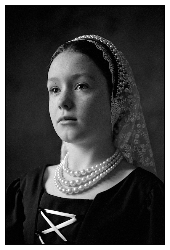

I don't know about famous photographs, but I was pleased with this one: unplanned, natural window light, only time for 3 frames, lots of very different stuff on the same roll - and yes, it does print straightforwardly.
