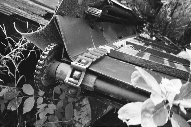

I shoot ultrafine extreme, I develop it in good ole D-76, 1:1 @ 20c (my room is constantly 20c so I adjust my times accordingly) and I have great results with it.
Here's a shot I took with an Instamatic a few weekends ago (loaded ultrafine into a 126 cart).
