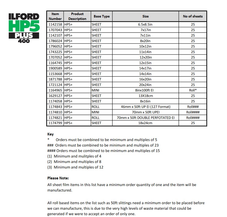

maybe it pays off to buy Ilford?
The minimum ULF order for 46mm film is multiples of 23 x 50 foot rolls of HP5.
I just don't have that spare change laying around...

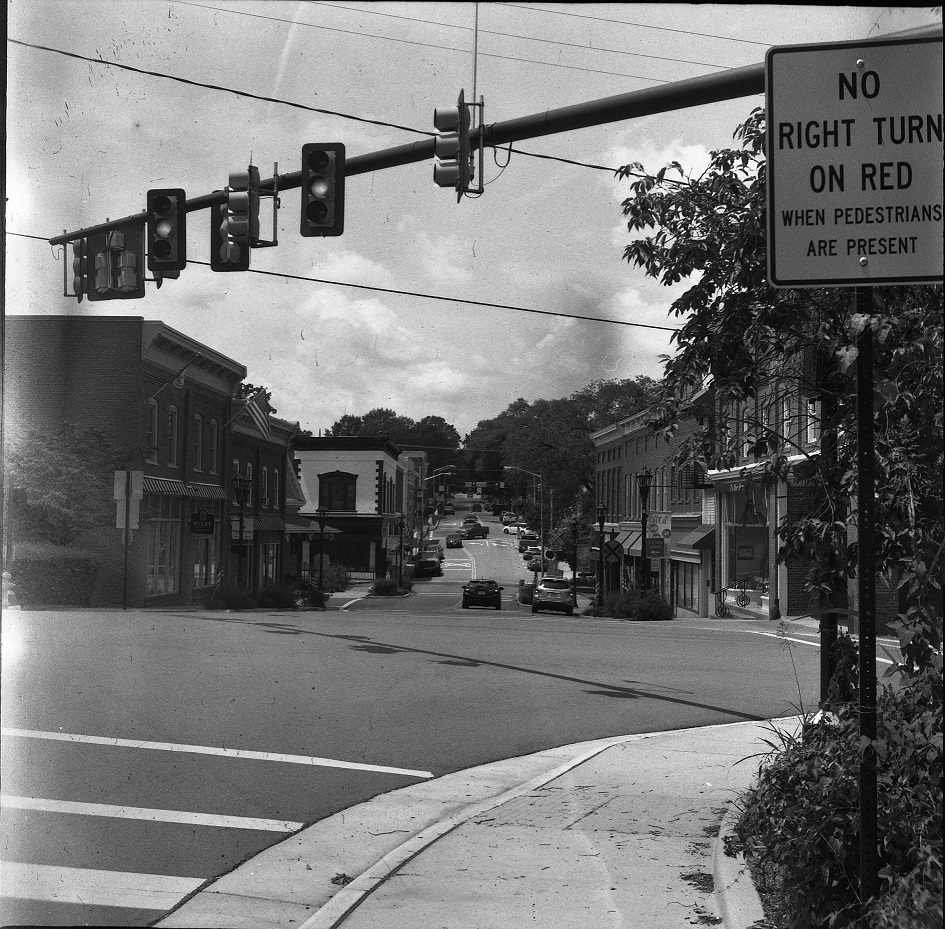

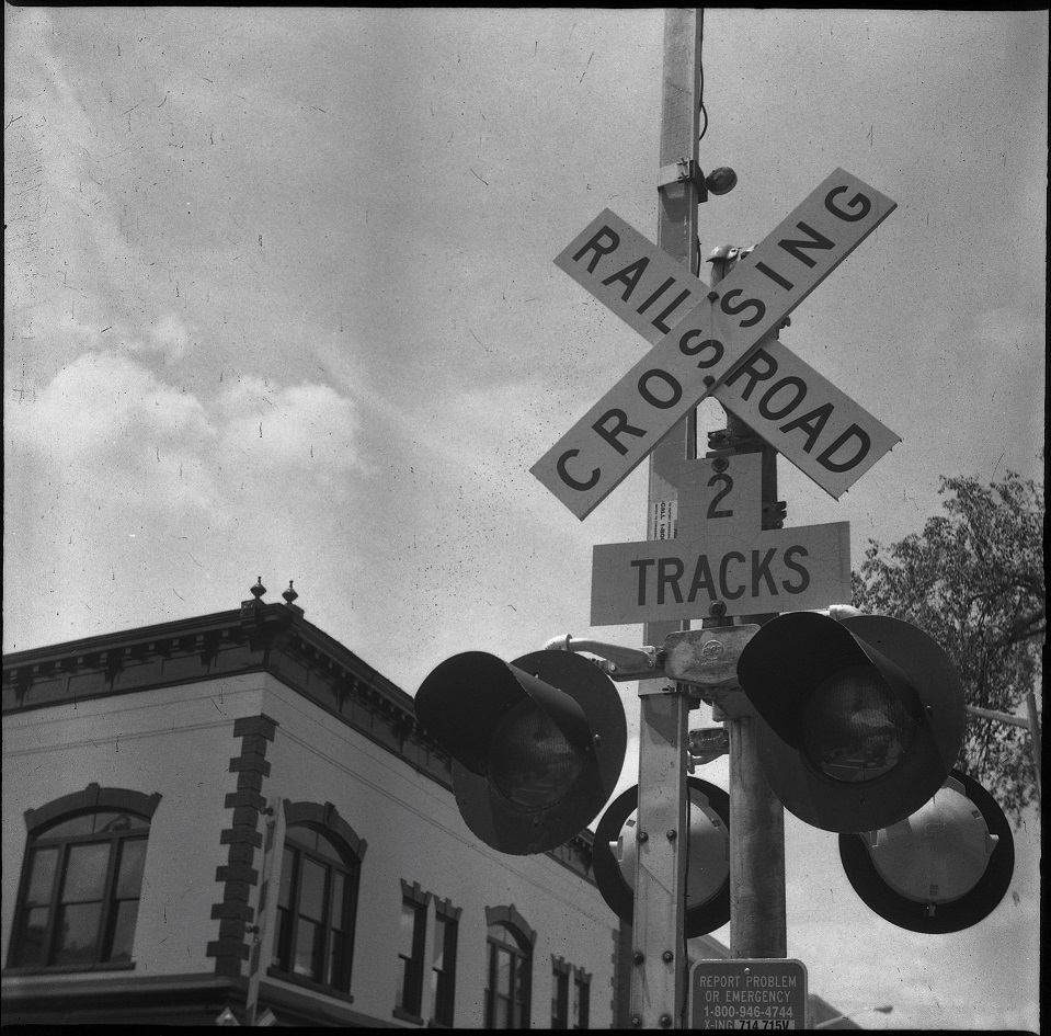

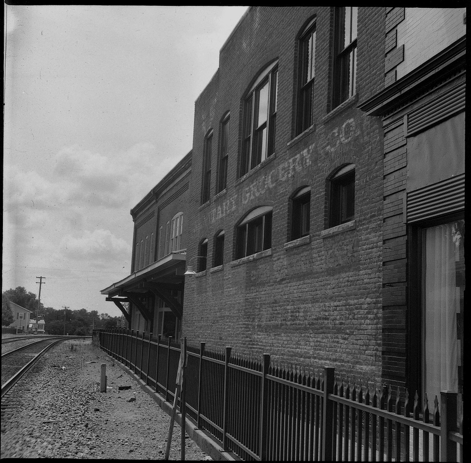

My fears were well founded! Yuck.
After processing it, I found "frilling" along one edge of the film and some fogging along both edges, as well as a nick torn into the backing paper about halfway into the roll. There also appears to be grain clumping or dirt in the image, although I can't see it on the reflected surface of the emulsion or the base.
To be fair, my multiple attempts at getting the roll through the camera might have introduced any or all of the above defects. Only another roll (hopefully without all the gymnastics) will tell.
I processed this in my Jobo in a 2500 series tank using D76 1:1 and there appears to be a density streak in what few images I could salvage. I will return to hand processing in a Patterson tank for the next roll to minimize the possibility of machine induced currents.
These scans were on my Epson 750 with the negs taped to the surface of the platen glass; Another hurdle to address in the future.
Not a good start, but a start...
