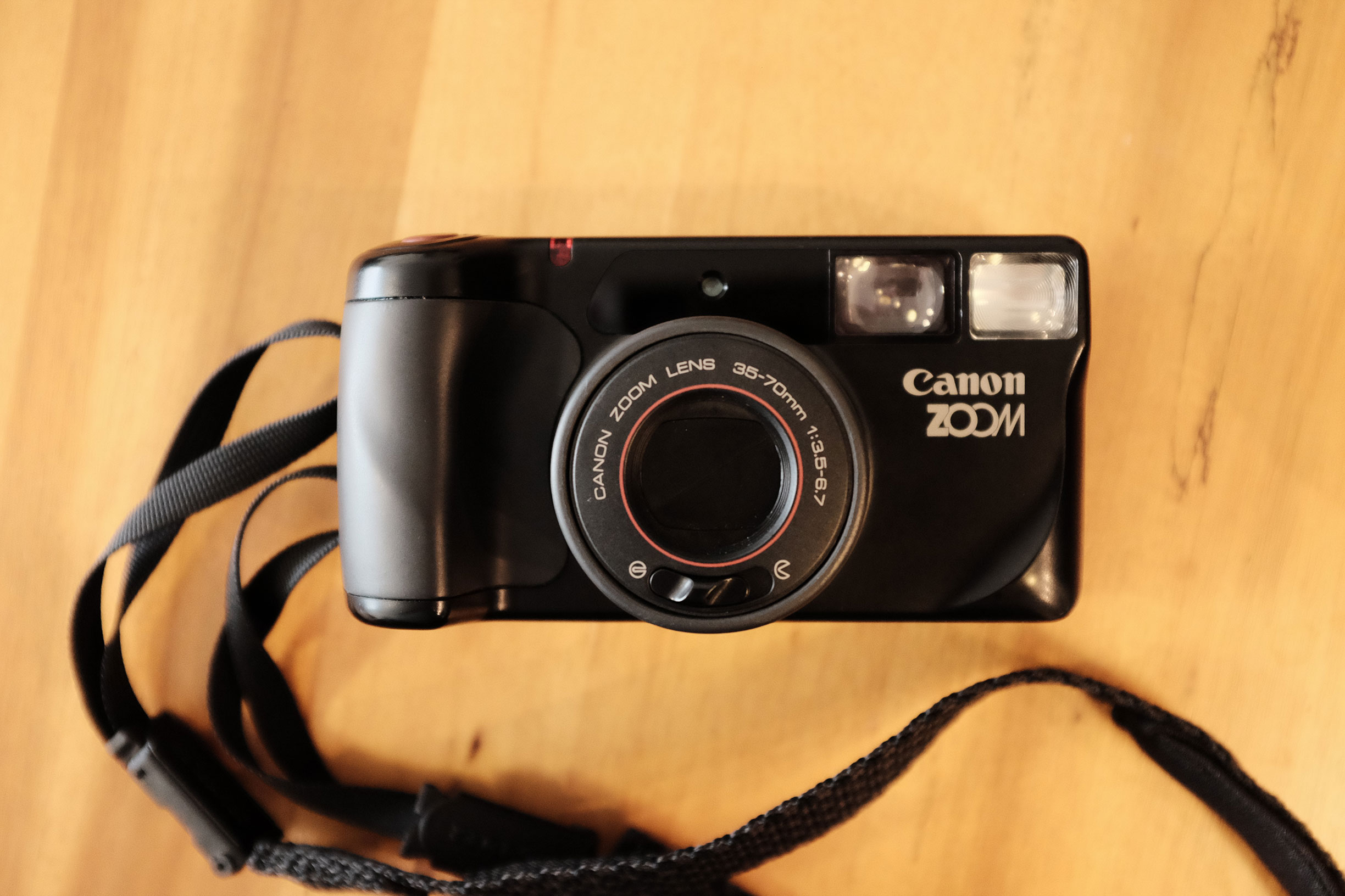

I have the same question! I got this point and shoot Canon Autoboy Zoom a couple of days ago and quickly shot a test roll. It says its a fully automatic autofocus camera and there seems to be an AF emitter and AF receiver on either side of the light meter. However, I really don't know if the autofocus did its magic (by half-pressing the shutter button) because I couldn't hear the lenses moving. I am used to hearing mechanical sounds while the camera is autofocusing. Anybody familiar with this camera?
the camera has autofocus, see https://global.canon/en/c-museum/product/film125.html. it seems to me that a lot of the cameras use prefocus and by half pressing the shutter, you hear the lenses move. but there are some which just get measuring ready and do a quick and inaudible move when you fire the shutter. but maybe I'm wrong...
If that's the case, the lenses move really quietly. I literally tested it now and had my ears up to the camera back and also at the front of the lens and couldn't hear anything except for the mechanical noise of the shutter firing. I hope this camera's not a dud and my test shots turn out fine!

That lens likely uses internal focusing because the front beauty ring can't move. With the focal lengths
of the zoom it's not going to move much at all. Since you've already shot a test roll, wait 'til you get the pictures back
before shooting anything else.
