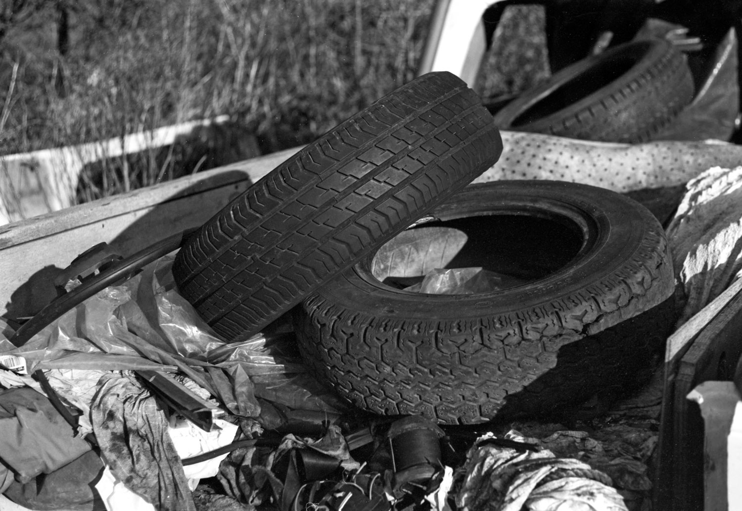

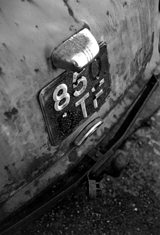

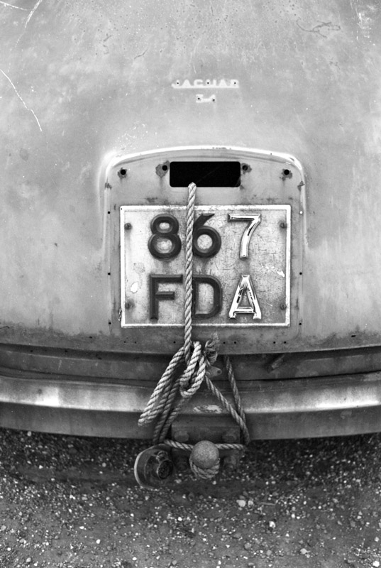

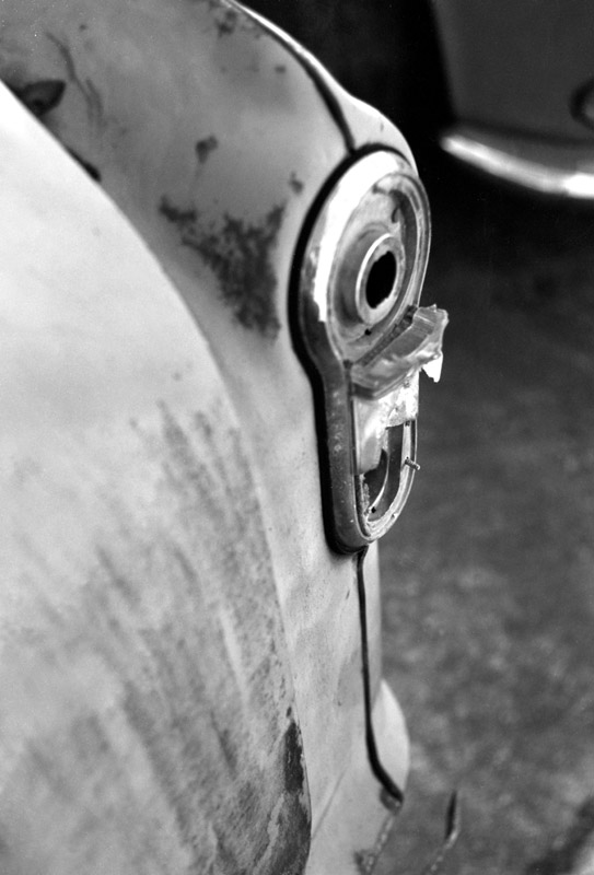

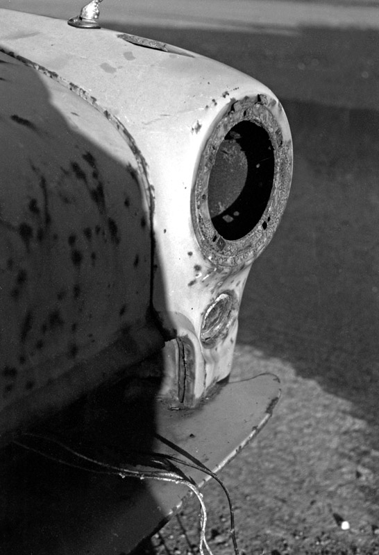

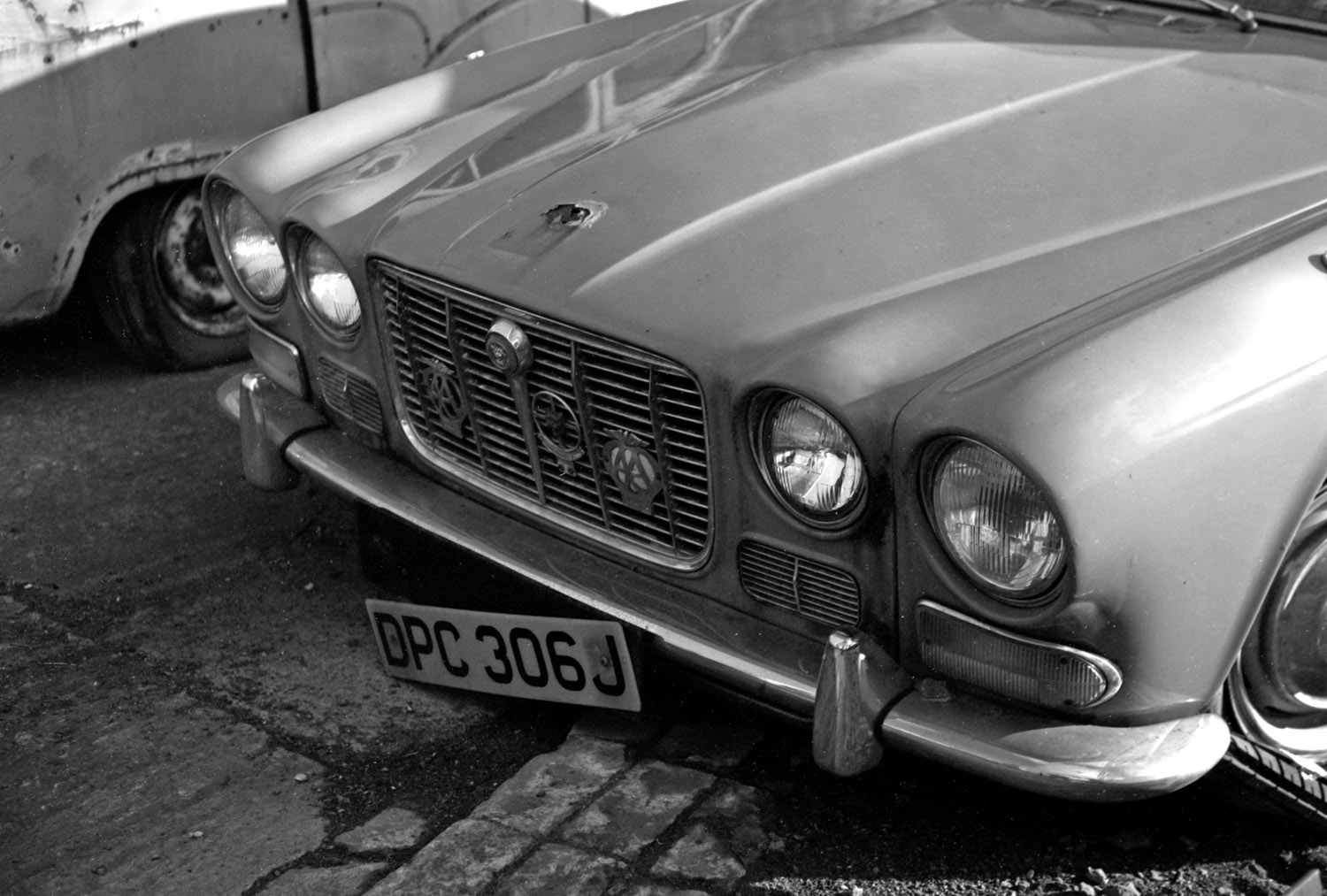

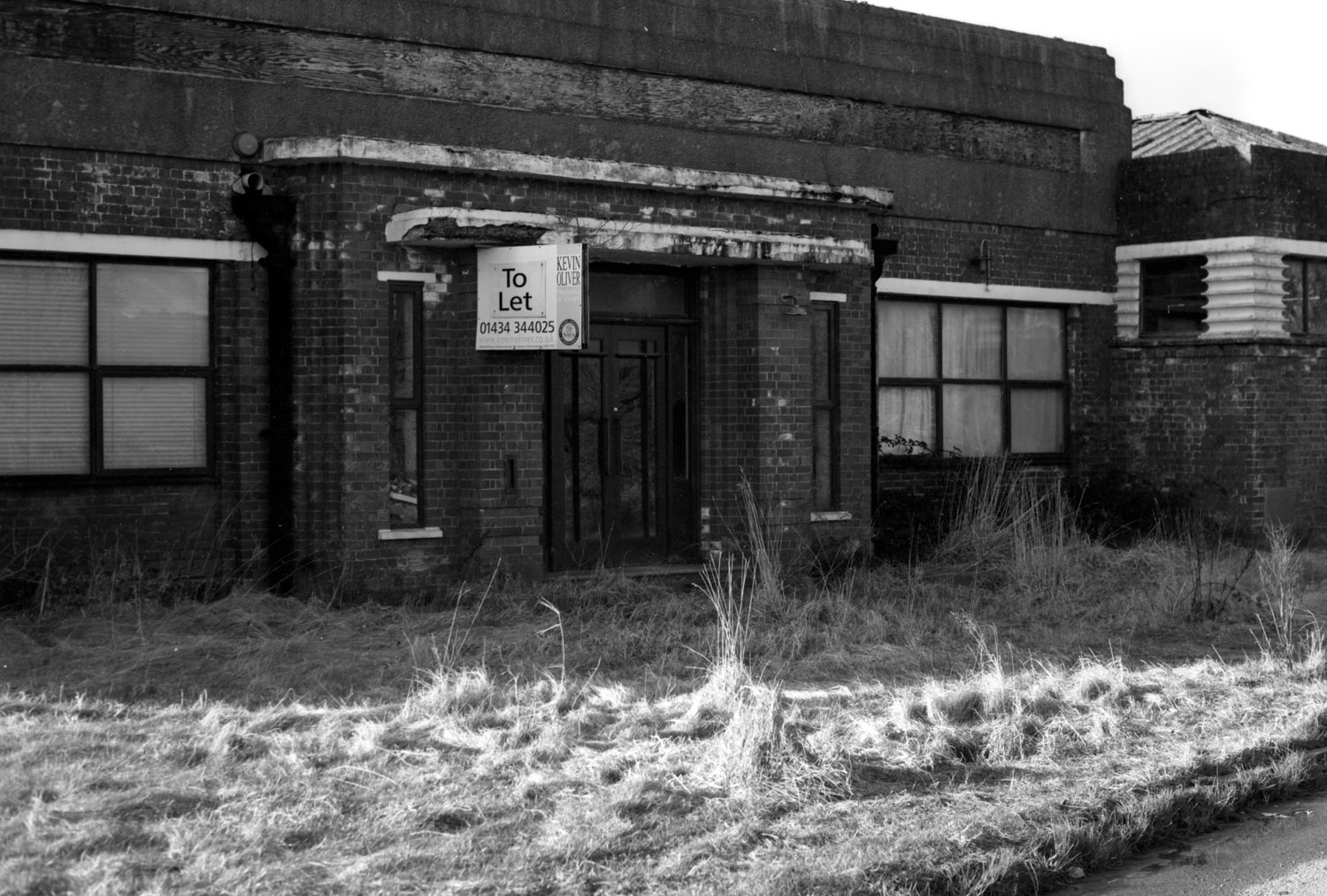

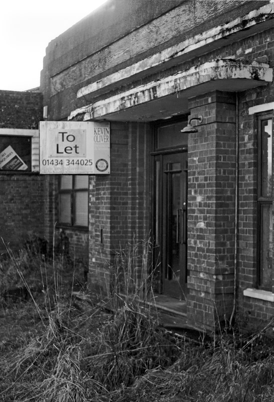

Normally I shoot Tech Pan at 25 and develop in 1:3 Microdol-X for 30mins at 25C, it gives a nice tonal range and tames the contrast. However, this roll I made a mistake and exposed it at 64. Therefore I extended dev time to 45mins, 20C and this seems to have done the trick.
Zenitar M2S 2/50 on EOS 10qd. This small plastic Russian lens is excellent, really sharp and contrasty and has a good deal of pop at f4.

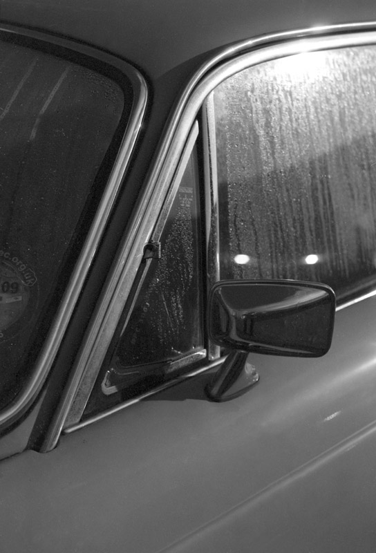

Happily these rusting Jaguars are awaiting restoration. Baby is my friend's 3 month old son.
