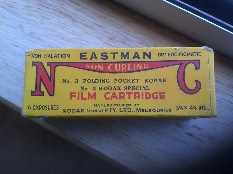

Is there anything further to indicate the type of film? In 1938 it looks, based on Kodak's own history pages, like the "normal" film would be Verichrome---the ortho version, not Verichrome Pan, which wasn't introduced until 1956. If so, you could develop it by inspection under a safelight, but you'd want to be pretty confident that it was an ortho emulsion first.

These old films didn't change as frequently as the newer stuff. I have an old PLI from just after WWII that recommends about 10 minutes in D-76 with agitation every two minutes for Verichrome. In size 118, it is probably Verichrome, if it is from Kodak. I would recommend that you unwrap the film in total darkness and see if the backing paper is in place and taped so that the film will not unwind. (If the tape is gone and the backing paper is loose, cinch things up and secure it with a bit of Scotch tape.) If the backing paper is in place, you can examine the roll in the light and determine what kind of film it really is.
The film format is 3.25 by 4.25 inches, and you will not find a film reel for it. You will have to develop it using the see-saw method, where you attach a clip to each end of the film and, with one clip in each hand, run it back and forth through a tray or deep tank of each of the solutions. This is sort of continuous agitation, and times will need to be adjusted. A 10 to 15 percent reduction should do - say 8-1/2 to 9 minutes. Verichrome was orthochromatic, and the instructions say you can develop it by inspection with a Wratten No. 2 safelight (dark red). The No. 2 is really quite dark, and ordinary red safelights are not really safe for this film. Even with the right safelight, I would develop for the first half of the time in total darkness.

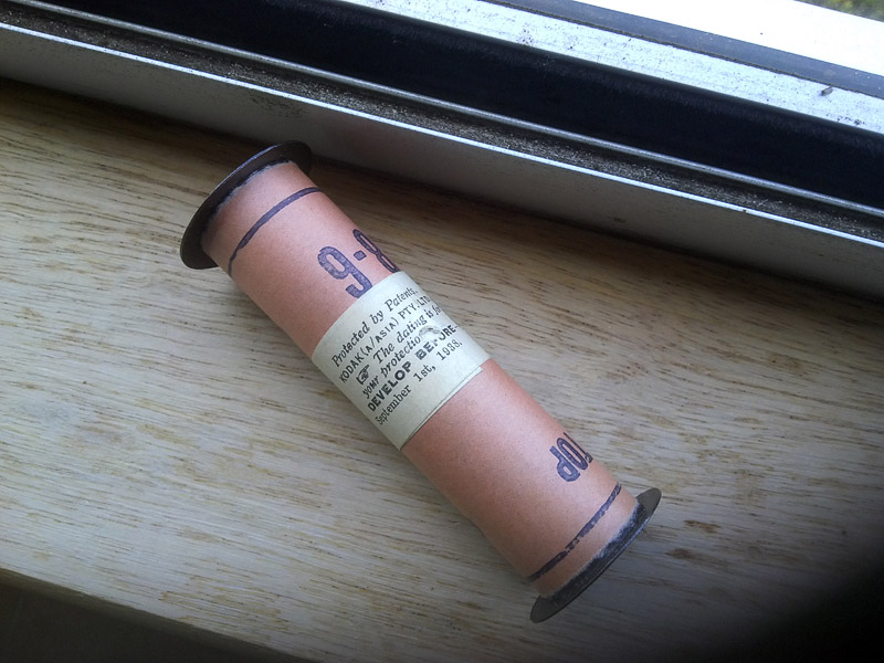

If the film is wrapped in a paper-backed foil, it may be unexposed. Kodak roll film was packed that way prior to the mid 50's.

Is the foil packet opened? If you remove the roll from the foil, does it provide any clues about it having been taken off the supply spool and rolled onto the takup spool, like with a 'exposed' label sealing the roll after exposure?

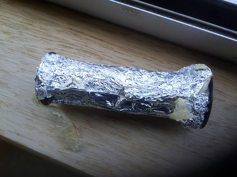

OK, attached are images of how the film came and the box it came in with it.
I am now probably considering that it is not exposed, as no where does it mention that its exposed on the paper. As per ctsundevil's suggestion, the film was wrapped in a paper backed foil (as you can see). I didn't realise that this is how it may have come:

It looks like unopened indeed. If you don't have a camera for it, you could cut off a piece and tape it inside a 4x5" sheet film holder and expose at low ISO. Develop and see if anything is on it, before you use the rest.

I am probably not that interested in exposing the film, as its a nice little piece to have in the cupboard. I am probably more interested if there are images on it - possibly images that were taken around the time that my father was born. I think I got excited, as it was wrapped in aluminium foil. I immediately thought of what I do when I am travelling with exposed 120 film (call me paranoid).

I think you're right not exposing the film but keeping it as-is, especially if it isn't used indeed.
