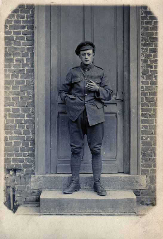

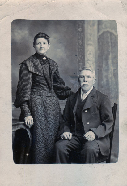

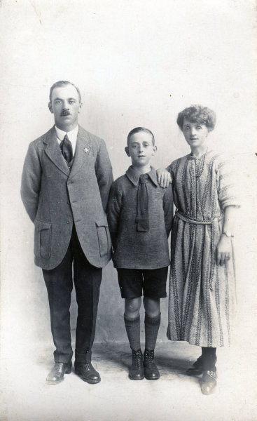

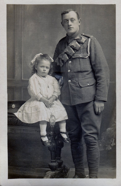

Took me a while but I managed to scan a few. There was more of a spread of studio and non-studio than I thought when I went through them one by one again.
They are all printed on postcards. The ones with soldiers are, I'm pretty sure, form WWI, some are older though as they were printed by the company that existed before Watsons, so nearer 1900.
