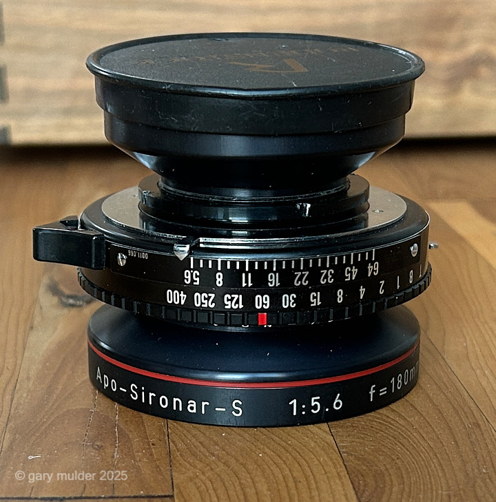

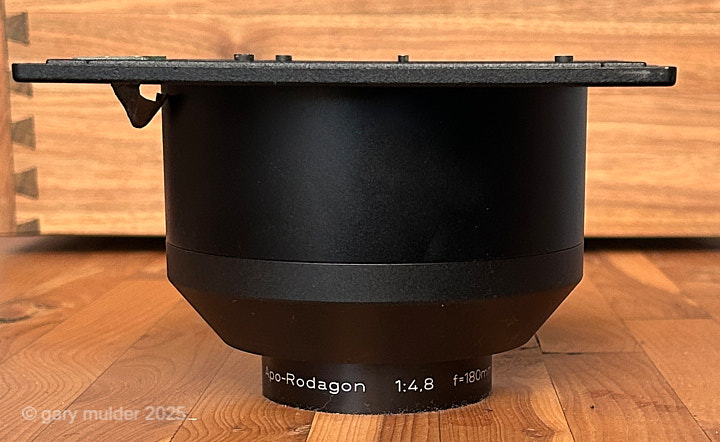

I have a Apo-Sironar-S 1:5,6 f=180mm and a Apo-Rodagon 1:4,8 f=180mm The Apo-Rodagon outperforms the Apo-Sironar-S making still life on 4x5” hands down. My Apo-Rodagon is on a Sinar DB board. Maybe hard to find on a normal copal.
Thanks Gary. Good to know that.

I think all 180mm lenses with the same coverage will perform more or less the same. The variation between will likely be more. The Apo-Rodagon 1:4.8 f=180mm is an enlarger lens. And as mentioned previously in this thread enlarger lenses will do a better job with still live.

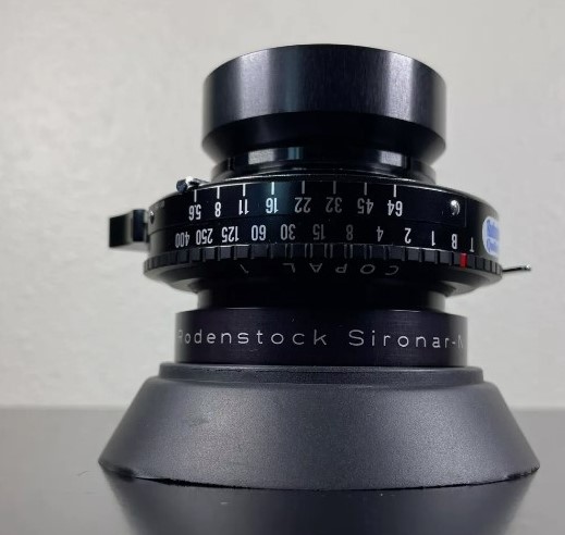

Thanks. The N model was before the S? ( I attached the N model)
I didn't find any "Apo-Rodagon" lens from Rodenstock on the net. Are you sure that's the correct name?
Did you mean it outperforms another Rodagon lens or the Schneider Kreuznach Apo Symmar MC 180mm f/5.6?
Yes. the N model was before the S
