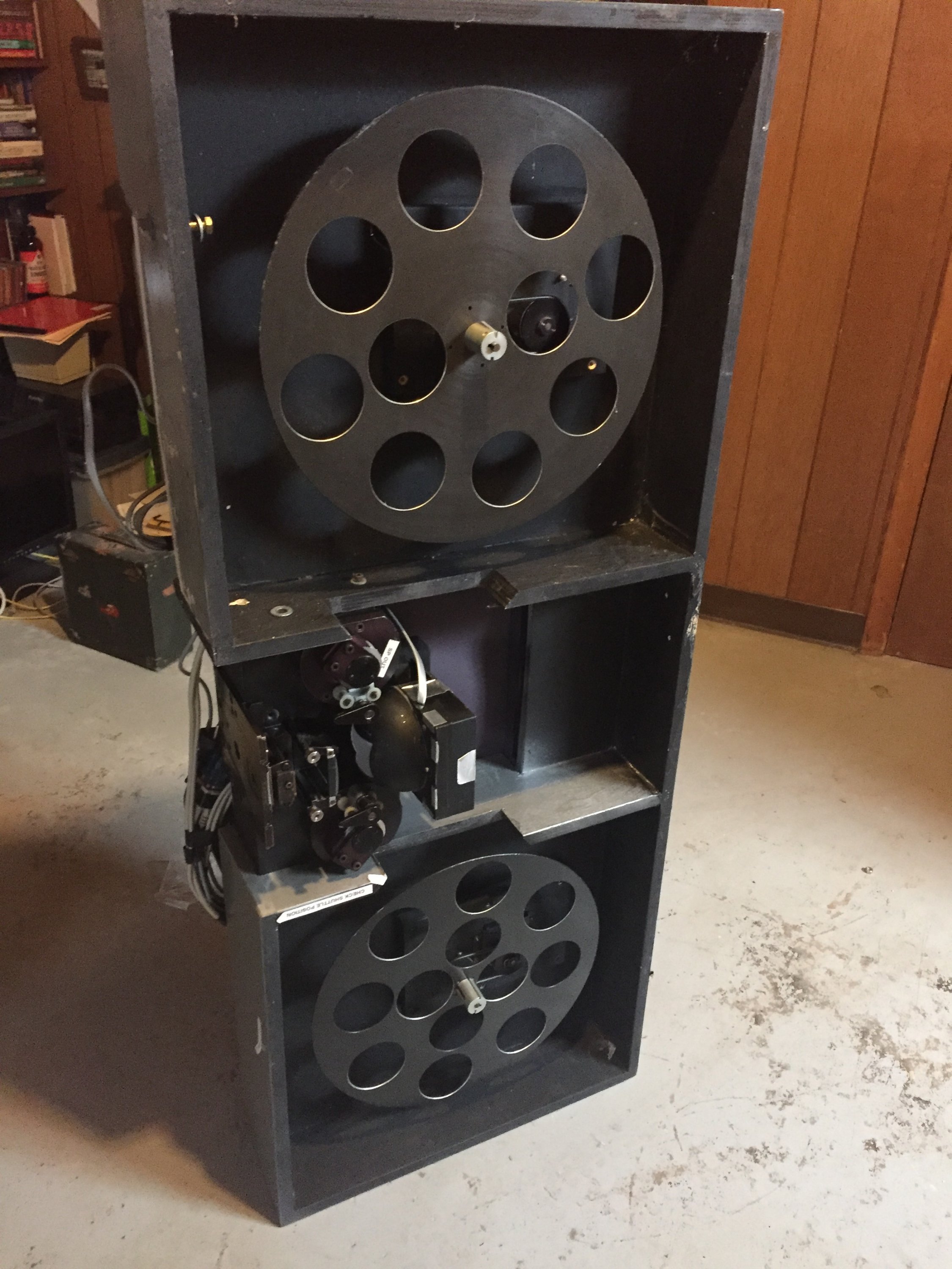

I built a 3K 16/35mm scanner for about $40K about a decade ago. It scanned at the rate of 1 frame per 1.5 seconds. Nightmare to setup and run; it took years off my life.... Here is what is left of it...
You got to be a genius / mechanical wizard to build them things. This GD film biz is a nightmare unless you got $ and I mean tons of $$$.
