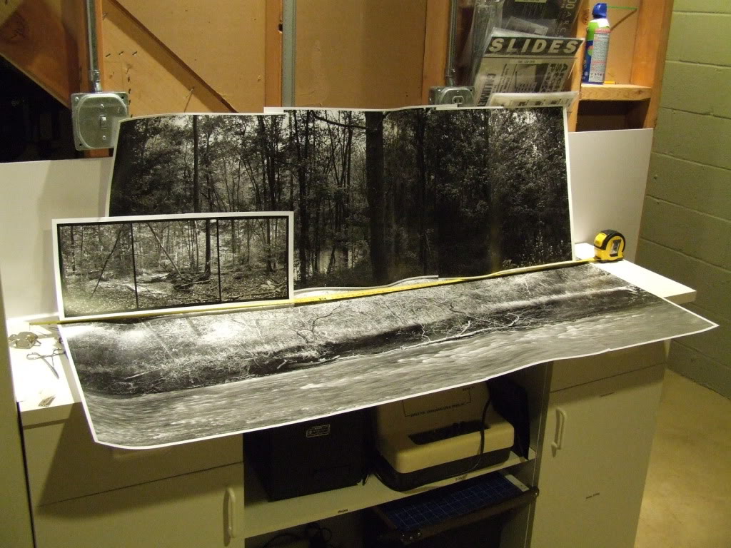

That sounds like a fantastic project. The cropped format will be a great match for paper roll spread out lengthwise. My enlarger is designed to project on to a paper roll that hangs down so you can splice multiple 55" strips together.
This lower print (cropped 8x10 negative) in this picture is a mock-up using five 16x20 sheets. For the 'real' one I'd use 5 strips of the paper roll. Still working on ways to process the long sheets, so at this point I just have the 'little' mock up.
Keep us updated with your project.
