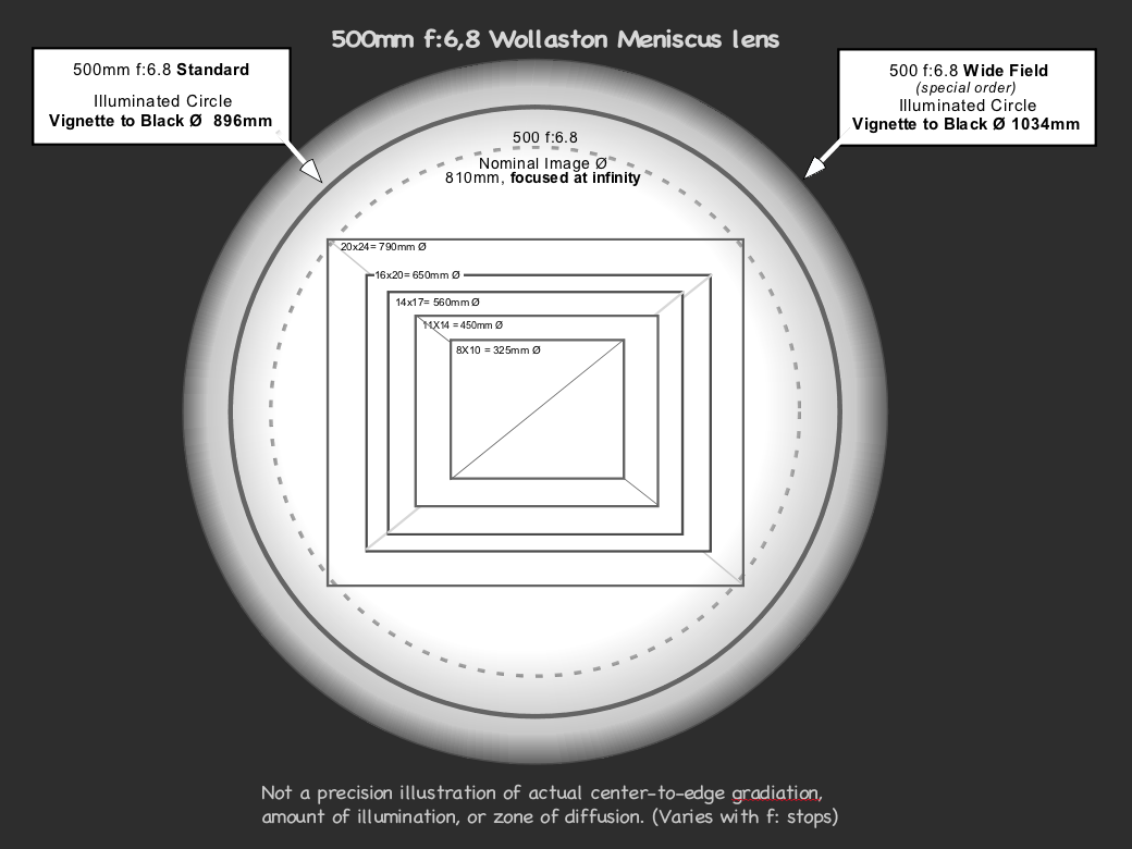

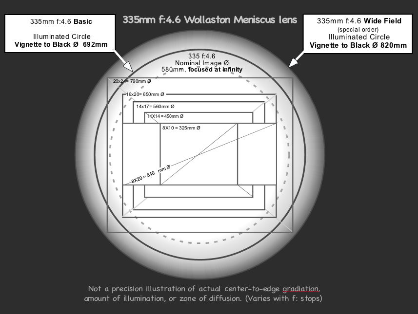

If a soft focus meniscus lens is of interest, my 500mm f6.8 or my 335mm 4.2 Wollaston can add the "character"of a historic lens to your style...
Here are their image circles...
Reinhold
