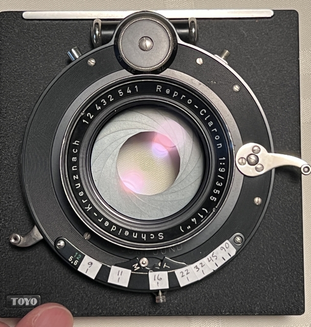

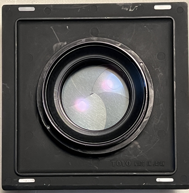

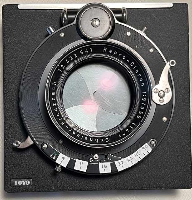

I got this very nice Repro-Claron in a barrel and put it into a Compound III-7 shutter that previously housed a 240mm Convertible Symmar; the cells fit the shutter with no modification. The glass is clean and clear with no obvious defects but have never used it so have no sample negatives or finished images. My artisanal hand-marked aperture scale is within 1/3 stop as verified with my QLM-calibrated Pentax digital spotmeter. It's mounted on a Toyo 110mm lens board. It operates quite repeatably on all speeds but the speeds are off according to a Calumet tester. The approximate speeds I measured at f/22 are:

You need to be careful how you operate a Compound shutter, they're easy to destroy.

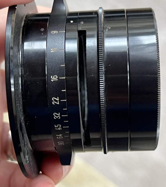

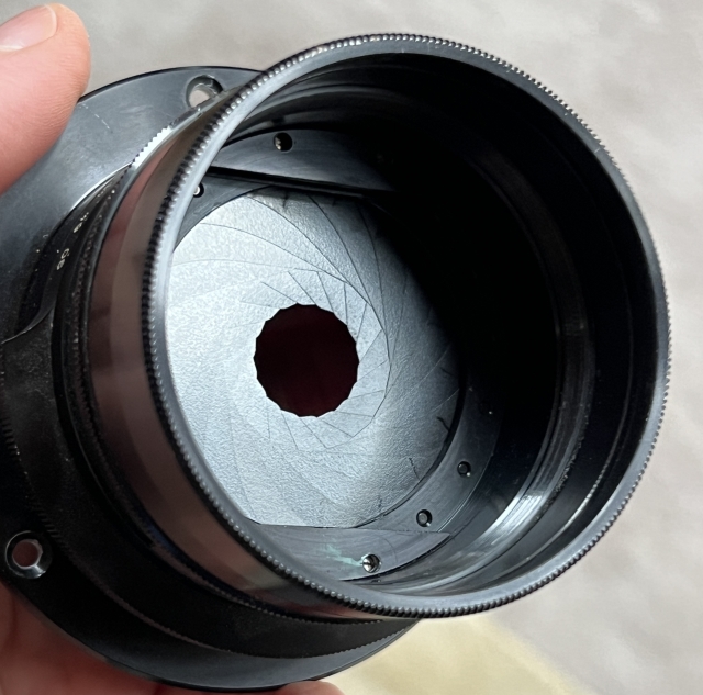

The Repro-Clarons were Schneider's competition to the Goerz Red Dot Artar and I'm told by a reliable friend who's used one that the 14" will cover 8x10 at infinity and stopped down though I've never tried it myself. It takes a 55mm front filter, 57mm caps front and rear, and weighs 482 grams (1 lb 1 oz) in the shutter (the lens board adds a bit more) according to my kitchen scale. In addition to the lens board it comes with one generic lens cap and the retaining ring, as well as the original barrel.
The third picture shows the shutter in mid-operation when set to 1 second. It took a couple of tries...
