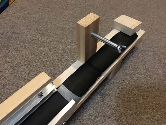

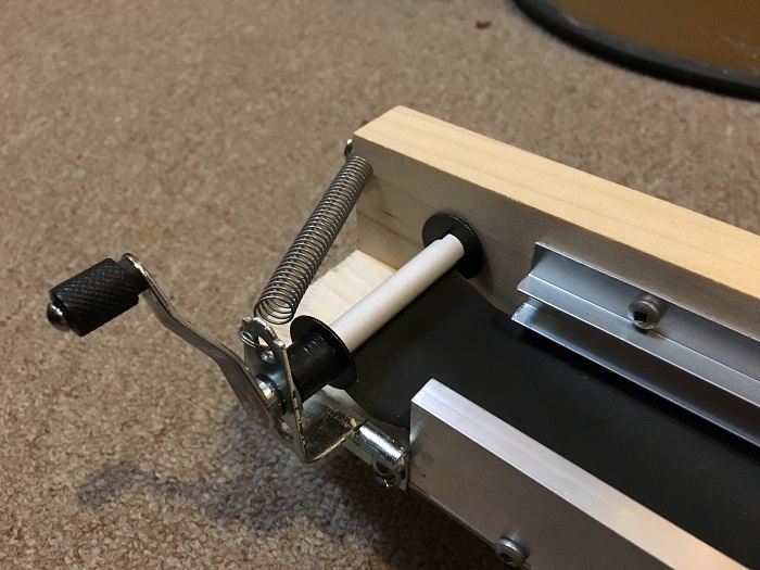

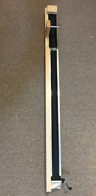

I spool my own from bulk rolls. I have bulk Ilford HP5+ that I got from the Ilford ULF sale and a bulk roll of Konica 160 color film that I purchased several years ago. I built a contraption for rolling the film. It keeps the film lined up and puts the tape in the right spot. I re-use old backing paper or cut down and re-mark 120 backing paper.
The contraption is set up to the length of the film. It has rails that keep the film separated from the backing paper. I first set up the backing paper so that it's ready to receive the end of the film at the spool end and the start of the film at the other end. The backing paper is in the lower rail. I roll out the film in the upper rail and run it just into the spool. I cut the other end using the rails as a guide. I then attach tape to the film, the rails keep it from attaching to the backing paper until it is in the spool.
One tip, if you're doing it by hand the hard part is keeping the film perfectly parallel to the backing paper when you start. If it's off just a little at the start it will be off much more at the other end. That's why I built this contraption in the first place, to keep everything lined up. You can put a bit of tape on the backing paper where you want the end of the film to be when you start rolling. Put the tape on the film but don't attach it to the backing paper until it's rolled up into the spool.
