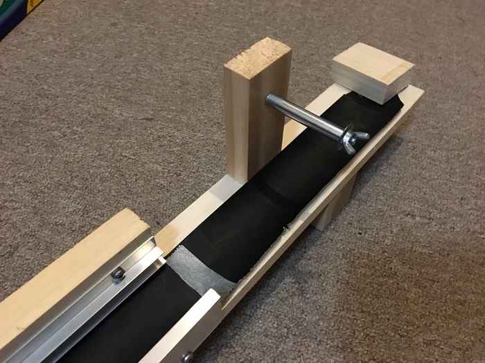

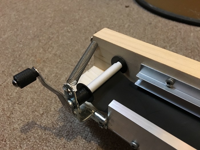

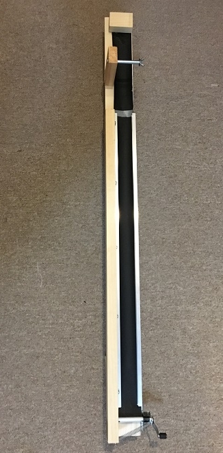

Blee, I started out doing it similar to your method, but I found that sometimes I had problems getting the film to line up perfectly. This led to making a jig to simplify the process.
I built this to solve a few of the problems I had with spooling 127 film by hand or at least to make it a little easier.
These problems included the following:
- Getting the film started perfectly strait with the backing paper.
- Cutting the film to the proper length.
- Finding the proper location to start spooling the film.
- Taping the film.
The rails are aluminum with two slots, they're left over from a project, I made some sliding storage doors for my wife. The rails are cut to the required length of the 127 film. The first thing I do, in the light, is run the backing paper from the spool down to the end of the board in the bottom part of the rail. the distance from where the rails end to the end of the board is the proper distance for the leader. I could do this in the dark but it's easier in the light, need to be careful about damaging the backing paper. You can see in the photos below how the paper can get buggered up after being handled a lot. That was some old ReraPan paper I was using to get my measurements.
In the dark I run the film down the top part of the rail until I get to the end. Since there is separation from the paper it's easy to cut the film square by squaring the scissors with the end of the rails. I then put a pre-cut piece of tape on the film using the rails as a guide to help center it. I never put tape all the way to either side of the film, this helps trigger the mechanism that detects the start of the film in the Baby Rolleiflex. It's a small hook that is tripped when it catches on the start of the film. At this point the tape is only attached to the film, not the backing paper.
The next step is to crank the film onto the spool. I first feed the film up to the spool then put some pressure on the paper with my fingers to pinch the film between the backing paper. Then all I have to do is crank it on, when it gets to the end of the film the tape sticks itself to the paper in the correct location.

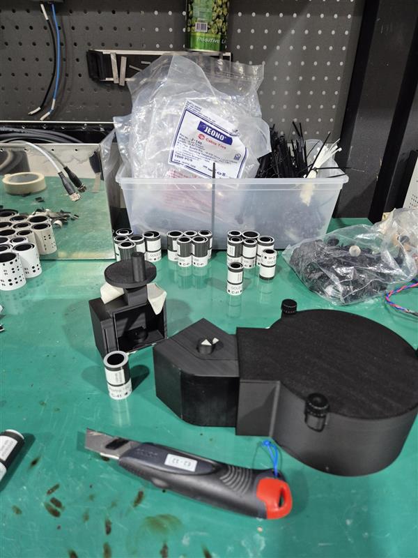

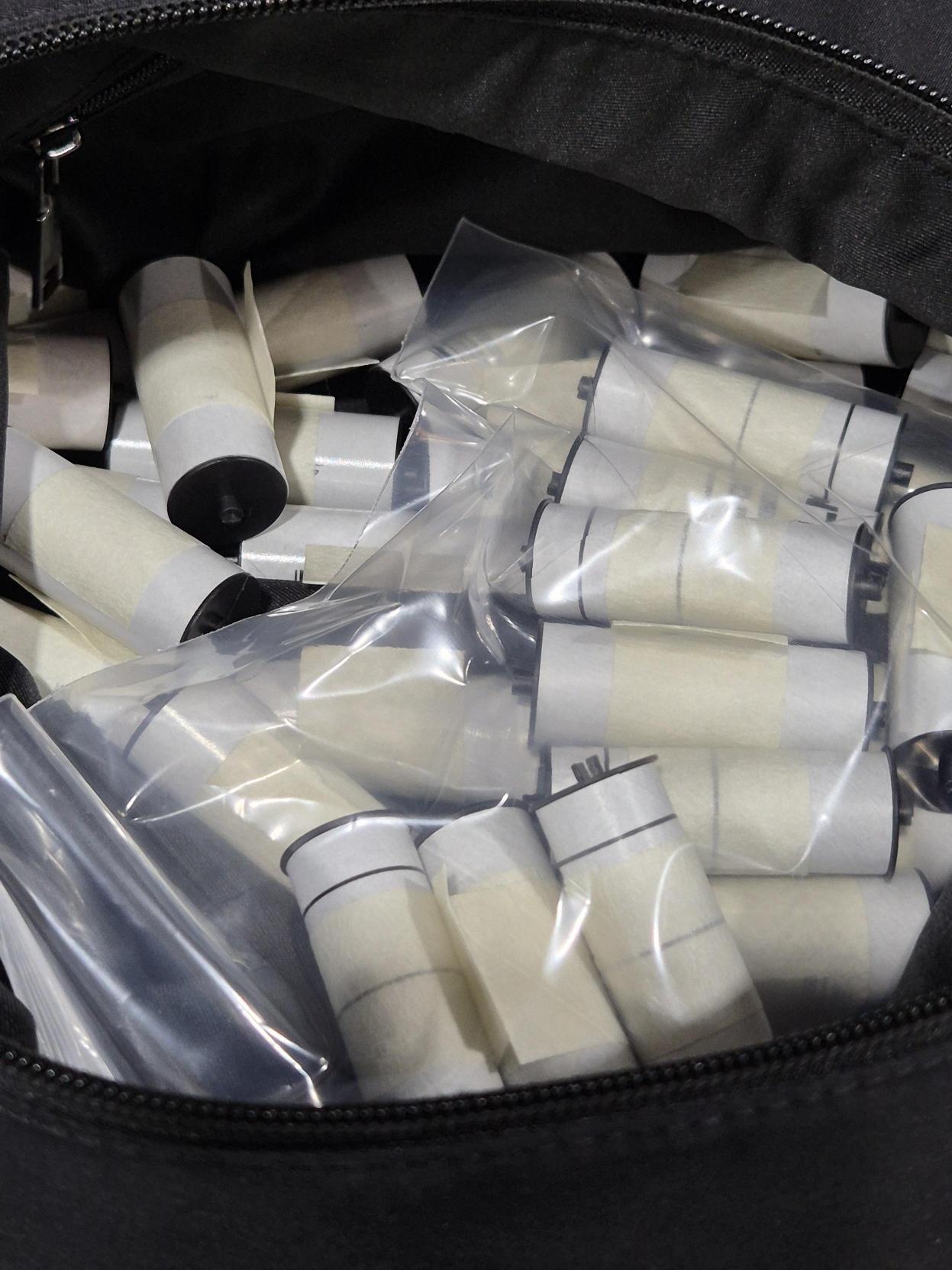

I’m using a daylight loader that I built myself.
With the Rolleiflex Baby, the first frame gets burned, but the rest are completely fine.
