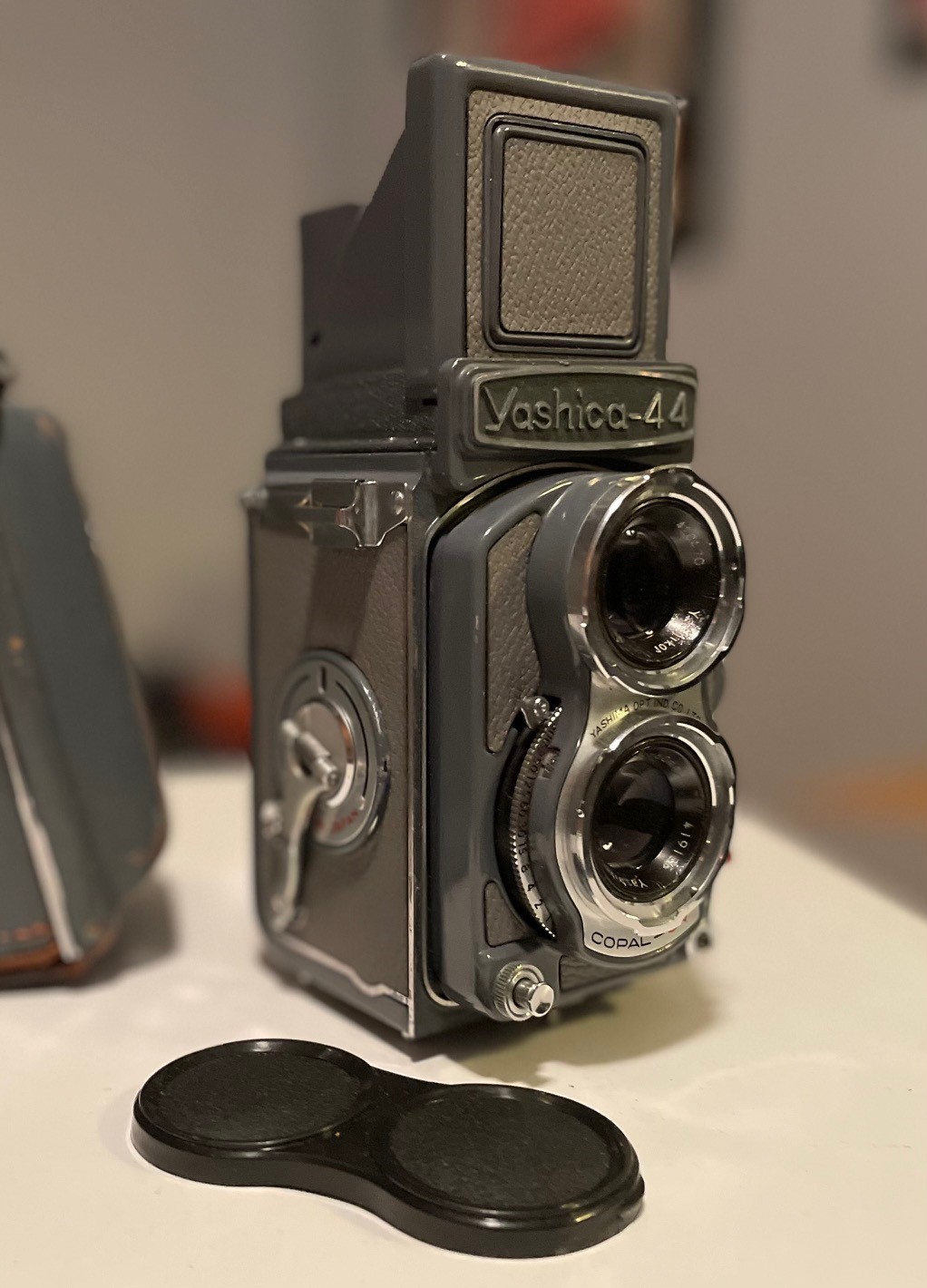

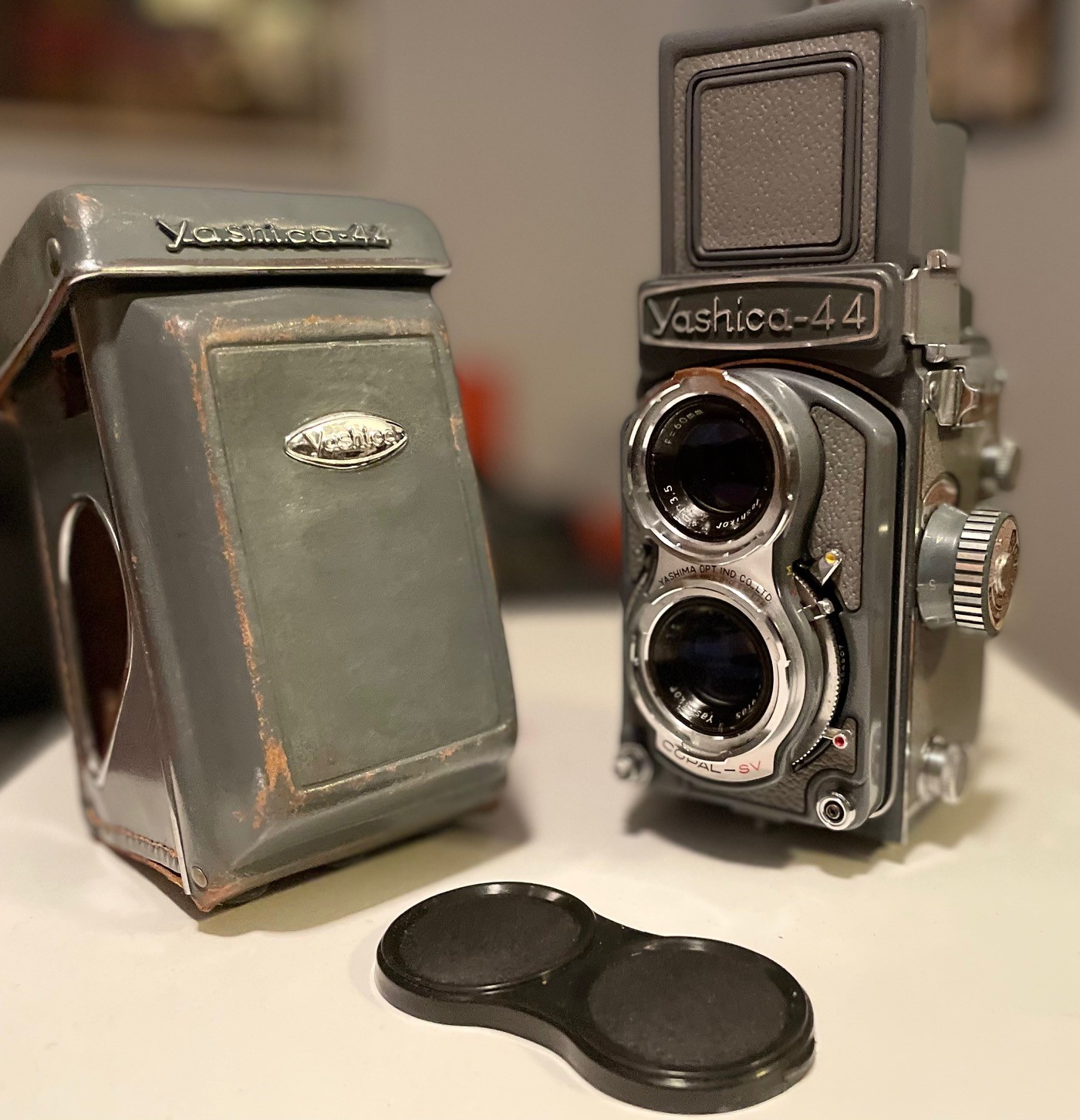

Got the new leather on my Yashica 44.
Looks great! I have two Yashica 44's and they are fun to use. One is very clean and I just replaced the leatherette on it. I use it for shooting 127. The other is a bit worn looking, and its been modified to shoot 35mm film (the roller on the feed side has been removed so the 35mm canister fits neatly in there).

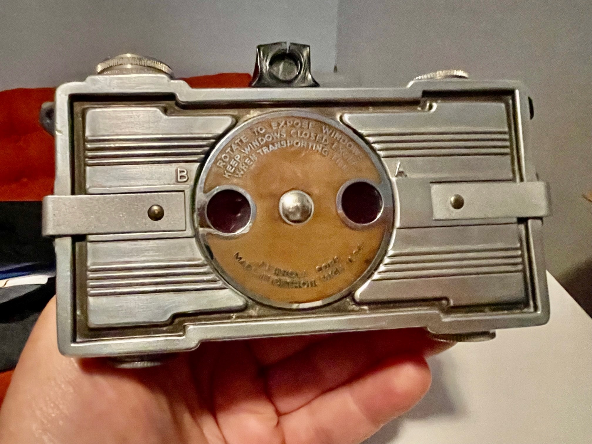

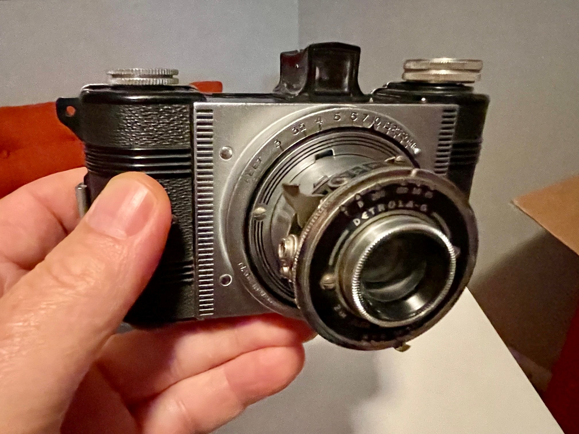

Here's a little less common 127 camera: the Detrola-G, bakelite and aluminum body camera with a 2 inch Ilex Anastigmat f4.5 lens that pops out of the body. It also has an unusual snap on back with two red windows for frame number alignment, although I am uncertain why it would need TWO windows.
The camera was made in Detroit, Michigan sometime between 1939 and 1940 according to Camera-wiki.

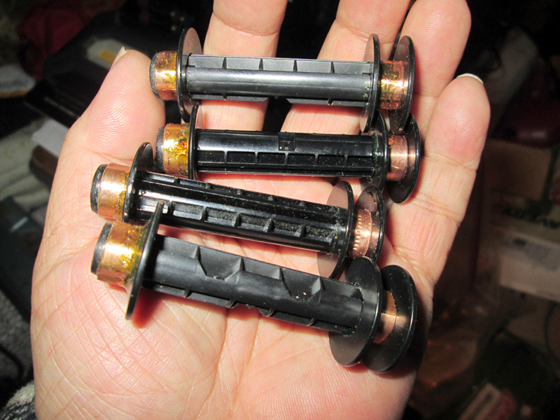

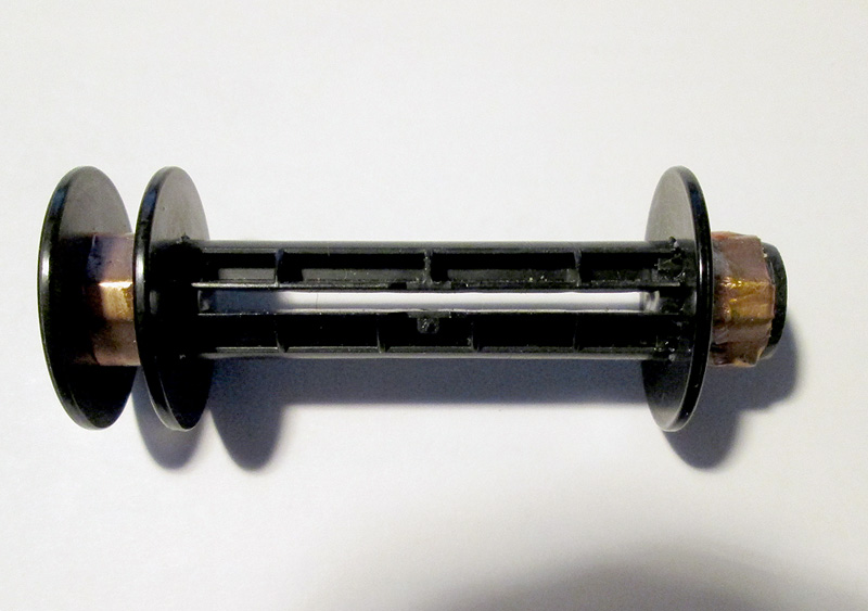

I don't have the backing paper problem to deal with because I mainly want to shoot 46mm film in my Pentax 67-ii. I need a 46mm bulk film loader to roll the film onto the reels made out of 120/220 film reels. I therefore have to attach paper leader and trailer to the film. The result will be like 220 film rolls with 46mm film in them. I can roll any length of the film as long as it is shorter than the length of 220 film. With such film rolls I can shoot not so wide panos without cropping 120/220 films. I am a big fan of such pano pics. here is the custom reels I made, it took 3 120/220 reels to make one:
Because it's a 3x4, and the center framing track on 127 is for 4x6.5.

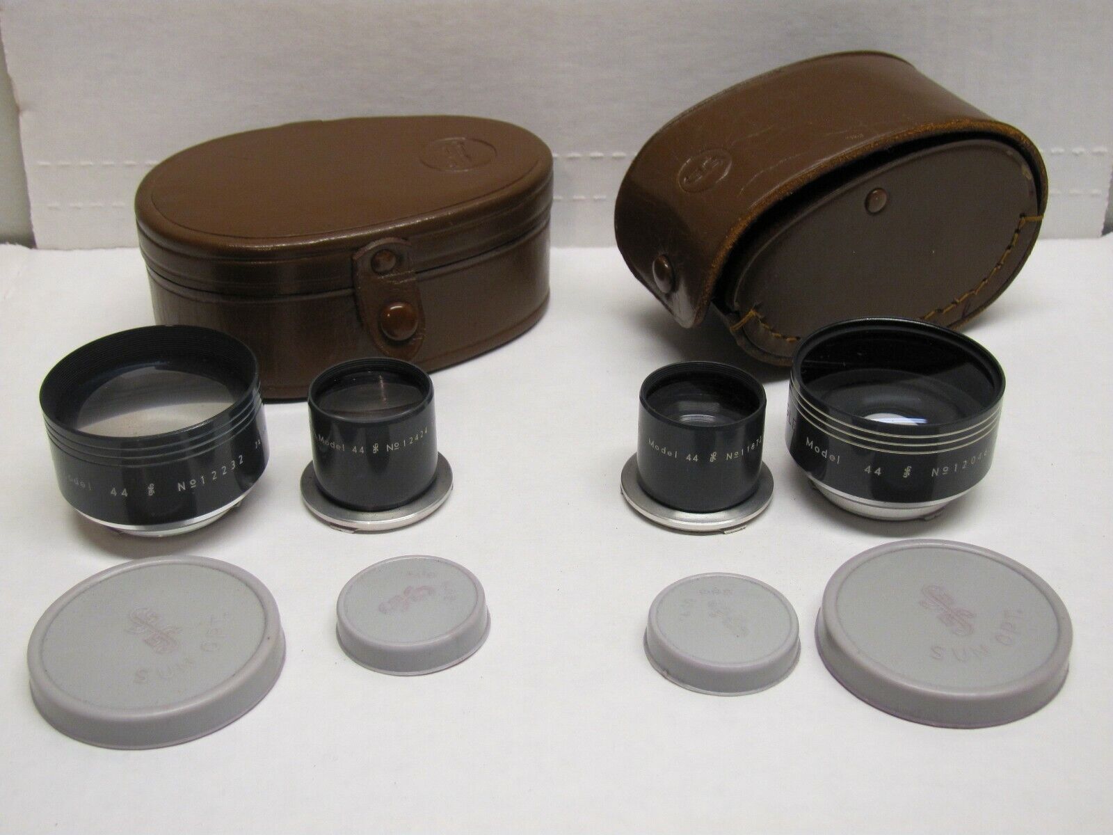

Just ordered a wide angle and telephoto set of auxiliary lenses for my Yashica 44. It should be interesting, but I don't have real high hopes for optical performance, as I also have the same style set for my Yashicamat 124G and they are not real good performers.
But what the heck, the price was very reasonable and if the wide angle attachment is fairly good, I will probably leave it attached to the 44. One thing that bugs me about the Yashica 44 is the 60mm lens; it seems much too long for the format as a "normal" lens, no matter the math.
I wasn't even really aware these were manufactured until I ran across a mention of the Sun Model 44 Auxiliary Lens set on a webpage devoted to Yashica TLRs.

Now I have to find these things. They come as a set of two?
Only if the seller bought both sets! Typically, they come as a set of taking and viewing lenses for either wide angle or telephoto.
(borrowed from the auction I won)
Yeah, I meant taking and viewing lens.
I just loaded up a few rolls of Aviphot 200 onto my hacked out 127 reels. I have no AC in my darkroom and it's located in the attic. Not fun.
