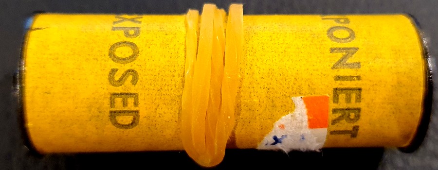

Hello everyone!
A friend of mine asked me to develop this film for him; it's a colour film negative, 127 format, CNS2, no idea about how old is it, when it was shot, how was it kept, nothing at all basically. Colour processing is out of question, for a number of reasons. The film is very old stock, but the photographs on it were taken recently with a KVP camera. I would assume the film is from 60s - 70s, just to be at about the half of the period it was on the market, I guess.
Now, I had my fair share of processing colour film (various formats) as BW, but at least I knew what was their story. No idea with this one, so I am asking the more knowledgeable community here to try and assist me with this, if possible. Perhaps someone recognize the roll as some type or other?
As developers go, I have quite a good selection. I'm leaning towards Rodinal (high dilution) or HC110/B, but of course other may differ.
Thank you in advance !

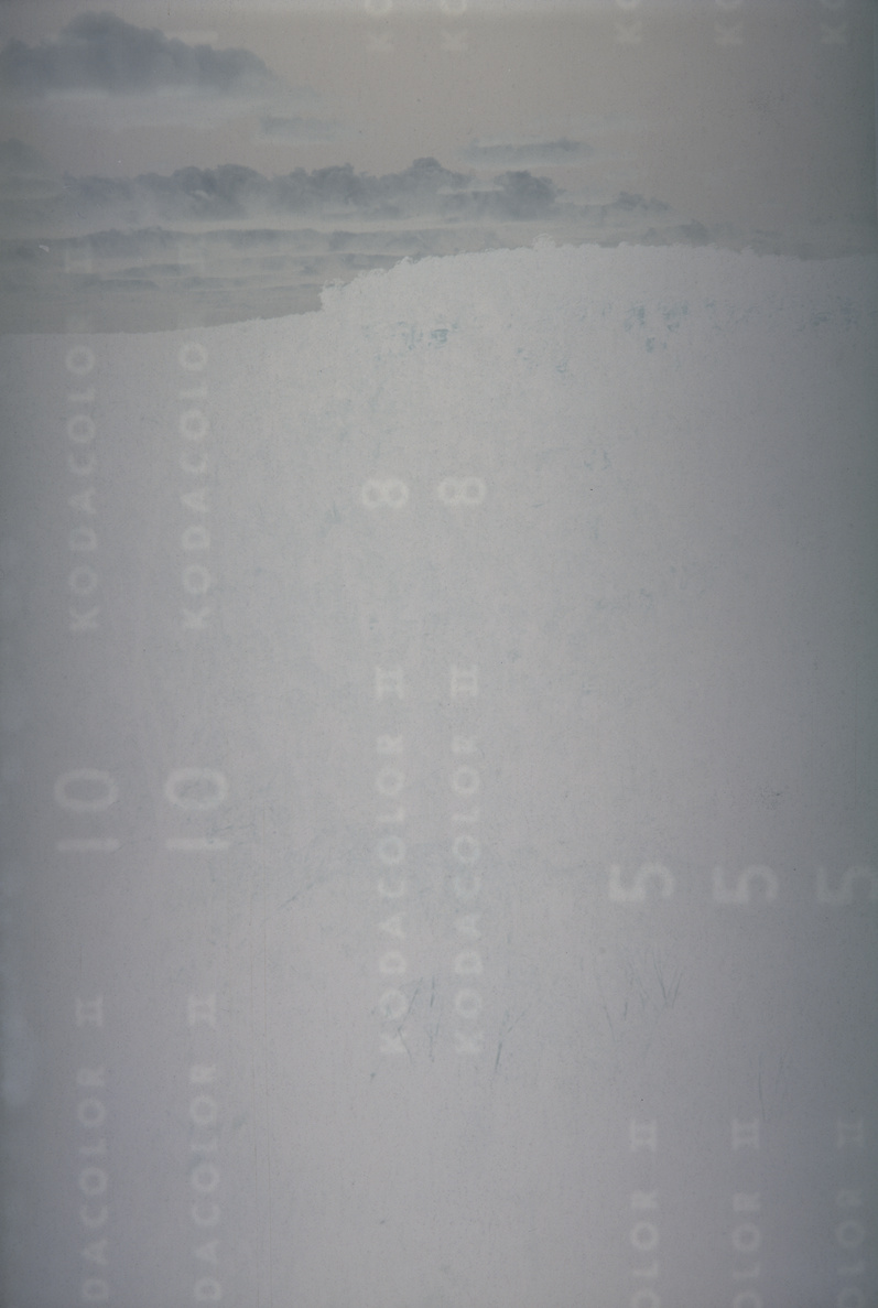

I tried exactly that with very old Kodacolor-II (C-41) film. Normal C-41 color development with BLIX replaced by Ilford Rapid Fixer for 7 minutes. The film was exposed at around EI40 (+1 stop). Basically, if it is gone, it is gone!
Digital camera scan of the negative with minimal processing (left) and conversion using Darktable Negadoctor (right).

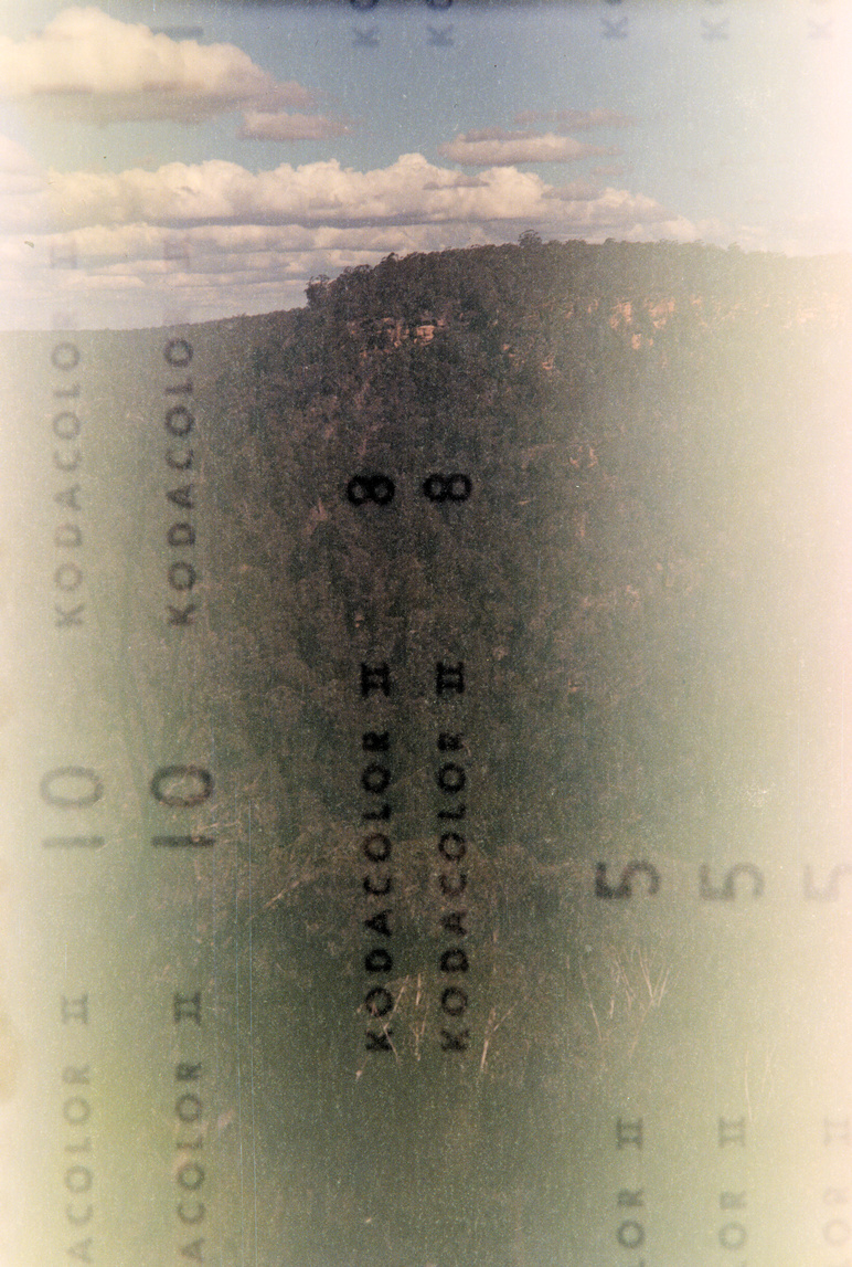

FWIW, and this was my first attempt at such, I just developed an old roll of Kodacolor II in 620 format that was probably exposed in the early 80s. It came with an old camera I just bought. I used Legacy L110 at Dilution B at 75degF (ambient temp). I used a 2min presoak in plain water, then developed for 7 minutes with agitation every minute for 5 seconds. I used plain water as my stop bath and Ilford Rapid Fixer at 4:1 for the fixing stage.
What came out looks overdeveloped, but I can see images on about half the frames (with the other half being blank (possibly accidentally exposed because the roll wasn't tight when I got it). I have a 2nd roll I'm going to try at Dilution H for longer and with less agitation to see if it works any better. This is all new to me and the outcome isn't critical, so I'm just kind of winging it.
