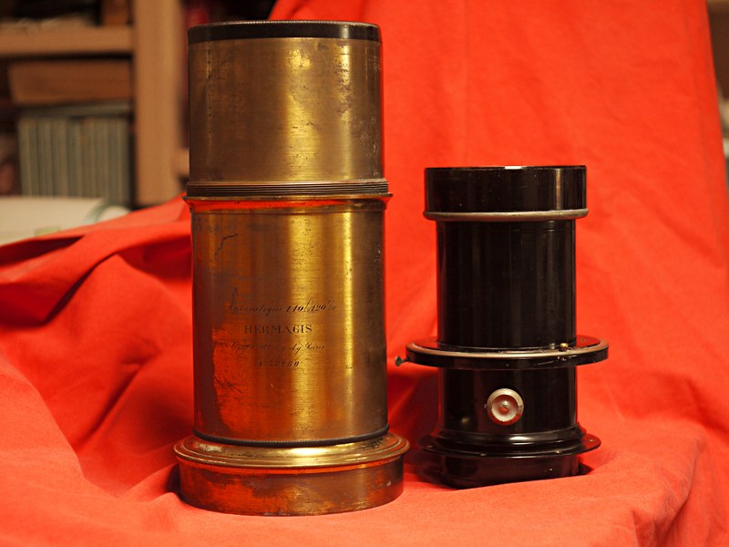

I have acquired a Hermagis Aplanatique that is 1200mm or 47 inch focal length. Other than turning my living room into a camera obscura, what format would this cover, if they even made film larger than 20x24? I'm roughly guessing it would cover 40x40?
An Aplanat is basically a Rapid Rectilinear, if that is what this lens is it would cover like most any R-R. NICE find! I'm envious!

This is something you don't see often. Something I'd like to try out. How about renting it out? If it could fit on an 8" board I'd certainly put down a deposit to try it out.
I don't think I'll rent it, but I may sell it outright one day. It would fit on a 9" board.
A couple pics, I dispensed with the usual 35mm film roll, here's a 13" Vitax for scale:

well--10" boards is do-able too--just not on the deardorff studio (very stout for the very stout lens). Too bad you don't want to rent--I'll have to wait until you tire of it before I get a crack at it. But if you ever get the buyer's remorse, do contact me so that I can cure you of that and maybe empathize one day.
A lens of that focal length might make a good astronomical telescope objective. A variation of the traditional petzval design is used on some professional grade telescope objectives, and a giant RR might work also.

Thanks for all the great ideas! I like telescope best, but don't know how to make one. I assume the little viewer lens pieces do something to make the image focus on your eye. Or perhaps I'll do a giant paper negative, I do have some large paper. Don't know how to coat paper myself to make my own. And I wouldn't want to make a 40x47" wetplate....right now.
Simple as dirt. Place a 5x achromatic loupe at the focal point of the lens and you'll have a 23.5x telescope. Use a 10x (1") loupe and you'll get 47x, the focal length of the eypeice lens divided into the objective lens give you the magnification. Of course, you also have two doublets with focal lengths of 96" or so....:smile:
Brilliant! I was just playing with an old optical device I have, with "AO" engraved on it. It has two levers to focus, and I figured it was an American Optical telescope ocular. But I wasn't sure. So I duct taped it onto a big cardboard packing tube, and held it up to the lens. Pointing out the front door, I could see bugs crawling on the fence post up the street! Thanks, I'm going to make this a little more workable with some PVC pipe.....!
