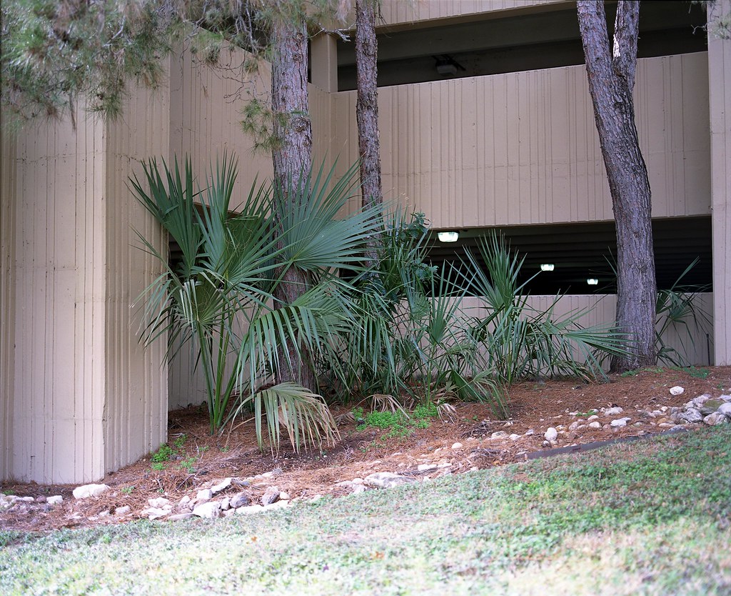

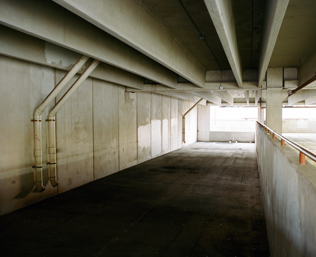

Anyway, in the past two months, I've released the PG 50mm back into the wild, and tried and returned two more K/L 65mm lenses. I've also acquired another two RB67 backs, an RB67 ProSD, and two rotating adapters. My focus is now on the RB67 and the 65K/L, as that lens has the best center sharpness of any MF lens I've ever used. It's noticeably sharper than the PG 50 or 110, the RB 90 C, or the Fujinon S 100 or SW 65. I don't think my CZJ 180 Sonnar is as sharp, even. I'd imagine that the Carl Zeiss lenses for Rollei or Hasselblad cameras are comparable, but I have a preference for the 6x7 format.
But it has a definite flaw. The left edge (and especially the bottom left corner) absolutely falls down compared to the rest of the image. I've tried changing every other possible equipment factor (camera body, film back, rotating adapter), multiple rolls of film, and different scenes. Some examples:
Even stopped down a little, you can tell:
Two more 65K/L lenses show very similar results regarding field curvature on the left side, and incongruent corner sharpness:
I wonder if every 65K/L is like this. It seems like trying three different copies would lead most folks to conclude that the majority of these lenses are probably saddled with this issue.
Another thing to note is that the first copy of the lens that I bought was by far the sharpest in the center. It also had slightly worse left edge/corner performance than the other two.

This is what I think. The commonality of left side softness between three different lenses would tend to support a film flatness issue, as it's unlikely (I think?) that three different copies would display the same optical flaw.
Of course, I've also gone through three different backs. One second generation (Pro-S) and two third (Pro-SD). There are a lot of moving parts in the RB67. The rotating adapters could get out of alignment, too, I suppose, but I've tried three different copies of that piece as well. The last two 'test rolls' I shot were all completed within 20 minutes, so it's not the film getting creased..
My old Rolleiflex SLX I got in the early 1980s had notorious film bulge. Diagnosis on the negatives was difficult, because it would come and go form frame to frame. I nailed the diagnosis by examination of film in the film gate with no lens and the mirror up. If I took a pencil and poked the film in the film gate and if it dimpled, the meant it was not flat against the pressure plate. My 6008i is much better in this regard.
I keep an old blank exposed roll of AristaEDU around for testing just this sort of thing..
Doing the same test as you describe, and everything is solid. No flex, and no dimpling, on any corner.
Edit: I can't help but always go back to wondering about the floating element in this lens. Like the Distagon FLE (I think?), the Mamiya 65K/L has a manually-adjusted 'close-range correction' element in it's own helical. The rest of the lens focuses as a block on a rack-and-pinion. Maybe there's a common defect that occurs in the floating element adjustment mechanics as the lubricant gets old or something. Maybe it's a near-universal flaw that never manifested during the years when this model of lens was still relatively new. There's another 'near mint' copy of this lens up for sale in camera hell, but I feel like I probably have a problem if I'm willing to roll the dice on yet another copy of this thing...
But it would still be cheaper than ditching the system and springing for a 500CM + 50mm Distagon, and I really feel that's the route I would have to go to get any MF wide that's as sharp (in the majority of the frame, at least) as this lens.

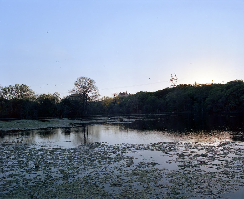

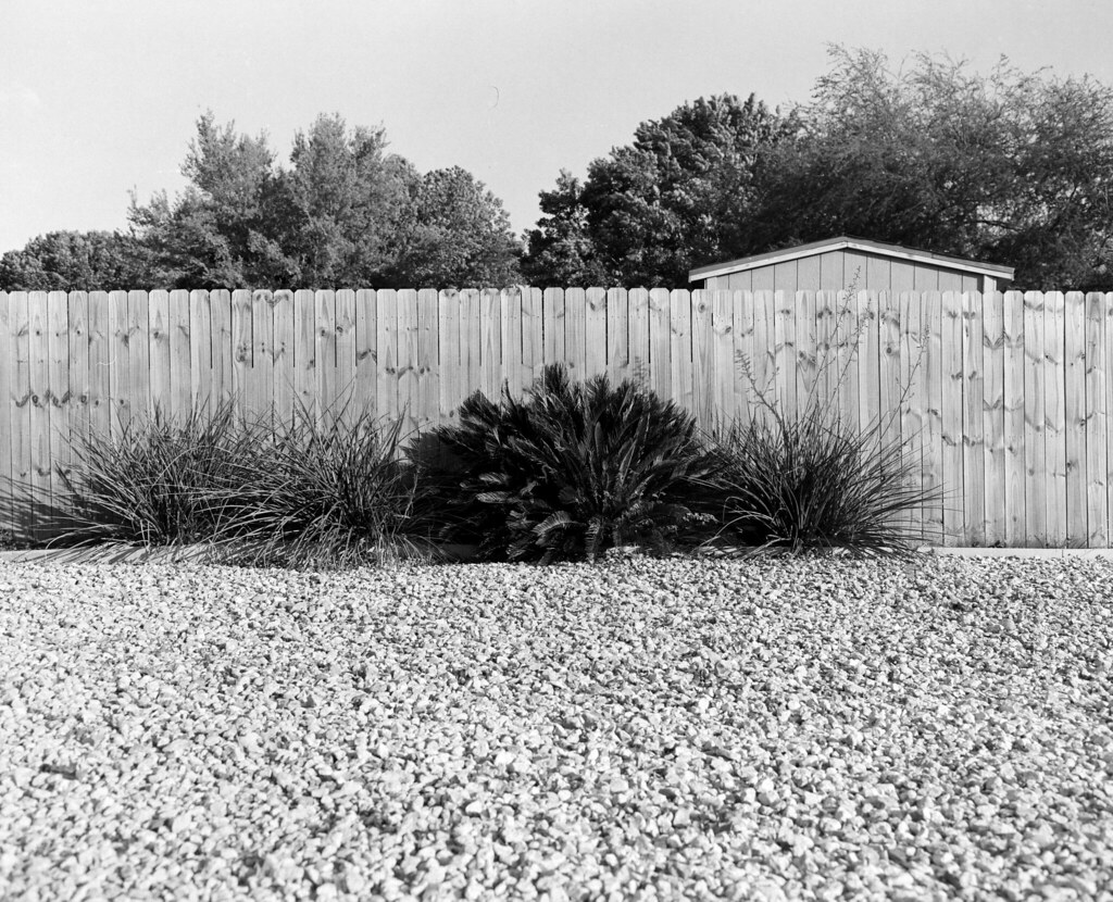

It's not the scanner:
(this is the second copy of the 65mm)
Here's a commercial lab scan showing the same incongruence between left and right bottom corners. This is the first copy of the 65mm, at f/6.7.
Here's one from the epson V550 on my desk. This is the 90mm C, wide open. Same camera and back as above. Unsharp around the corners, but the direction of the 'smear' and the relative level of blur is the same on both sides. This performance is fine to me. I don't see any flaws, because this is consistent edge vs edge.
Man i really don´t give damn about your lenses nor your lack of sharpness all over or just in a corner
Ask yourself why you keep posting in light of this realization. And here's a lateral thought: why don't you slide over to somewhere else! I would appreciate it.
Edit: I guess at this point, maybe someone else who has this lens (65K/L), who *doesn't* have this problem, will post a scan from a shot taken at wider aperture, and show me that not all the 65K/L's are like this. I've offered my evidence (not that anything can be proven on the internet), and shared my expericene. My conclusion, after shooting with all three copies of the 65K/L that I've run across, is that most of the copies must be congenitally flawed with bad performance on the left side.

All the other MF lenses I use (110/4 PG, 90mm C, 80/2.8 Arsat C, 180/2.8 CZJ Sonnar) produce fine results with the same scanning methods I've used to produce some of the samples posted in this thread, but this series of 65mm lenses I have tried has poor corner sharpness in the bottom left.
I'm still just so pissed off!!! I have to keep posting here!
I'm asking you not to post. Obviously, you have all the power and choice to continue to waste your time posting in this thread. I'm simply asking.
I won't address any of the content of your posts. I'm here to declare that scanners suck!
much less than worthless.
Oh man.
Since you can't jack into my brain like Johnny Mnemonic and literally see what I am seeing when I look at the negs in real life on a light table with a loupe, you're just going to have to take my word for it.
Earlier in this thread, people where making fun of me for caring about unsharp corners. They said it doesn't matter. That's lame, but it's a valid response. You can say that I must not be doing something right, that it's not the negatives that show a flaw, but the method of digitization must be the problem. I know this is not the case. You can continue to argue in bad faith, but I ask everyone else who happens to come in here:
Please offer constructive advice. Believe that the results I've posted here are accurate representations of the appearance of the negatives in reality. Don't let these guys dissuade you from offering comments based on relevant experiential knowledge (like, have you used this lens, or this camera system? Have you experienced anything similar to the issue represented in my posts? How about a similar issue when using a different system? How about a discussion of alternative moderate wide angle medium format camera equipment that might be more reliable or better constructed?) Anything but this crap about reproduction methods. Drum scans? I'm not going to throw down the $$ for drum scans of these throwaway test images when my eyes can tell me (and you, reader) everything you need to know.
I'm sure that if I did post drum scans of the same negatives in this thread, posters like Sirius Glass would dismiss it and demand photos from a 24" print, and when I post those, they would casually dismiss that too, and ask for an archival print to be mailed to him to examine. Simple trolling, really. I'm still posting because there are users who will offer discussion in good faith.
I've posted high resolution scans from very precise professional/commercial labs. One was in a post on this very page. Those are conveniently ignored.
Edit: Here's some more stuff to ignore. From Precision Camera in Austin, Texas. They are the most reputable source for scans in my area, and serve a market of professional photographers in two of the largest cities in the state. This was shot with one of my 65K/L's, at f/16. Even stopped down that far, you can see the difference in sharpness between the bottom left and bottom right corners.
... And another one, same lens, same aperture, same source. I would have printed this one, I liked it for some reason. But the obvious distortion of the downspouts in the lower left makes it not worth the time to enlarge. Maybe, if you didn't already understand that this lens had poorer performance on the left side, you wouldn't think too much about the moderate softness of the details in that area of the frame, but it's all I can see, because I know that if the lens had even quality to it's detail rendition across the frame, those elements would be clearer.
