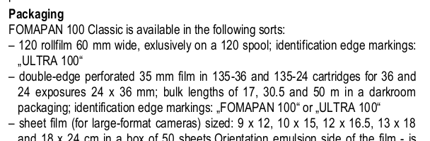

Yet the datasheet for Foma 100 (or 400?) says the film markings will say "ULTRA"... (which is what Arista EDU Ultra film say on the edge markings...)
QED.
Typical community managers that don't know their product in depth...
