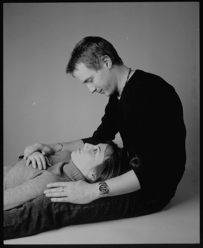

i have scanned a shoot from my contact. I have pushed a little contrast so as to show the problem: brown traces at the top of the image.

Yikes, three 120 rolls in the same can!

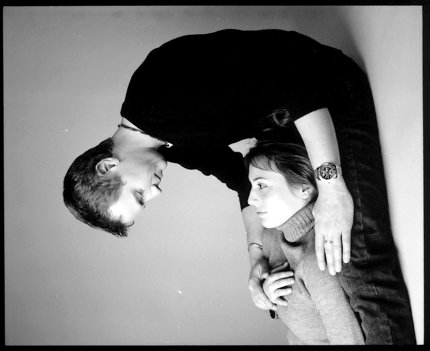

Looks like a contaminated reel or you have used not enough liquid chemicals in the tank. Take notice of the minimum volume of your Paterson tank which is slightly more than you need for a Jobo system.
In the attachment my improved version.

Put it in blix (old RA-4 or C41) and clean it with toothclean tabs afterwards.
I will put some tabs in your packages to Limoges when it's going out and if you want I can sent you some old blix (destination chemical disposal unit) either.

Using a dash of ordinary household bleach in some not too hot water works great as well.

More and better aggitation!
Looks like air-bubbles. More aggitation, and tap the tank on the table. Or use an old Cibachrome motor for constant rotation during the developing - reverse the direction every 60 seconds.

Others have said it looks like air bubbles. This can be a problem even with a well filled tank particularly if there is wetting agent in the developer, there is a tendency for foaming/bubbles which stay at the top edges of the reel.
I've had this problem myself with Paterson tanks, the solution is less vigorous inversion agitation to prevent the foaming. It is known to be a problem and the usual recommendation is gently tapping the tank after each inversion cycle. Take care doing this I once had a tank with 7 35mm films split.

When I first started developing 120, I had a similar problem. In my case, yes, I did use a bit more than the minimum volume of liquid, but I didn't take into account that without a "spacer", there is still room for the reel to move up, if you shake a bit too hard. I'm not 100% sure that was the problem, but after I cut a 35mm film canister into a "ring" to keep the reel in place (can't move higher, where there's no liquid), I haven't had the problem anymore.
(Am I making sense? If not, I can take a picture of my "modification" and put it here. Let me know.)
