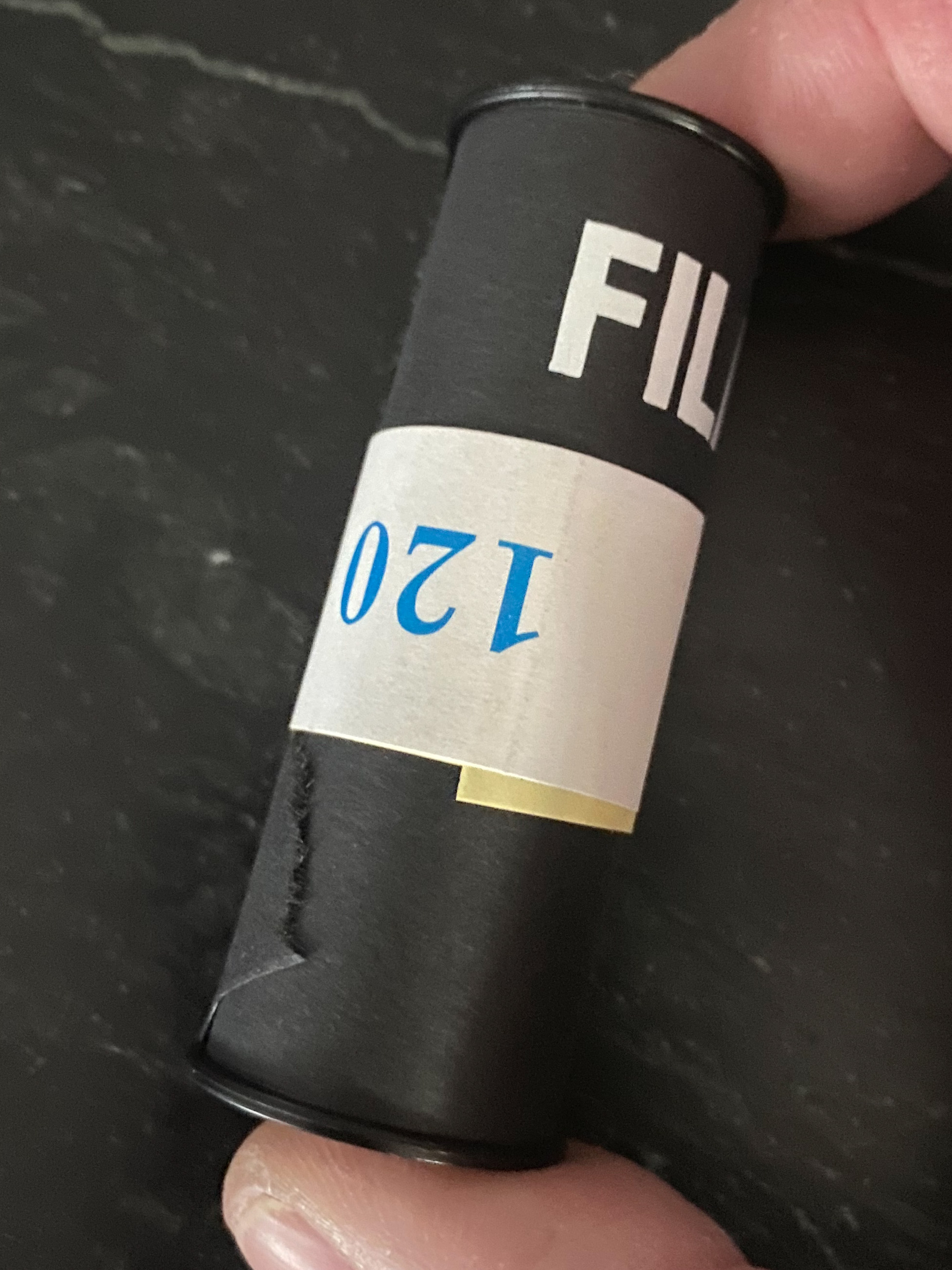

I have this exposed roll of 120 film with no markings on it other than FILM 120 EXPOSED and it’s not like any film I’ve shot before. Anyone seen this style/font on their film? I assume it’s B&W but could use some clues on how to process it.
looks a bit like some of more recent the "shanghai" 120 film. if Gorbas suggestion does not work, that might be a starting point.

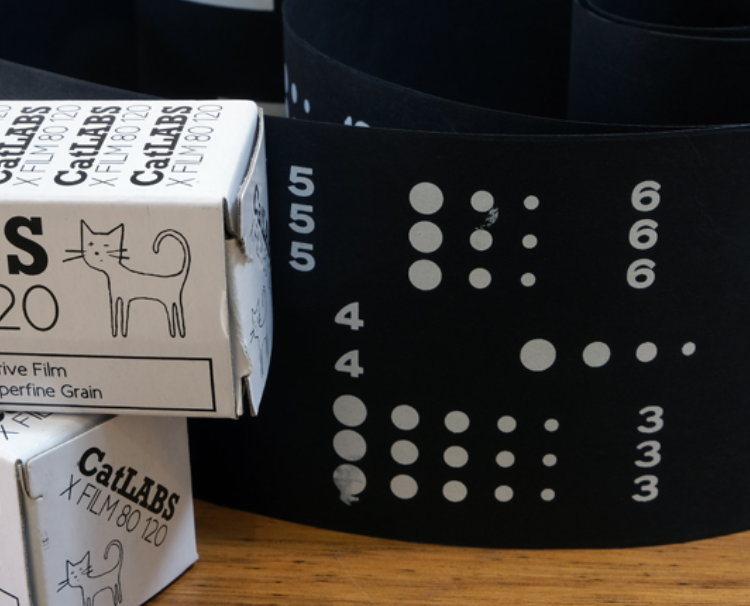

I've just been scouring the internet for images of backing paper and I think this might be right. CatLabs or Shanghai both have this sorta black backing paper best I can tell, the look feels "off brand" to me.
Dev times appear to be the same in Rodinal for Catlabs 80 and Shanghai 100 also. I think this is enough info to take a stab at it.
It’s been a long time since I used it, so my recollection of details is hazy… Bergger used backing paper like that.
I'll never know for sure but I saved the paper after loading it into a tank and it looked exactly like the stuff below, with that same 4 with the curved angle. So I think it was CatLABS. There was also no brand/iso marking at the beginning of the roll or on the foil packaging, which is all I had of it. The base was also rather thin and very very curly, if that's any indication. Films like this make me quite grateful for Ilford products.
I processed per the CatLABS Massive Dev Chart time for Rodinal and the 10' at 1-25 is what I would consider overcooked so it's still a bit of a mystery. I can safely say it was not Bergger Pancro however, as the grain is very fine compared to that film.

That looks like Shanghai GP3 to me.
I have some in 220 ...the paper and the font on the seal are identical.
