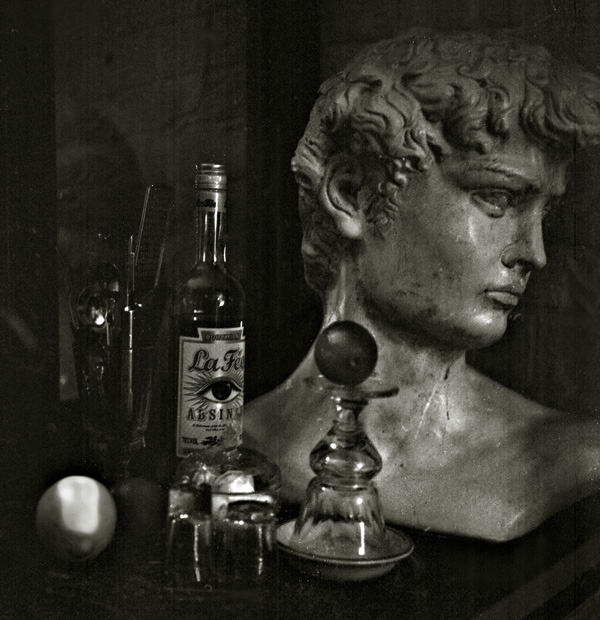

I'm going though the evaluation this winter. Last winter I did some Acros in a darkened room, grey carded at 1/30 at f5,6 with my Mintola spotmeter F set at 6400.
This shot was 1/60 at f5,6 ~ equivalent to EI 12,800
Far from perfect, but for me it's a test, a work in progress.
I semi stand developed in Rodinal 1:100 (5ml in 500ml water) for 20 mins, the negs are a bit thin for conventional printing, they scan OK but next time I'll try 45 mins or even an hour.
I think that this is contentious for some people, but I'm starting to think Rodinal is a sort of chemical HDR, the way it holds back the highlights and lets the shadows 'catch up' contrast can be low as pushing increases it anyhow and low light often gives high contrast shadow/highlights.
Obviously my mind isn't quite made up, but I think the potential is there for more testing...
Regards Mark

Hi Pentaxuser
Regards Mark
PS thanks for your kind words
Mark,
I would say that it is pretty awesome, especially for Acros, and it certainly has potential. Yes, Rodinal IS the magic potion :smile:

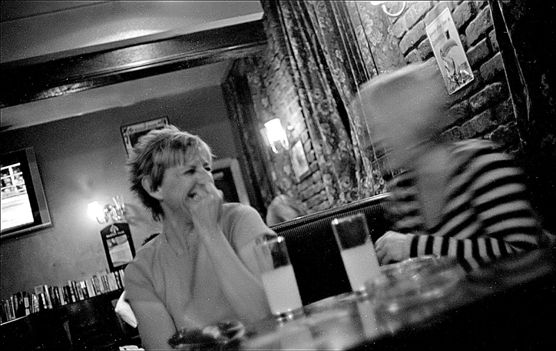

Pretty good if you like a shot that looks like it was seven stops underexposed and manipulated all to hell with a computer to get it to resemble a normal image – which you very well might. I am, of course, teasing, but what would this image mean to us on A.P.U.G. if "the negs are a bit thin for conventional printing, they scan OK" (especially since "a bit thin" is really a stretch; they are a LOT thin)?
Yes they are thin, not really good enough to print, but it was a test! I'm sure I can get better results with longer dev times.
The reason for the test was that earlier I had taken a roll of Acros (by mistake I thought I had Neopan 1600) and exposed it at 1600.
Realising my error I decided to stand develop in Rodinal 1:100 for 25 mins
Now this was taken at night in a very dark pub, about 1/15 sec at f4 from memory (Leica M4P with f3,5 Elmar)
It prints easily.
Gotta go to work now, so I'll post later...
