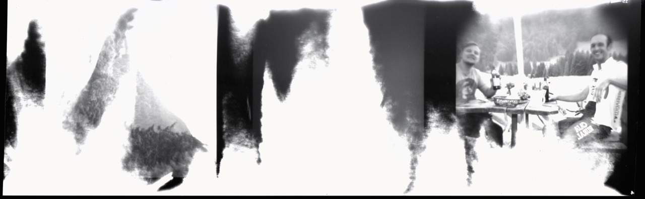

Hey Guys!
I think the exposures below quite speak for themselves!
With a good frequency these "white flames" just about ruin the picture.... does anyone know about this kind of thing?
Flash has been used at a good deal of these pictures (if not all) wich is the only thing I can imagine to be able to do this but somehow I am not entirely convinced!
Looking forward to some of your suggestions wich'll help me with the troubleshooting!
Cheers!
Welcome to Photrio! The scans of the film are kind of (very) bad, but this looks like a light leak. Two causes come to mind: (1) a large light leak in the camera, particularly along the top side. I'm not familiar with the one you used, but check things like foam light seals long the back etc. And another possible cause is (2) the roll of film partly unwinding/not remaining tightly wound during loading or unloading the film.

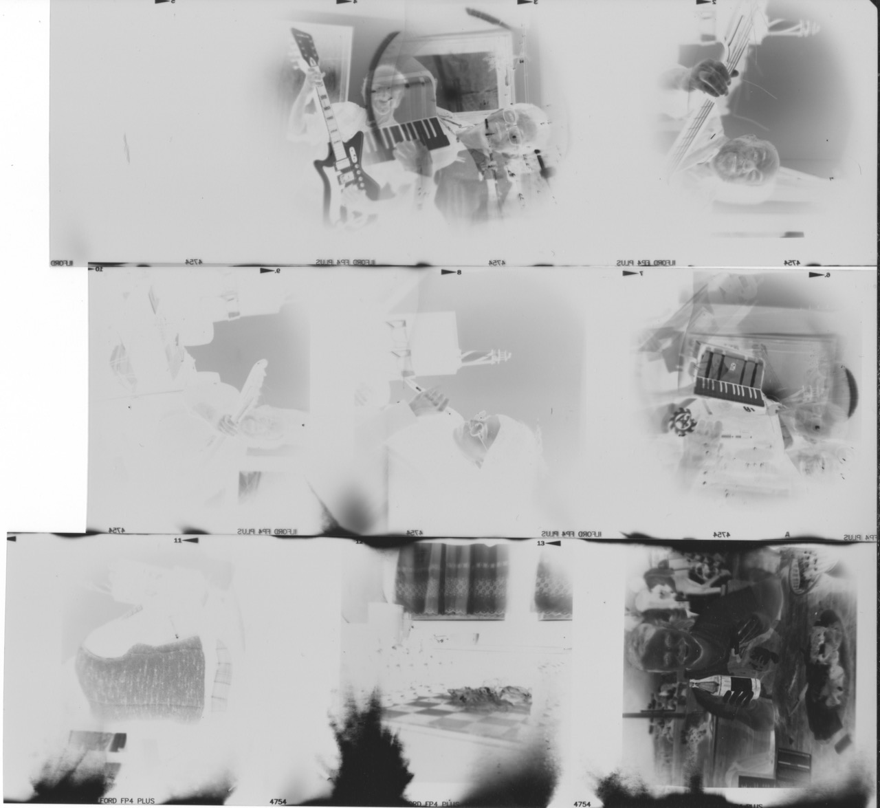

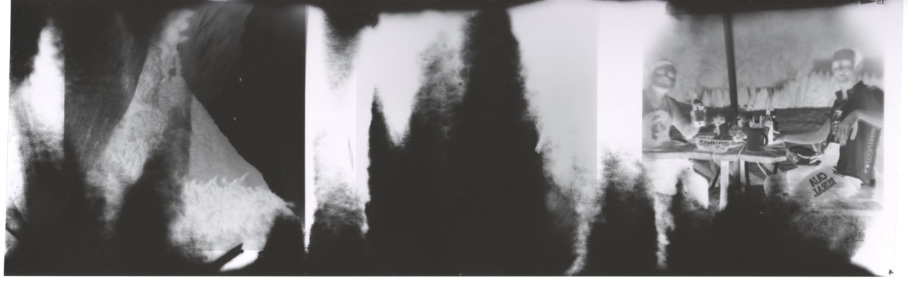

Hey Guys,
So here is a picture of the negatives from up to down 1st pic until 12th, it's clear now (to me) that this light leak came at the end of the film so I'd guess it wasn't tight enough at the unloading part!
Thanks again for the help, it's much appreciated @koraks @Andrew O'Neill
Cheers!
Yes, the film partially unrolling itself while handling it seems like a fitting explanation. It takes some dexterity handling roll film. Keep in mind it's a very old concept that dates back far over a century. One of the reasons the 35mm cassette became popular was that it was easier to handle!
