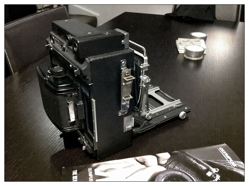

I have one for my crown graphic (Graflok back) that slides in where the focusing panel normally goes, the film plane remains the same. This one isn't mine, but this is how it goes: p303813700.jpg
It sounds like you're talking about a regular spring back though? The graflok is built so that the focusing panel with the GG and spring setup for film holders can snap out and other back types fit in.
The Tachihara does not have a Graflok back, therefore you cannot use a Graphic back as pictured above. Back when I had a Tachi, I had a Calumet 6x7 back and an older AAR 6x9 back. Both slide in under the ground glass just fine. The AAR backs take 620 film so are not the easiest to use. The Calumets take 120, are much easier to use. The 6x7 is fairly common, the 6x9 harder to find, the 6x12 real hard to find and may actually cost more than the camera.
