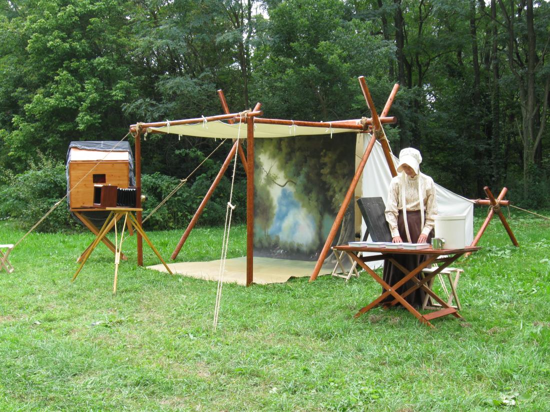

Although I am not a re-enactor I had to come up with a period correct setup for a couple of shoots I was commissioned to do. Here is a picture of my field studio with darkbox. This darkbox is designed to do up to a 12x20 plate. A little heavy but still workable. As most ULF shooters know, weight issues can be handled with a little ingenuity.I also have a ford cargo van ( the type with no rear windows) that I work out of most of the time. I built a bulkhead with a red plexi sliding door and an overhead vent with a sliding red plexi cover. Works like a charm and there is no set up time in the field. (there was a url link here which no longer exists)

But to get started in wet plate you don't need any of the stuff that I posted about above. You can go down to your local appliance store and get a dishwasher box or similar, a piece of red plexi or stained glass and a cloth shroud and some gaffers tape and you can make a darkbox that works as well as anything I have shown or mentioned.
