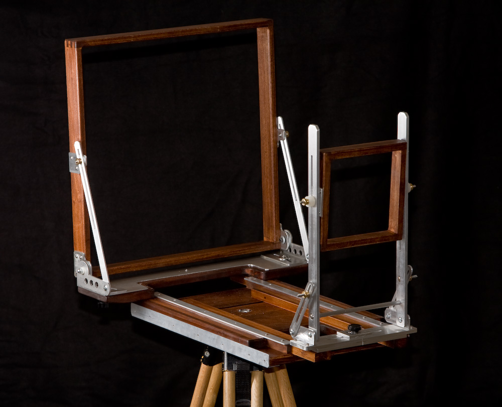

Goofey idea or interesting idea, genuis or just plain nuts?
Well, I've made a little progress. The bellows are almost on, I've picked up a couple of lenses, and the lens boards are ready to go. So now I'm starting to think about the backside.
Feel free to tell me if you think this is a stupid idea.
A few weeks ago I had a chance to play with an old wooden folder where the rotating back was held on by the four pins, and spring clips that slipped over the pins. I was impressed with how easily the back went on and off.
So I'm thinking, this is easier than inserting a film holder in a spring back. Here's the idea. No spring back, no traditional film holders. The ground glass just comes off after focusing. (I'm planing on some sort of Plexiglas for breakage issues.)
Then build a few double sided film holders that attach to the same pins that hold on the ground glass frame. I've got an idea in my head that should be rather easy to do. The film holders are basically 16 1/2 inches square, with magnetic masks to hold the film in place. They could be used to hold any size sheet film, with just a mask change. I should be able to almost hold 14x17, with 11x14 being the intended size. And they should be easier to load than standard holders. They would be a touch thicker, and of course larger than standard holders.
So what do you all think?

I like the idea of multiple formats. Yes that sounds really interesting. I'd love to see some bellows pictures and a description of your approach.
I'm at the stage were you were when you posted the picture. I have a bellows and back to do.

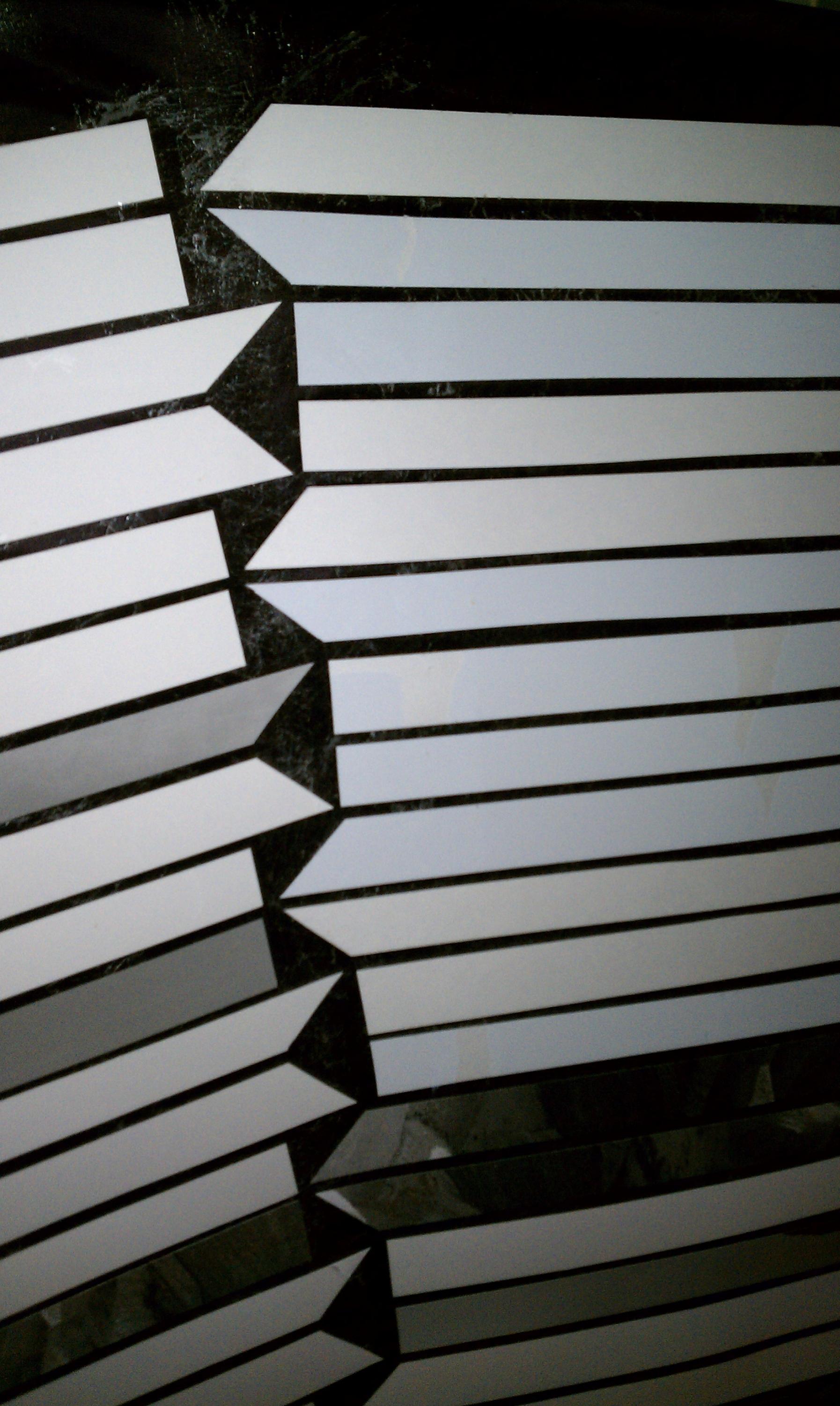

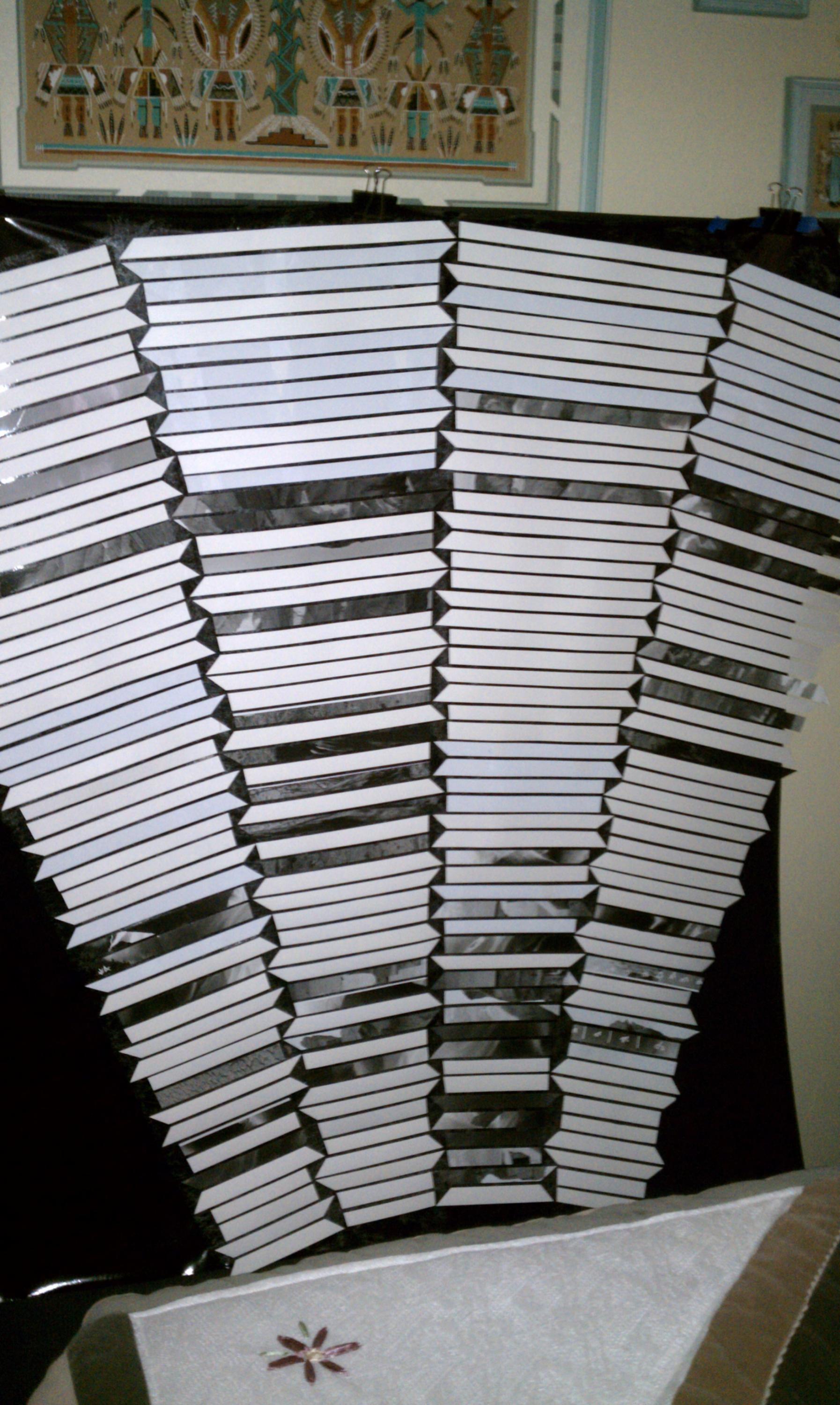

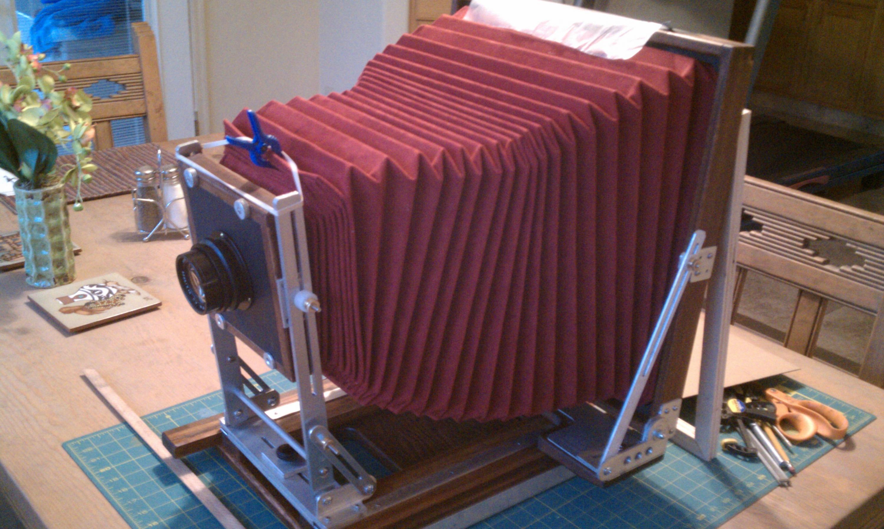

Here are a couple of shots I took with my phone. Don't expect much. I just wanted them for a reference, should I need them later.
What I did;
The ones that look like abstracts are after the ribs were glued to the liner. I used a .012 thick fabric I found at JoAnn fabrics. It was black with a shiny vinyl coating, it was also almost light tight. The ribs were just photo paper, Ilford rc I think. For the exterior I used a very dense fake suede material, it was something like .009 thick. Both of the layers sealed the light tight deal just fine.
What I did wrong;
If I were going to do this again, I would use a little thicker rib material. I was worried that with all the folds the thing wouldn't fold up in the camera, so I was trying to keep everything as thin as possible. On paper it added up to something just under two inches. However with the taper in the bellows it folded into pretty much nothing, about an inch. The material I used on the outside, while (in my mind) looked good, it was a stretchy material. Didn't notice it when I purchased it, but it was a serious pain to glue the inner assy. to the outer skin. I'm not so sure I would have made the bellows so long either. My pattern just barley fit on 54" fabric. I will however be able to shoot fly teeth at 1:1.
The last picture is how it sits this morning. In all its glory, wax paper ground glass and all.
