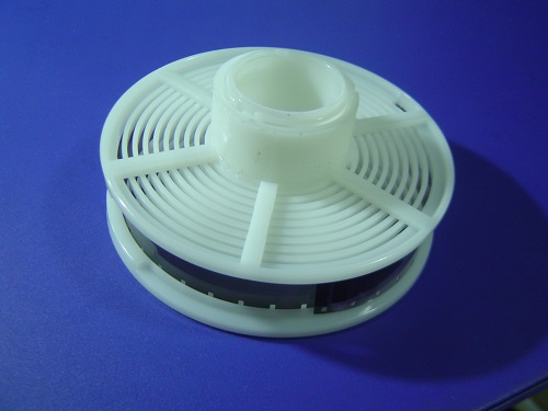

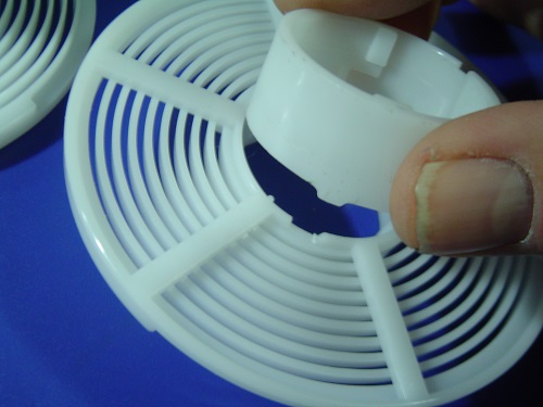

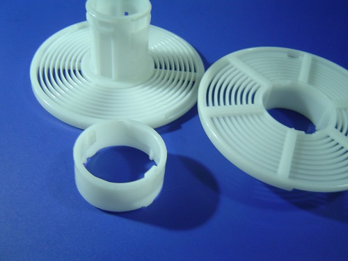

I know that this thread is a year old, but I just wanted to show off my recent modification to a Paterson reel to make it ready to develop 110 / 16mm film.
I followed the directions of the lomography link in post #3 above. You have to work slowly and carefully to make everything straight and even. You end up with three pieces: the reel top and bottom, and a locking ring.
I made one more modification while trimming down the locking ring the 2mm or so that you need to do to make it lock. I added two small tabs to it so the locking ring locks into the top spool. In this way you retain the ability of the spools to do the sliding back and forth for loading, but only move so much before they stop. Just like the original reel. I can't wait to try this all out. No glue, no mess or worry about it falling apart. Viva la experimentor!
