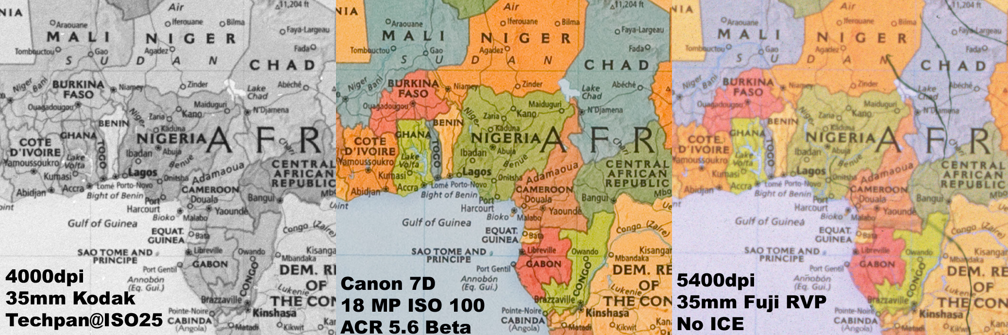

View attachment 204946 35 mm film holds up out to 18mp or so with fine grain film and good scans. 110 with good optics around 4 or 5
What scanner? You'll need to scan at much higher resolutions to avoid grain aliasing, even with Velvia.
Notice how the blue in the rivers is distinguished on film, where on digital it's interpolated out of existence.
