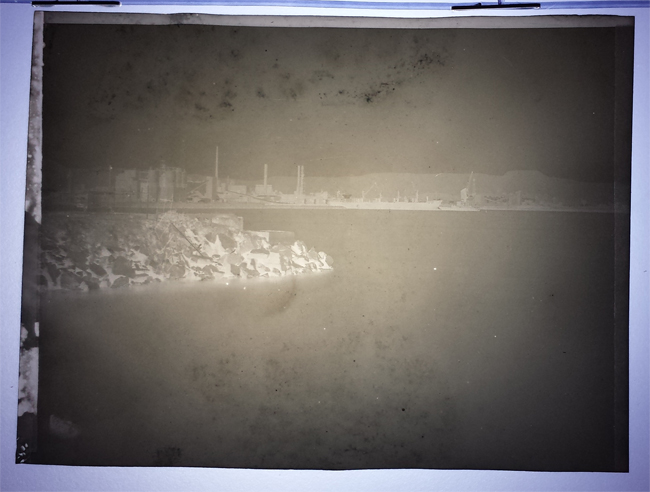

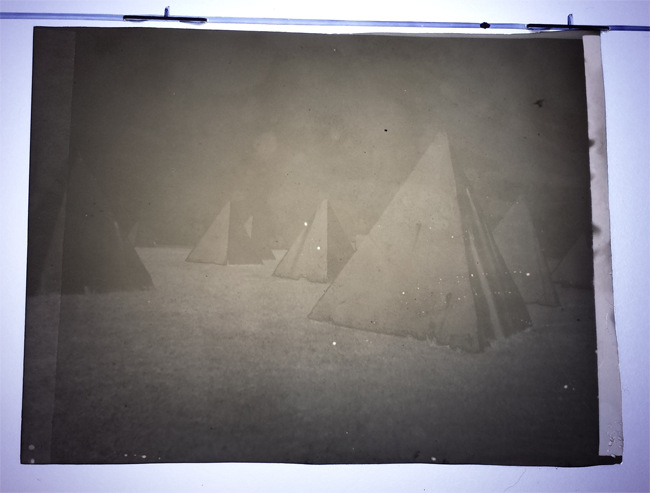

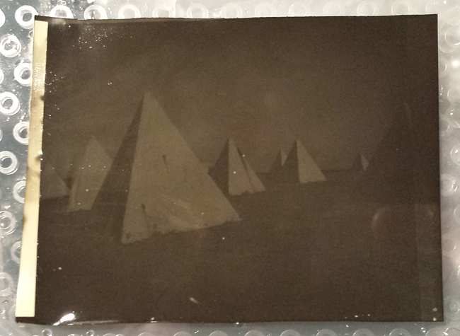

G'day all.
I recently got my hands on some an ultra vintage 6x9cm Kodak Premo Film Pack manufactured in 1912, expiration date 1st October 1913. I of course wanted to shoot this film seeing if it still works so under safe light I taped a sheet inside my 1920s Kodak Hawkeye 2A Model B 116 camera and having to guess how much to overexpose I made 30 sec at f-11 in sunny weather as a starting point and took a photograph of some WW2 anti-tank pyramids at Port Kembla Harbour. Under safe light I developed the film sheet in Caffenol C Delta for 11 min at 20 deg C and fixed for 5 min and was very happy to see the image form on this 102 year old film!!! Then I realized the film was solarized so that was way too much exposure but made a cool solarize effect on that exposure! A few days later I shot my 2nd exposure, this time at f-16 for 15 sec photographing Port Kembla Harbour. I developed for 10 min and fixed for 5 min and got a very nice negative without solarization so I was really pleased!!!:D There was some deterioration to the emulsion showing sooty black spots but otherwise the film worked extremely well for being over a century old!!! Below are a couple of snaps of the exposures I did and those who want to see the scans of them on Flickr here is the link to the album https://www.flickr.com/photos/51853869@N08/sets/72157647424096839/ . I am now at a point that I am confident I can make any film from the 1910s to the 1930s work using exposure time of 10-15 sec in sunny weather at f-16 aperture, I seem to get consistent results using such exposure times with the films I've shot from those eras! :smile:

A bit of an update on my 1913 Premo film, I came to realization my fixer was pretty much shot as I was noticing my negatives lately were looking quite dense after fixing so I decided to mix some new fixer and refix my dense films including those two exposures from the film pack and the films now look even better with far less fuzzy grain on scanning. My new scans of this film can be seen on Flickr via the links:
https://www.flickr.com/photos/51853869@N08/15556991722/
https://www.flickr.com/photos/51853869@N08/15370005358/
And here below are some snaps of the negatives themselves over my DIY light box
